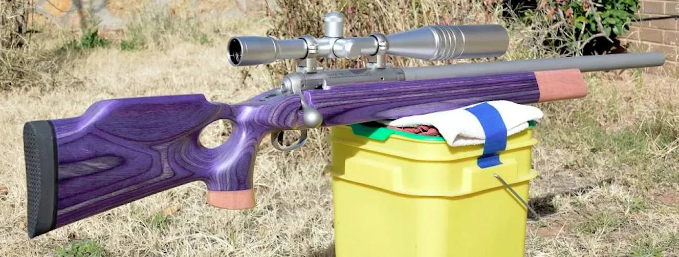

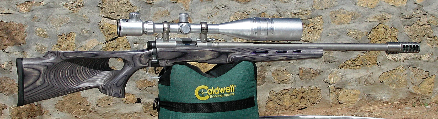

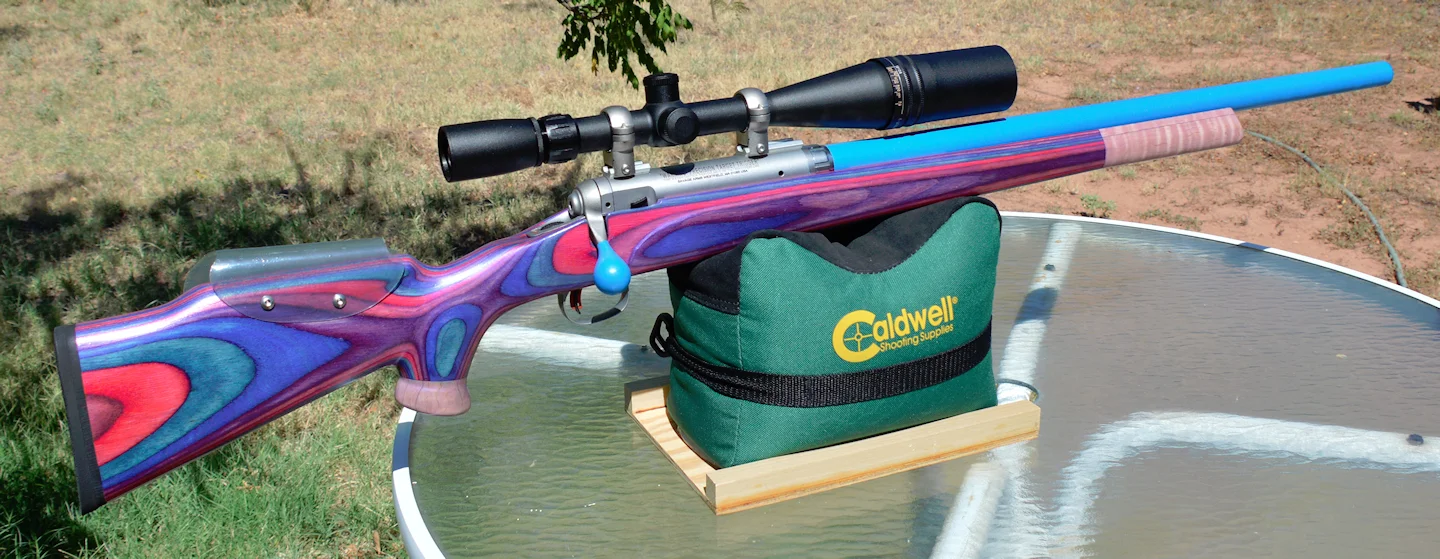

I have One Bought, Two - My Builds on Savage Target Actions.
17 WSM B-Mag (purchased)
6.5 Creedmoor (built with 28″ McGowen barrel)
204 Ruger (built with 26″ McGowen barrel)

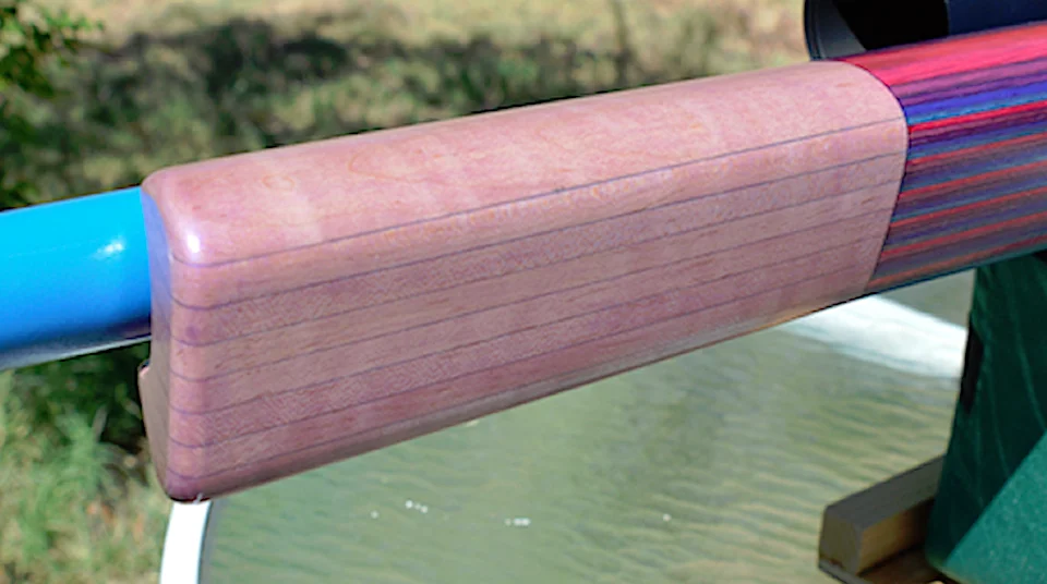

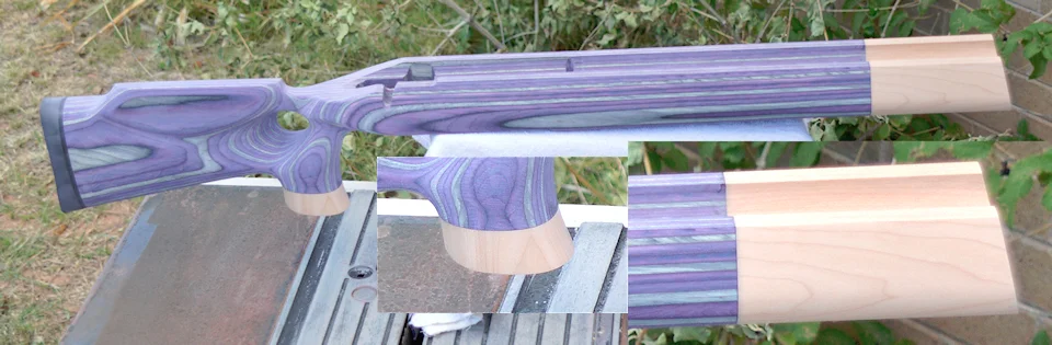

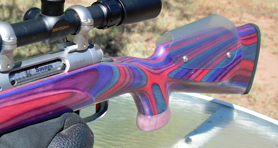

@hdskip – see pics & a little write-up. The fore end on the 6.5 Creedmoor stock is 3 1/2″ wide. I sourced the solid maple from an online source that caters to folks that turn bowls & such on wood lathes. They furnish pics of each piece available & the price.The fancier, the more pricey! (I opted for cheaper).
For the 204 Ruger, I utilized 4″ wide X 1/4″ thick maple cut to length that I needed. I coated the mating surfaces with epoxy resin tinted with blue pigment and let it cure before assembly. Applied the tinted resin again before clamping the pieces together to avoid squeezing most of the resin out, leaving attractive blue lines.
The cheek piece I fabbed from 4 oz. Fiberglass cloth. I placed wax paper over the comb of the stock, then applied 5 layers of cloth soaked with the afore mentioned blue tinted resin. Let cure, sand to shape, attach with stainless steel fasteners.
Barrel and Bolt Handle spray painted with Dupli Color High Temp Ceramic Engine Coating, works great, available at auto parts stores.

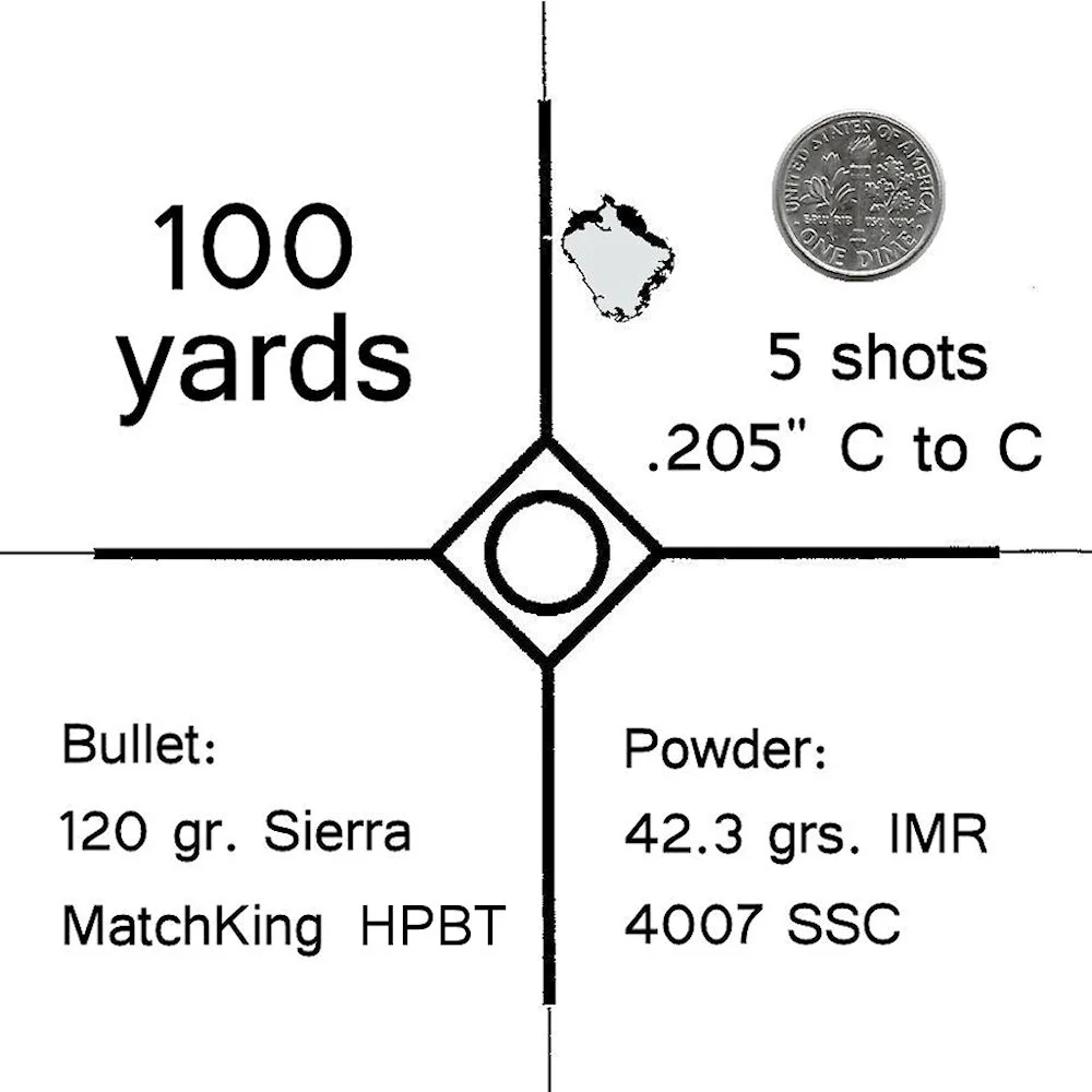

Here's a few targets from past excursions at the range.

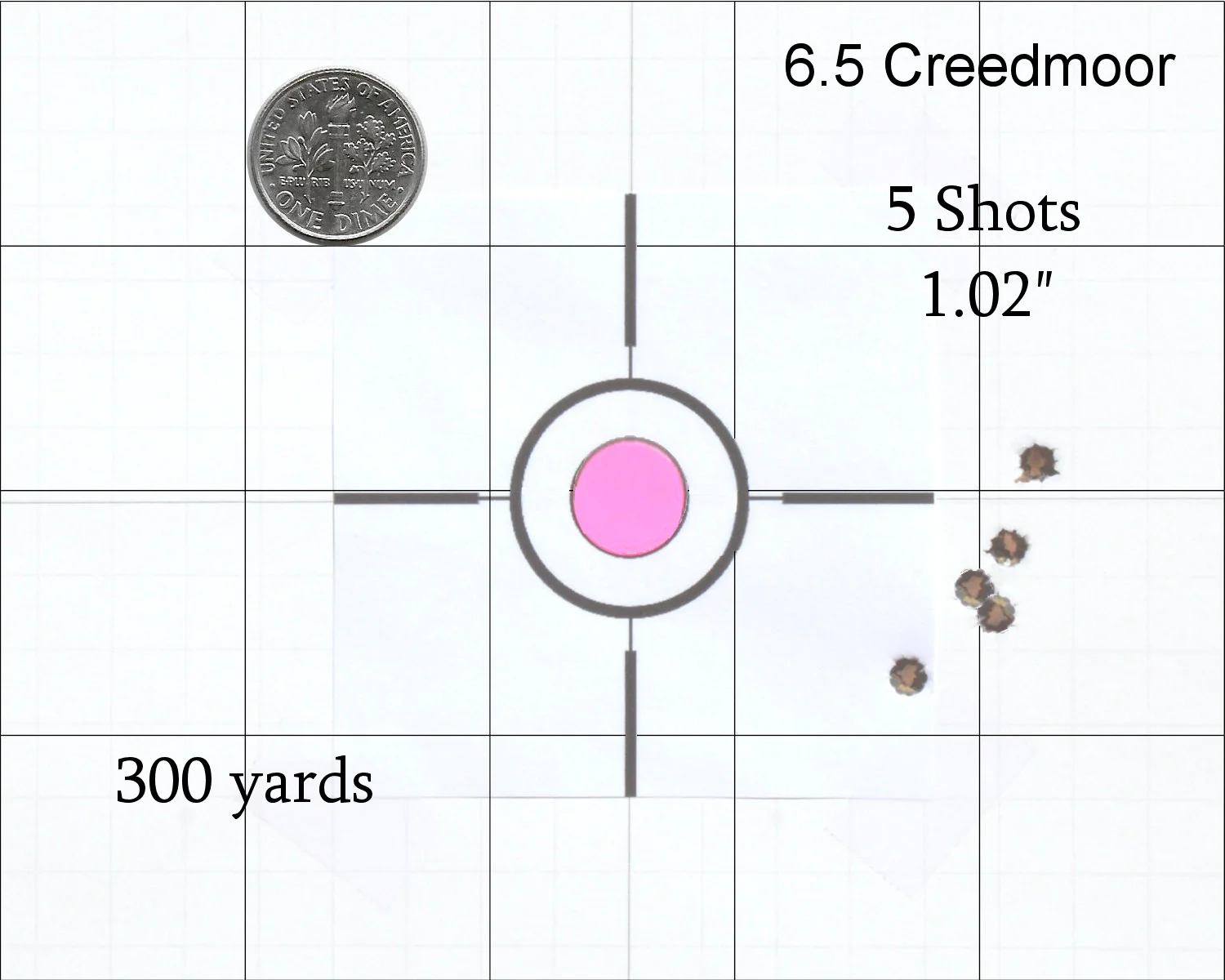

6.5 Creedmoor

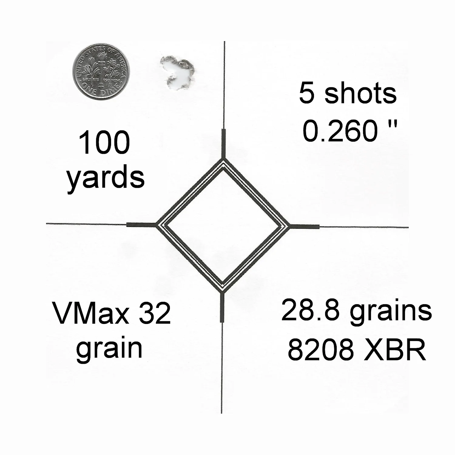

204 Ruger

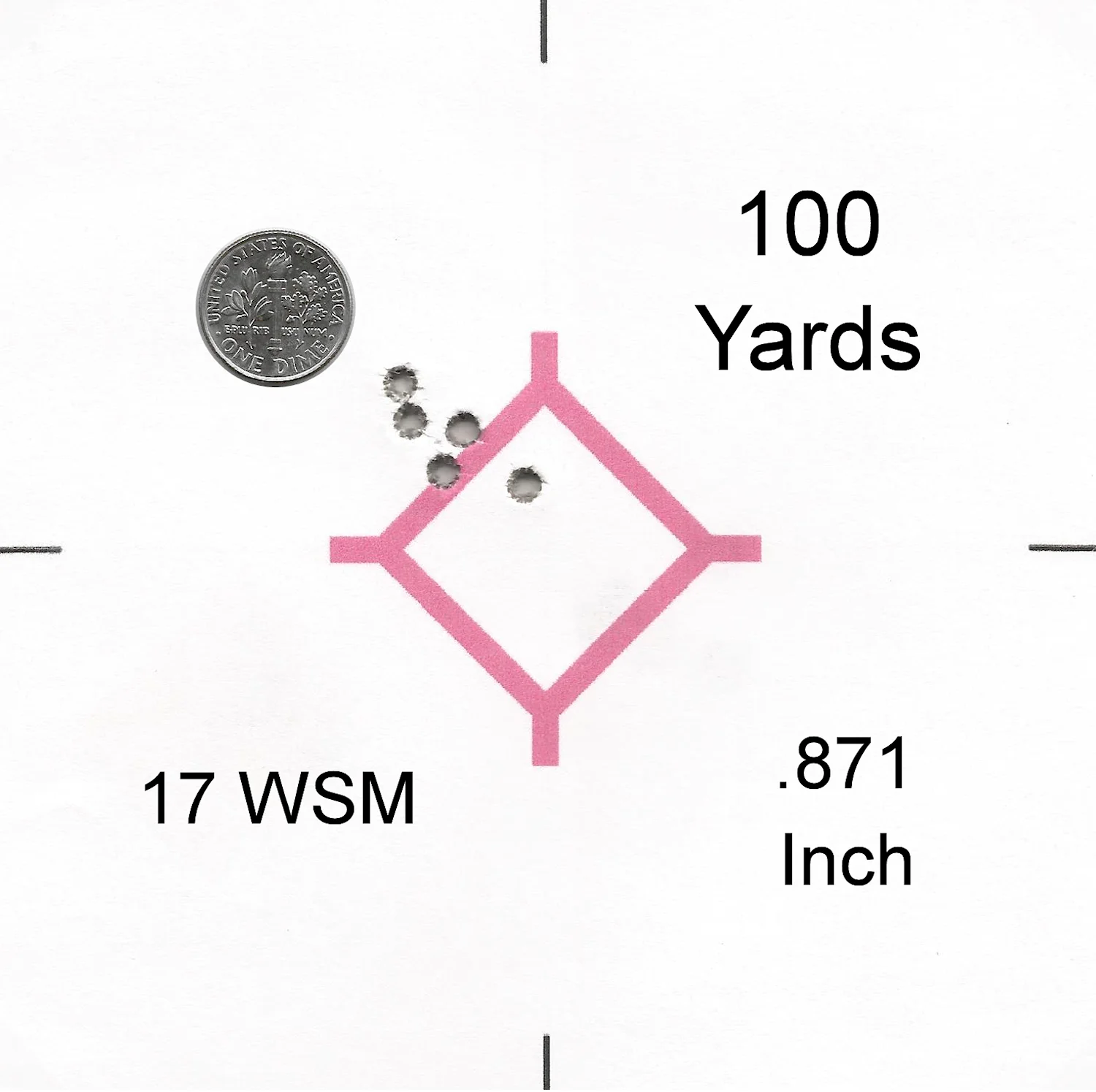

17 WSM

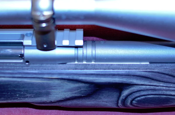

That was the best 5 shot group I have been able to shoot, despite epoxy bedding the stock (like I do with all my rifles). Problem is with PP consistency of available ammo!
B-Mag Epoxy Bedding

You are also correct about the 17WSM and ammo variations.
It is tough to get any rimfire ammo to really perform and 17 gr bullets tend to move around with even a breath of wind.

The stock on the B-Mag is the stock it was sold to me new from the dealer, so it's a "STOCK" stock. I tried to find my sales invoice, but no luck, so I don't actually know when I purchased it. I had to epoxy bed it to keep the barrel from flopping around!
