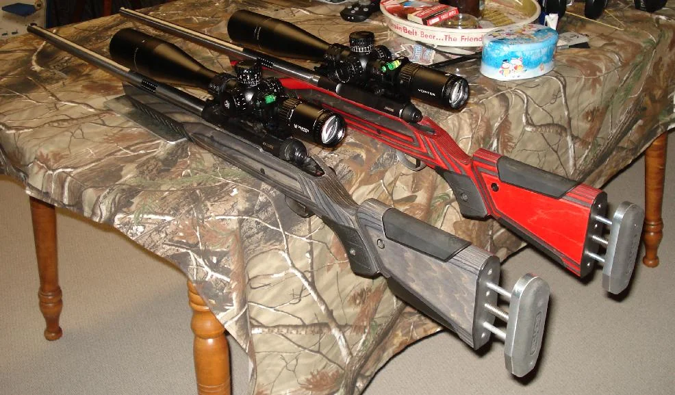

About 8 years ago I thought about getting into long range shooting. My goal was 600 and 1000 yds.
At my age back then (73) I wasn't sure if I could do it. I was looking at Tikka, Browning and Bergra rifles. Didnt want to spend $2-$3K for a gun and scope.
I was working a Gander Mountian in the gun department and someone brought in a Savage Model 12, chambered in 6.5CM. w/ heavy varmint barrel and a 12X Leopold scope for a trade in.
I bought the gun and the price was right. Reloaded some Hornady, 140 ELD's with H4350. Did my ladder testing and found a node at 2875 FPS. Swapped out the stock for a Boyd's AT-one, bedded and pillared the stock and put a Vortex,5-25 PST II.
Went to the 600 yd range and did my thing on steel at 350, 400, 450, 500, 550 and 600.
I was hooked and started down the rabbit hole. with the factory setup I was shooting 1/2 MOA at 600 yds.

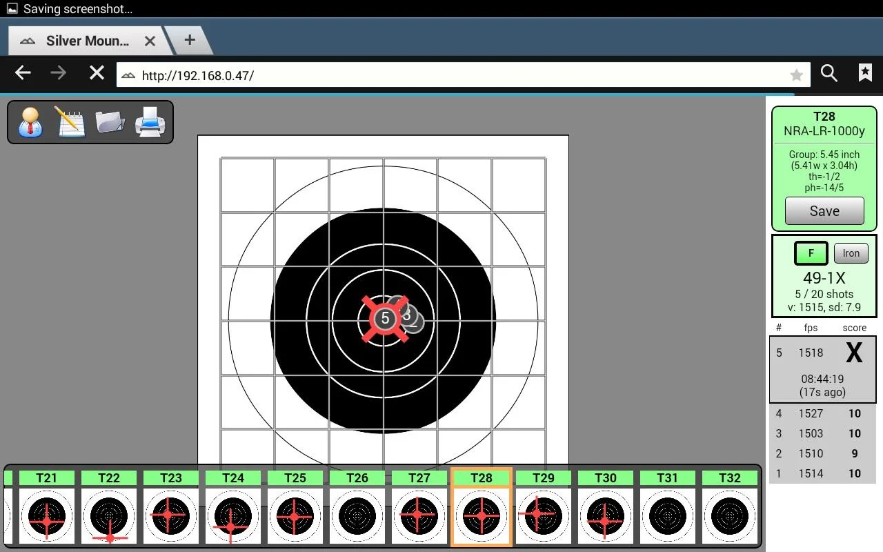

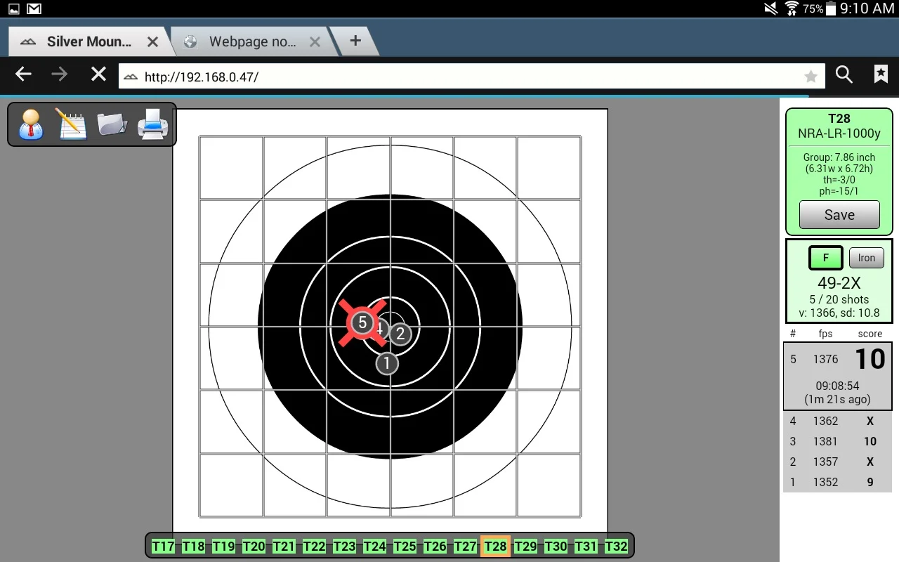

After shooting out the factory barrel I went to a Ragged hole pre fit barrel. I shot out 2 of them and ended up with a Brux barrel.
After some more load development I ended up getting 7" groups at 1000 yds.
My second gun was a shot out Axis in .308. Swapped the barrel for a 6mm CM Kriterion, Boyds stock and a Vortex 20-60 Golden Eagle.
Ended up shooting 5" groups at 1000 yds.
My 3'rd Savage is a 6mm BR, with a Savage Custom action a Palma stock and Crietrion. barrel. Still getting load date for this gun.
It has been a looong rabbit hole (and expensive too), but the fun of the testing to find the load and the node is satisfying.
I am glad I stuck with the Savage actions as they are easy to work on and swap out barrels when needed.
