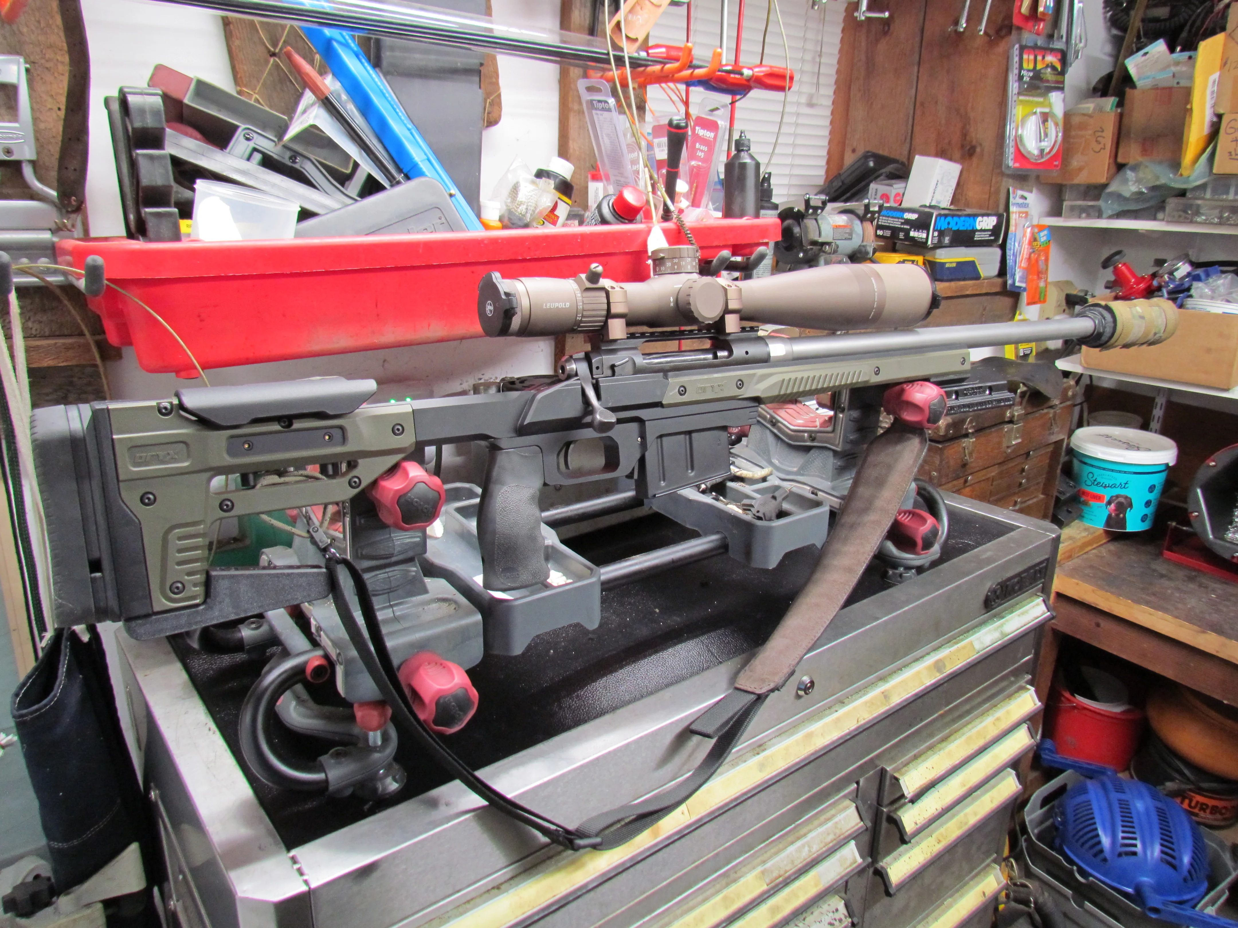

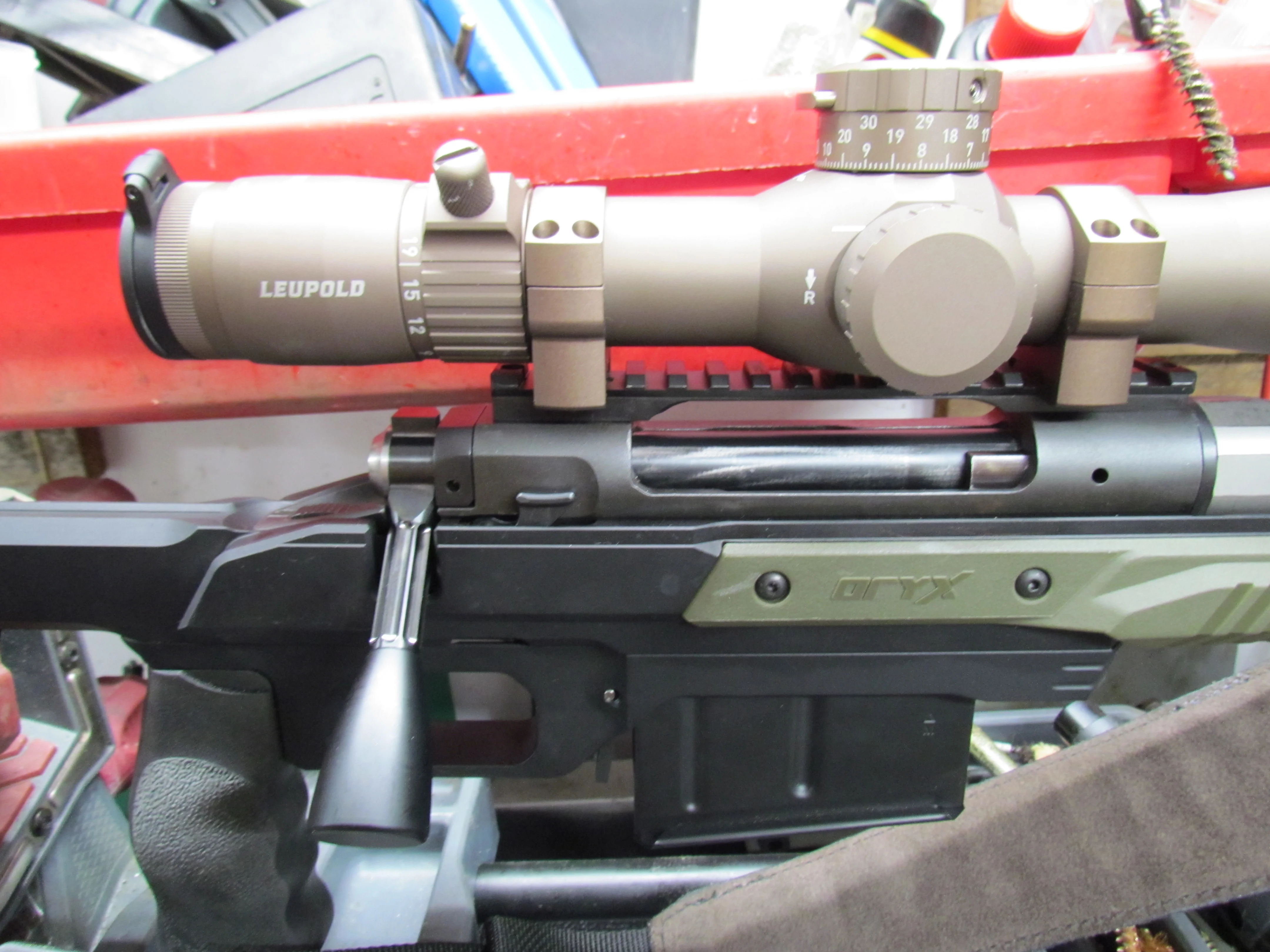

Been working on this rifle for 30 plus years and enjoying the whole thing. Latest photos. Whatta Hobby!
Very nice looking rig.
I see you fitted your Savage to an Oryx chassis.
I have four of my Savage 110s ( 2-308s, 1-6.5mm CM, and 1-.22-250 in Oryx Chassis, and 1- .223 in a MDT LSS).
They have all improved my group averages over the factory stocks.
I’ve shared a good bit of back & forth Tom Dobbie, the owner of Lumley. He’s an impressive machinist. I’m using the Lumley Titanium Bolt, Bolt Sleeve & BAS. My entire Bolt assembly is so light, it’s crazy! 😊 I also use the Bolt head components from them. I passed his contact info to leadership here. I do hope Lumley becomes a sponsor here. Along with Lance’s team at Gunshack. Those two are my go to’s for the basic DIY parts. Other small parts I machine myself. Usually from Titanium.

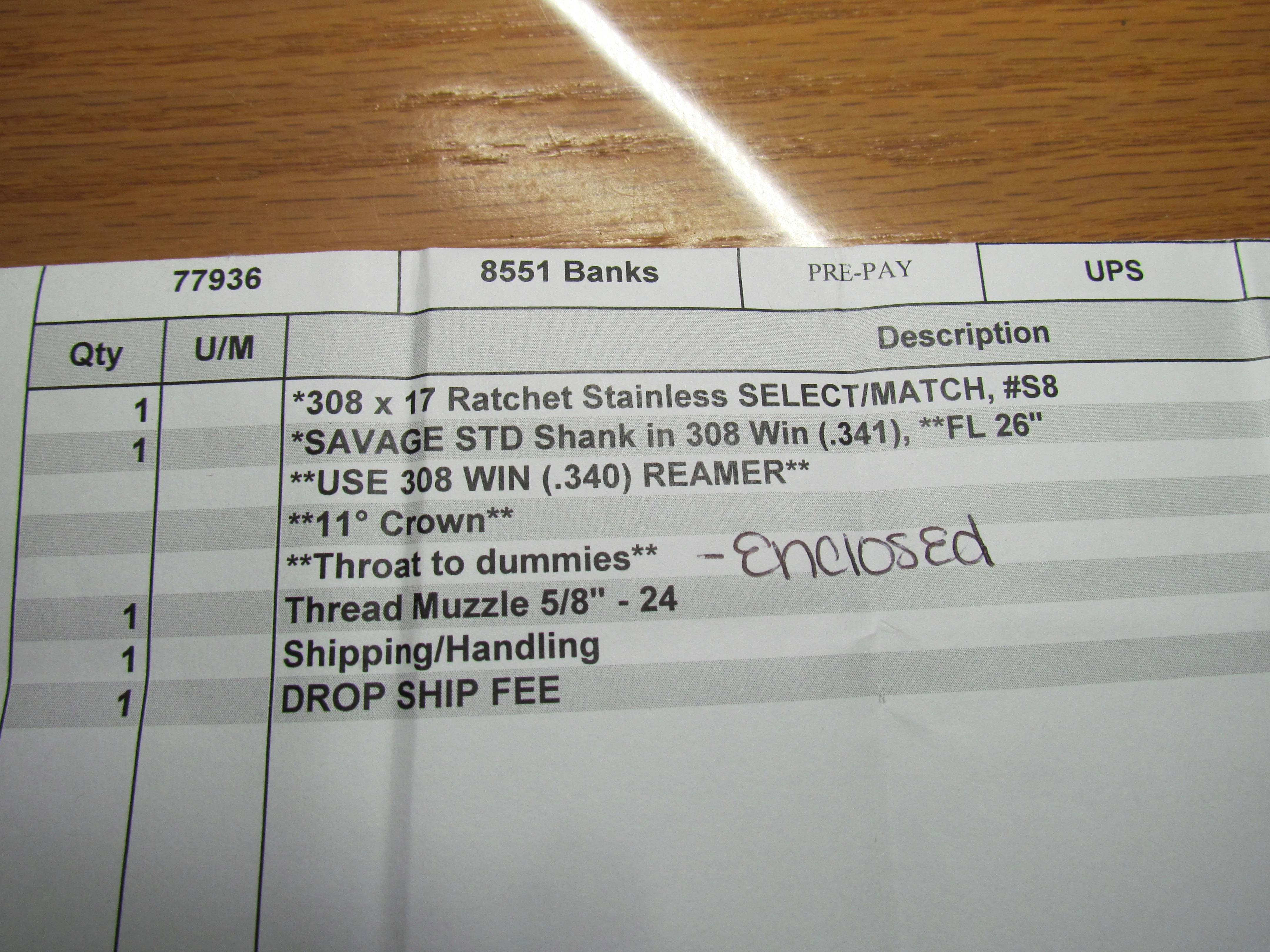

New Shilen barrel came in today for the Savage project I have been working on. Now have barrel for heavier bullets and this on for the lighter. Happy Camper. Whatta Hobby!

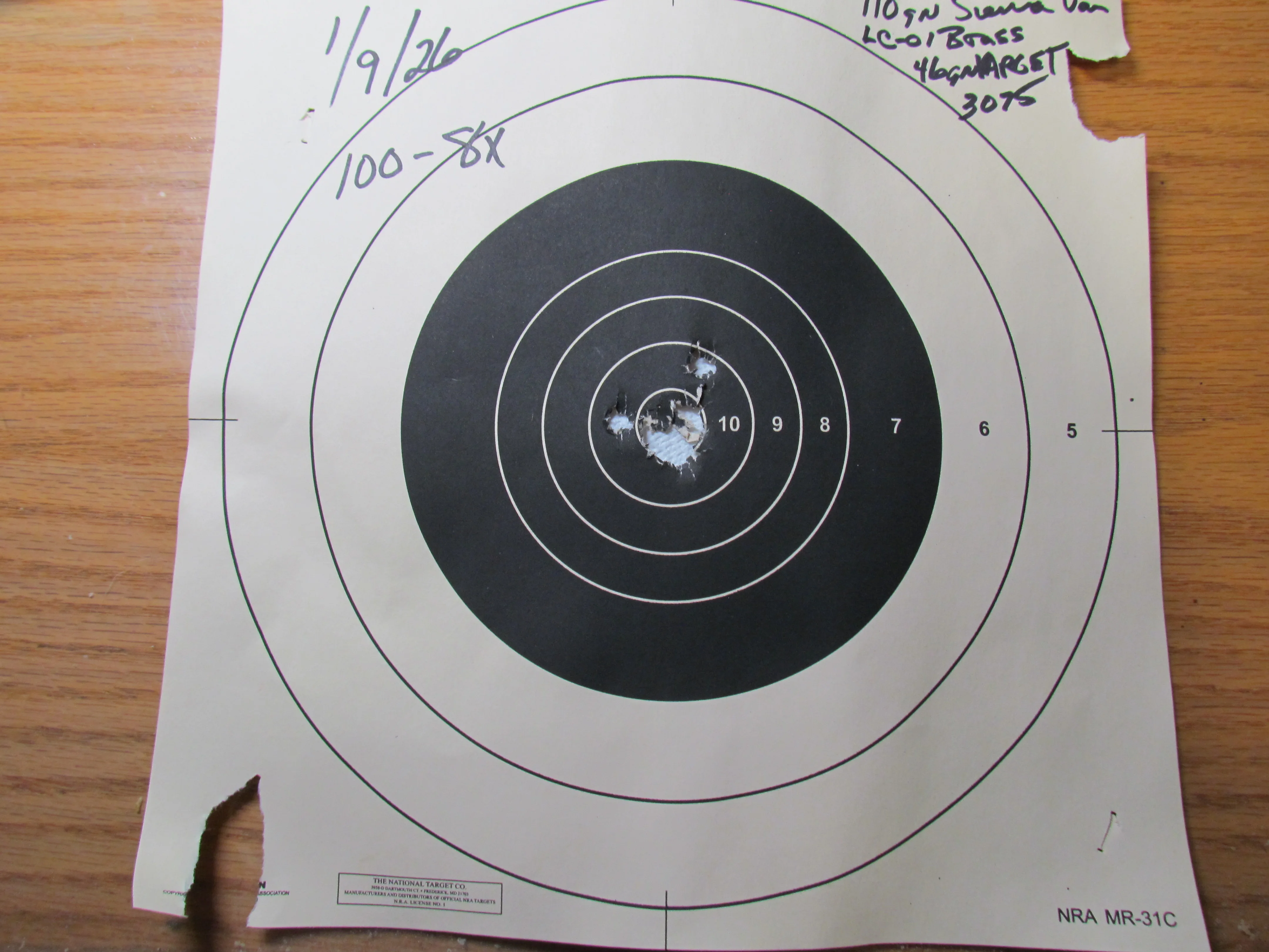

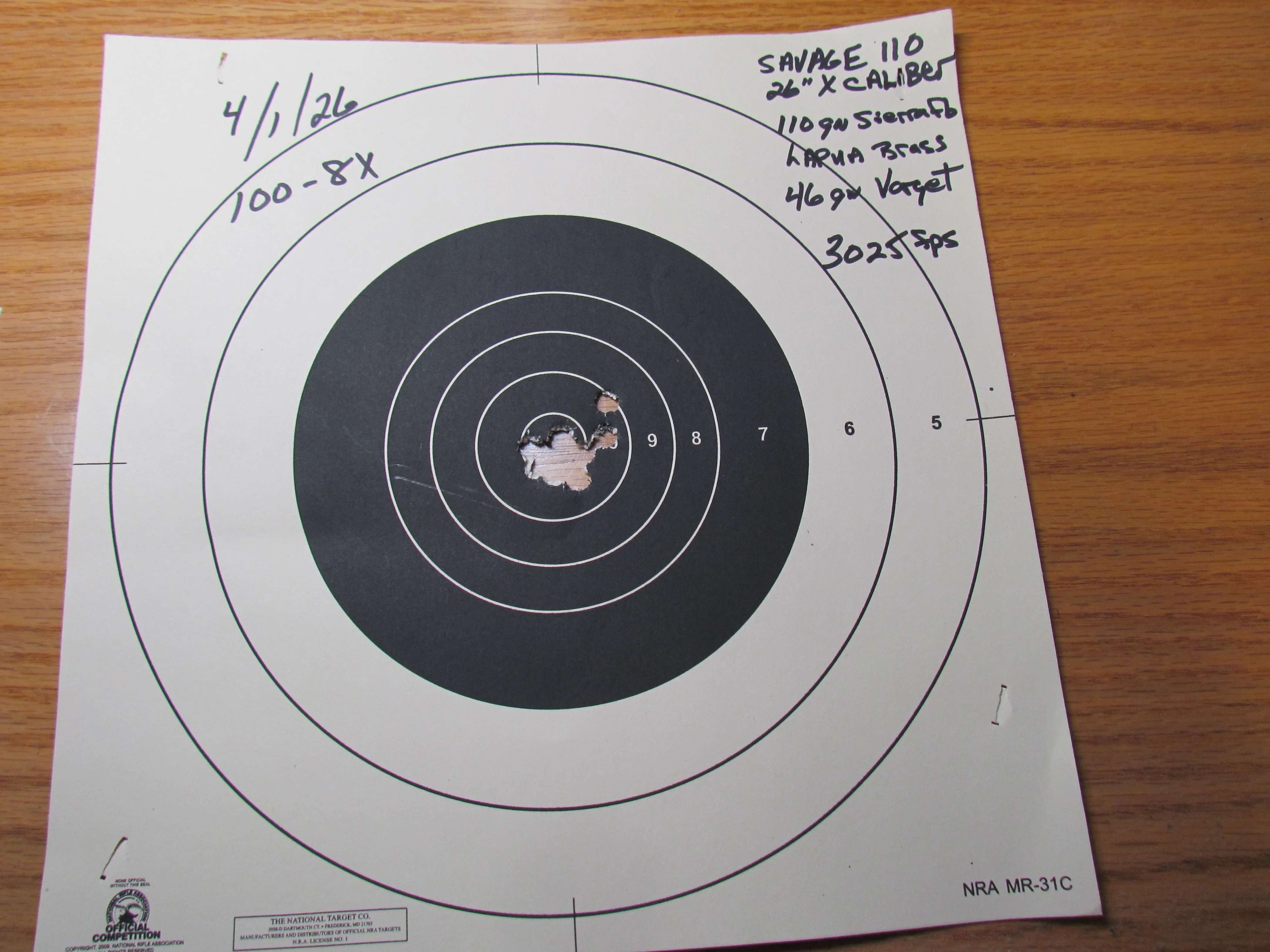

72 deg with a very light breeze. Had to start off the precision rifle for the April session. Savage 110 .308 in MDT chassis, X-caliber 26" 1/10 barrel. Scope is March Majesta. Ammo handloaded 110 Sierra in new Lapua brass over 46 gn of Varget. Shot off front rest and rear bag. Fire forming on new brass is a real Hoot. 100-8x. Whatta Hobby!
Thanks, next time out should be much more impressive. Whatta Hobby!

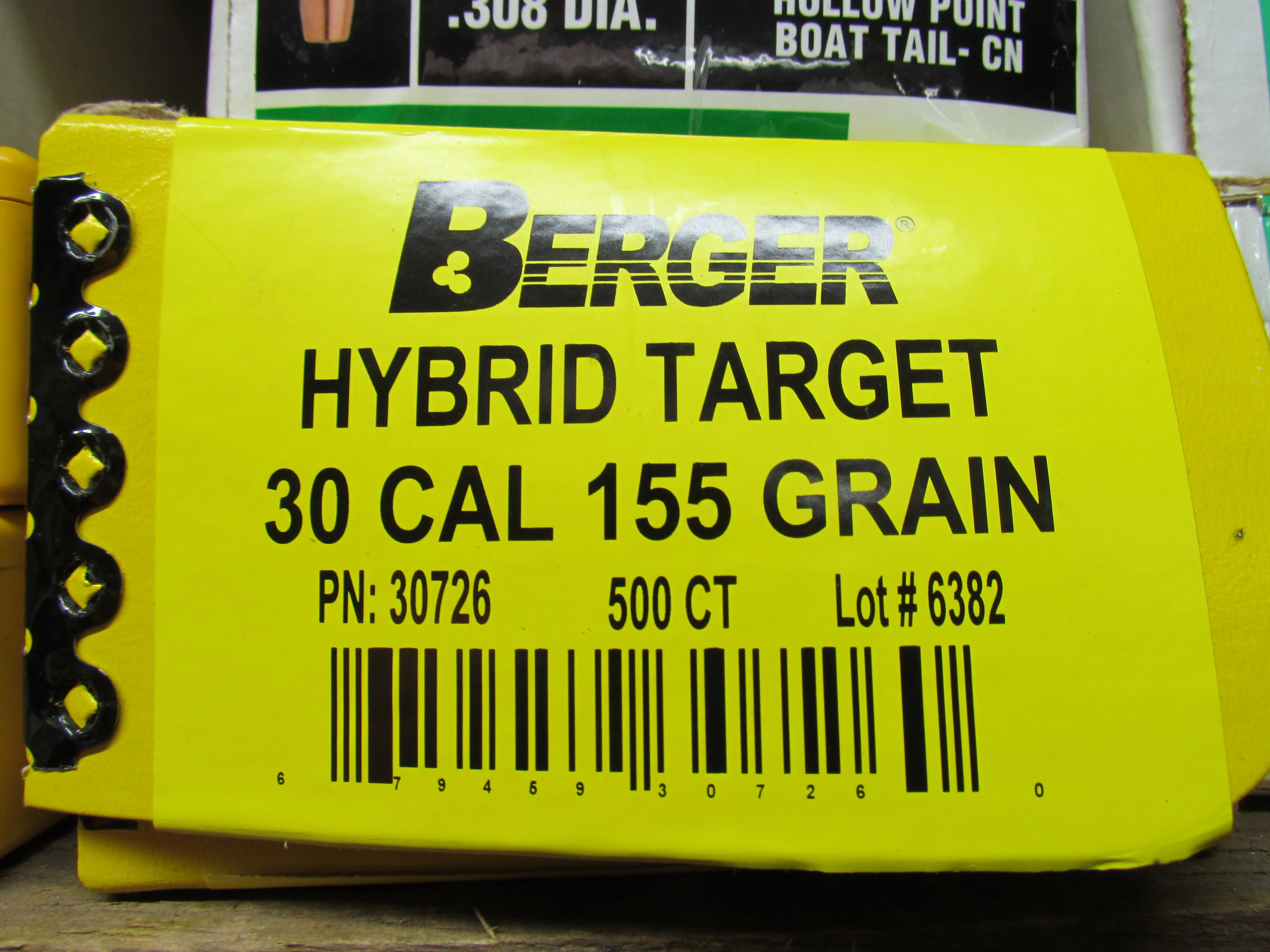

Try Berger 155gr VLDs and 43.gr VV140 set at .040 off the lands. Either Laupa or Remington brass, Fereral 210M primer. Shoots tiny one hole groups at 100yards and under 2.5 inches at 600yards. The Berger 155.5 Fullbore shoot just the same. Shot with Shilen 26" 1 in 12 twist. I believe the 1 in 10 will do the same thing.
Can't say I ever shot Berger bullets in any caliber that didn't shoot great.
A bit pricey, but worth it. if you are a nut for accuracy like I am.
I don't think they are pricey. Now Nosler ballistic tips are way more expensive than Berger's as they only have 50 in a box not a 100 when figure the price per 100.
