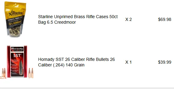

Speaking of 6.5mm. I have an order coming in for 6.5 CM. I have 120-123 and 129 grain on hand. I ordered some 140 grain. And new brass.
Which 140s do you find are most accurate?
