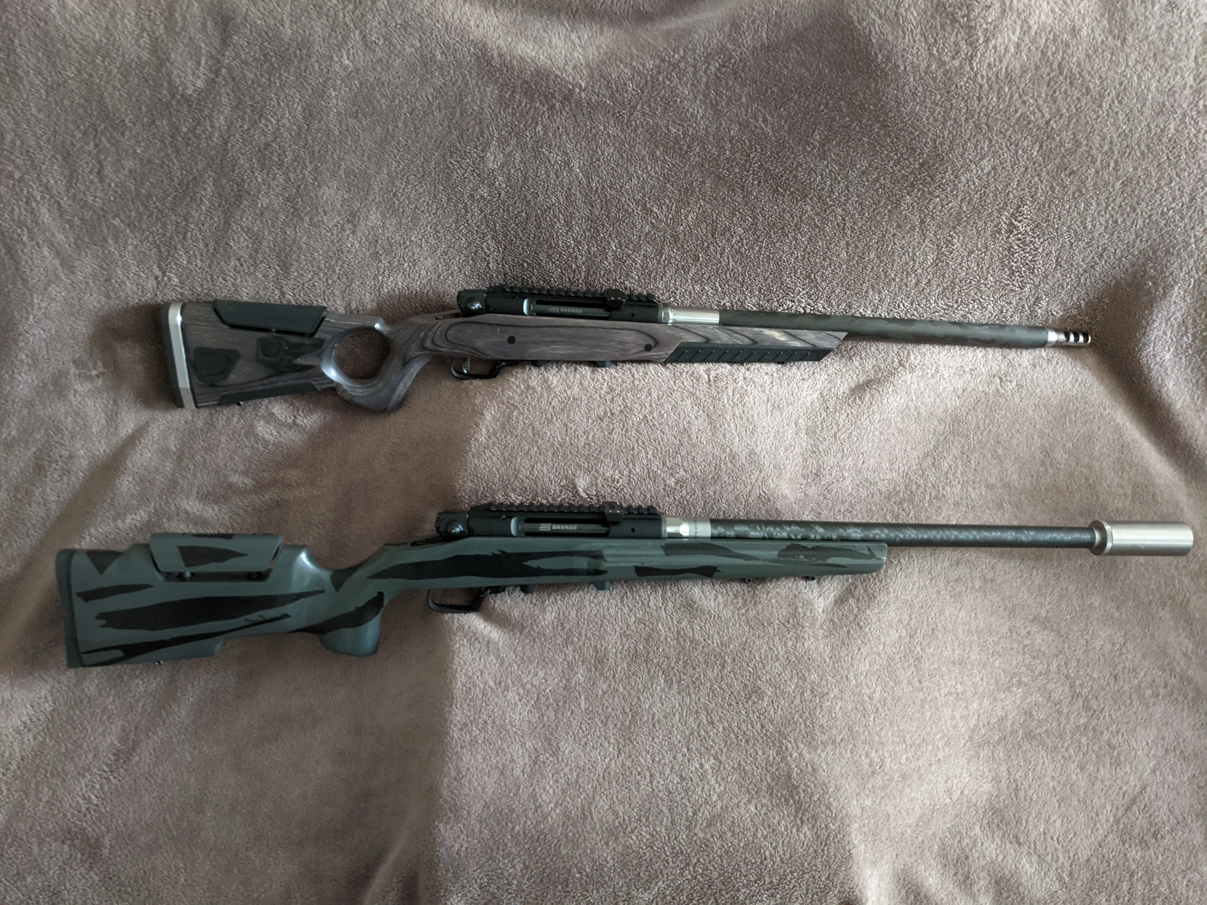

I also wanted to try another style stock for 2025, So I added a Boyds Pro varmint stock with Adj cheek piece.

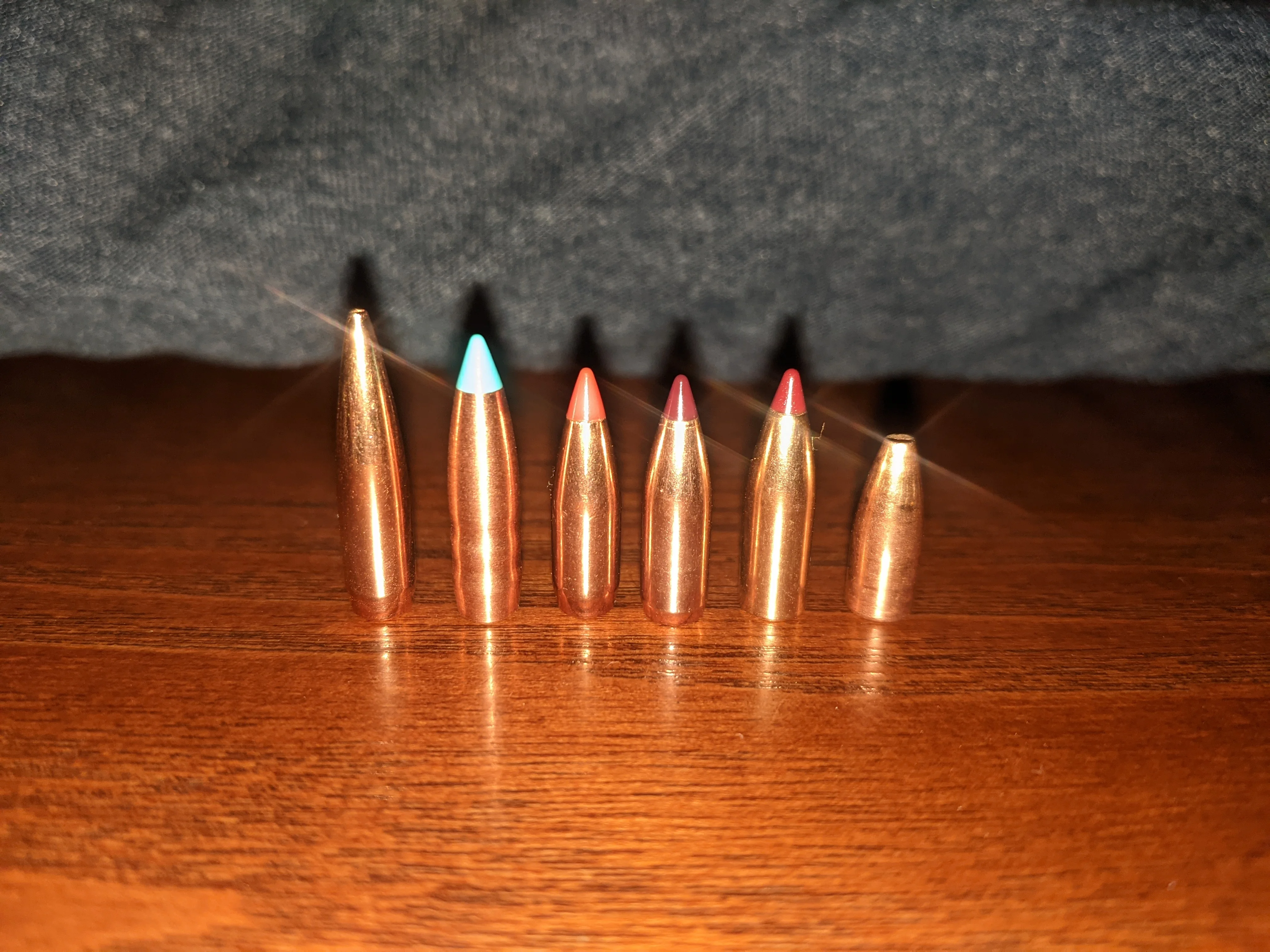

Did a lot of projo testing and settled on using the Hammer HHT .20 cal 40gr projos for 2025.
I added a rattle can nightshade tiger stripe pattern to the stock, sold the X50 and bought a Rix S60R 1280 res scope.
Here's a pic of my enhanced predator rifles ready for optic mounting before the 2025 season begins.
