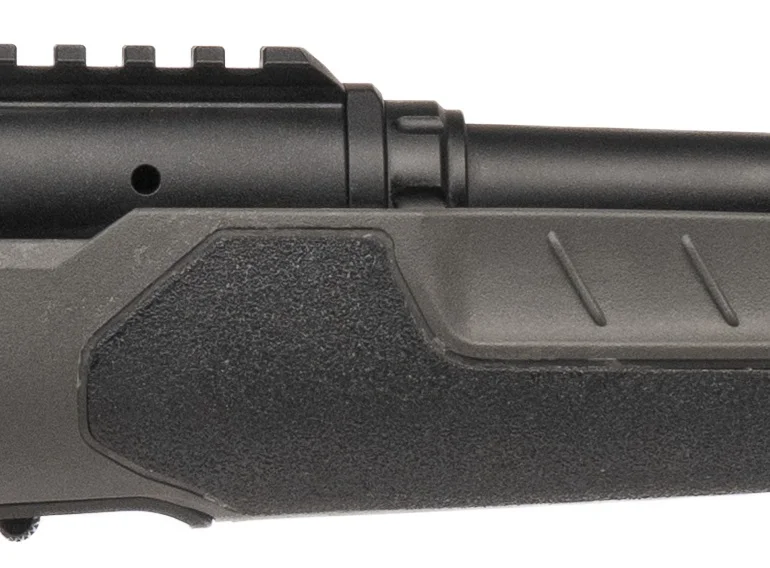

Just to ask something that might be obvious to someone else, but is there confirmation as to whether the Impulse is using the same barrel nut and recoil lug system as the 110 series? From the rimfire forum, Savage hasn't done the barrel nut design on everything, but this looks like a 110 style barrel nut and recoil lug, albeit the barrel nut looks shorter:
There's been concern of late, for good reason, with Savage changing designs on various things and breaking some of the modular compatibility. However, as a southpaw, if the Impulse is largely interchangeable with a wear component like a barrel, then it might be worth pulling one off the shelf the next time I am at the gun store and seeing how it feels.
Mr OP, how would you compare the Impulse action to a standard 110 when it came to field reliability? How does the feeding compare to a "controlled feed" sort of action?
It uses the same Large & Small Shank (edited correction, informed by shoots100’s post.) Barrel Nuts as the 110. However, I’m not certain on the Recoil Lug. The Impulse is not so much in my purview, as the Savage 110 & other Bolt Actions. I know enough, but have studied them as I have no care to own one.

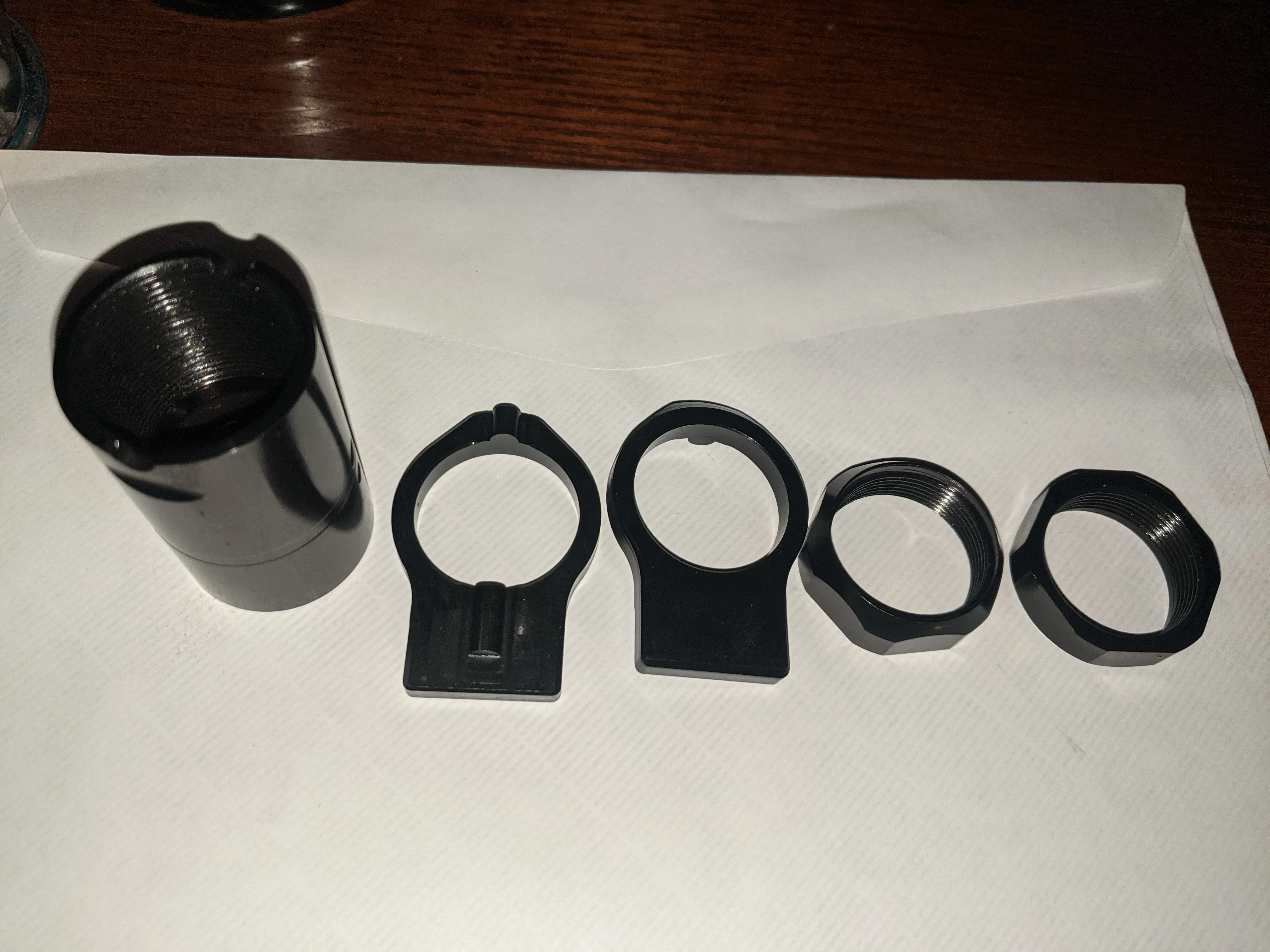

The Impulse uses small and large shank barrels and barrel nut's.
That's all the part's that can be used from a 110 model.
All of the Impulse barrel nut's are short and need a different tool to remove them.
If you use a longer aftermarket barrel nut, the stock will have to be hogged out to accommodate it.
I made the barrel nut's square on my QC barrel kit's for ease of use.
The recoil lug is fitted into the barrel extension for proper alignment of the gas blow off ports and crossbolt in the receiver.
A really great design.
