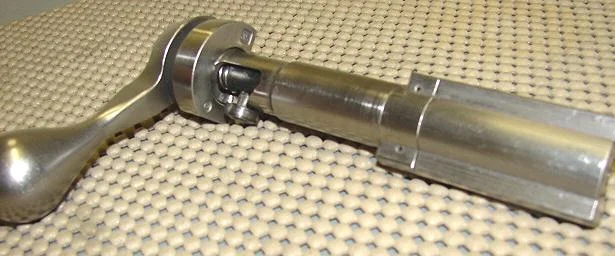

In the video, the Savage rep pointed to what looked like an adjustment feature on the bolt stem near the bolt handle and said it could be adjusted to lengthen the bolt movement so that when training with .22LRs, the shooter wouldn't be training to learn a short stroke. He didn't show any close ups so there is no way to tell how it is supposed to work.

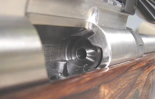

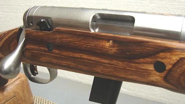

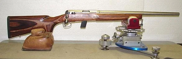

Rimfires work fine on a 110 based action. I know for a fact as I built the working prototype for that rifle 15 years ago.
