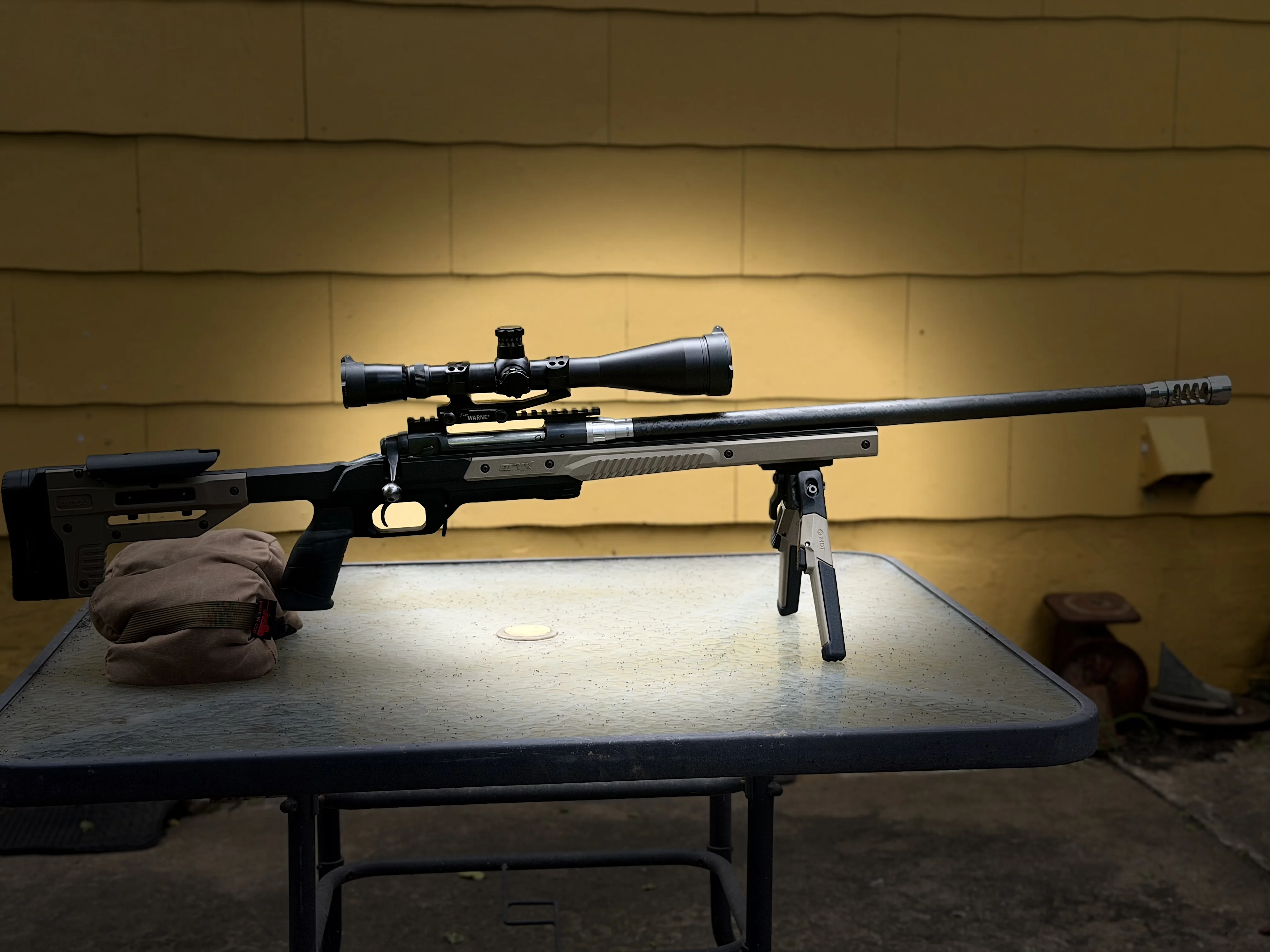

Well it has finally come together. 110 Series K, originally a 7mm Mag, is now a 7 PRC. Proof carbon fiber barrel, MDT Oryx chassis, an EC tuner break and an EGW 20 MOA rail.
The leupold 8.5-25 x 50 and Warne one piece base were in the safe so that’s what it’s got for an optic.
First impression is I like the gun but don’t like the recoil. From a folding plastic table, the best groups I got was between 3/4” and 1”. Can’t wait to shoot it from a concrete bench or prone to see if those groups improve. Also have a Banish 30 V2 suppressor in the works and that should help with the recoil.
* If you plan to mount a similar older 110 in an Oryx chassis, plan on modifying your magazine. It may have been wise to have a gunsmith open up the back of the action and I can always do that later if it is determined to not be a safety issue.
