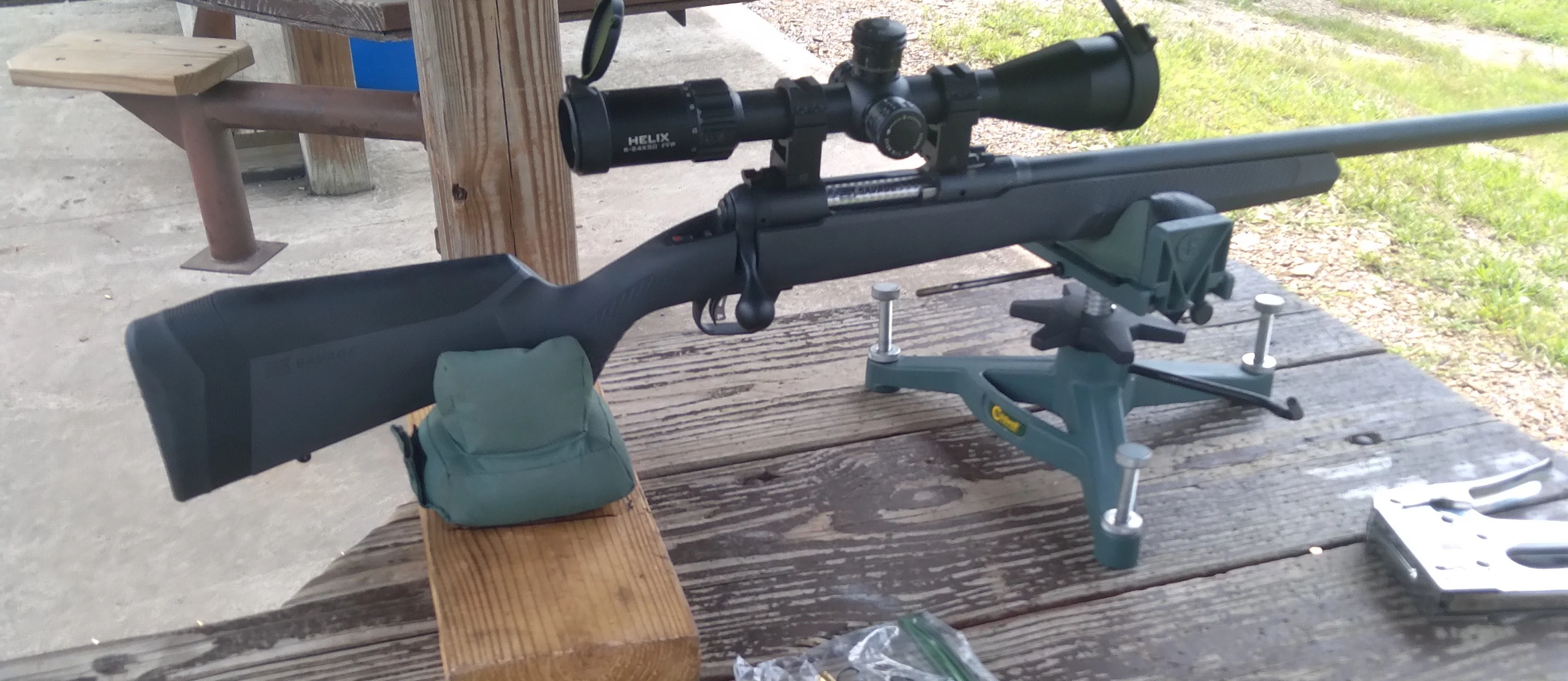

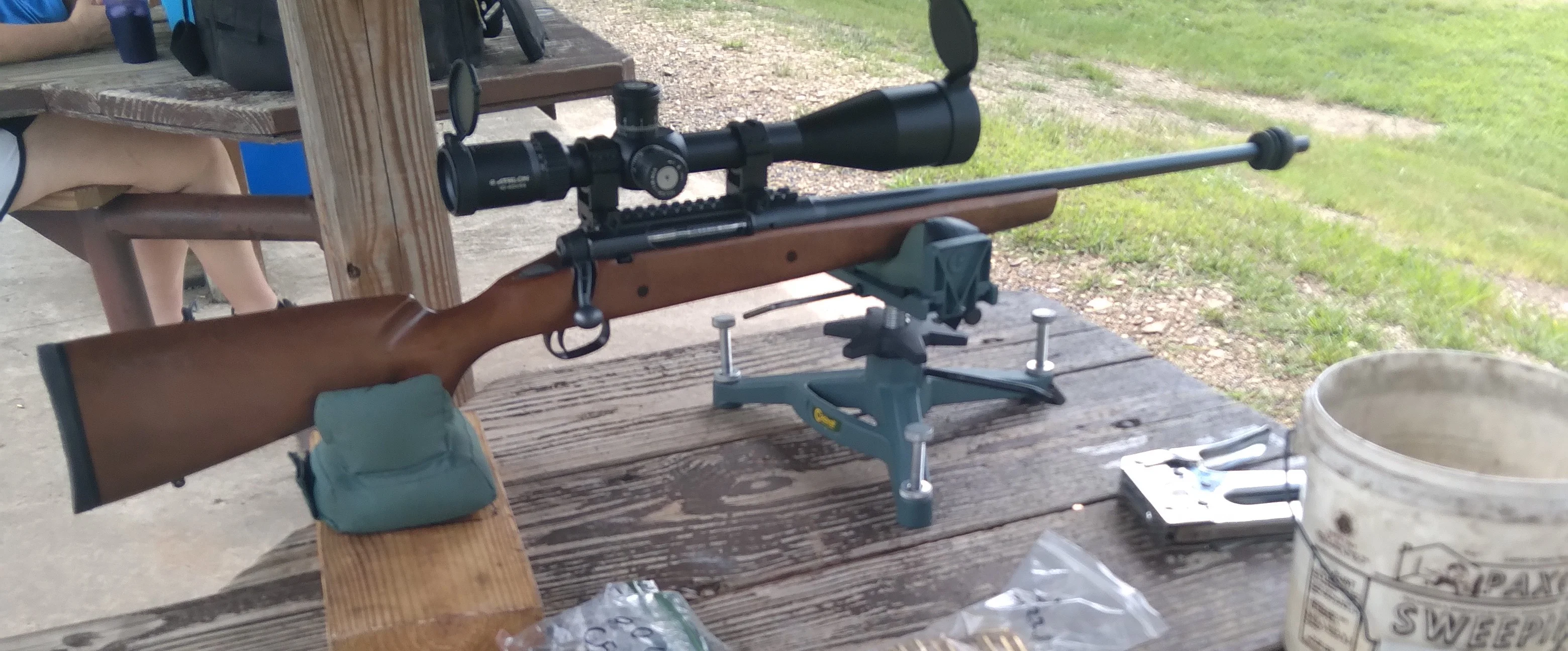

Please point out where the catch is. I have an Axis and 110 Varmint. Then i can look. Maybe these pics will help you?
