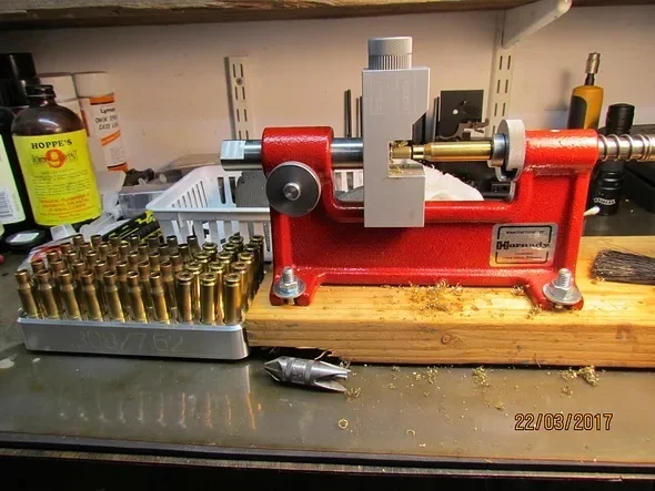

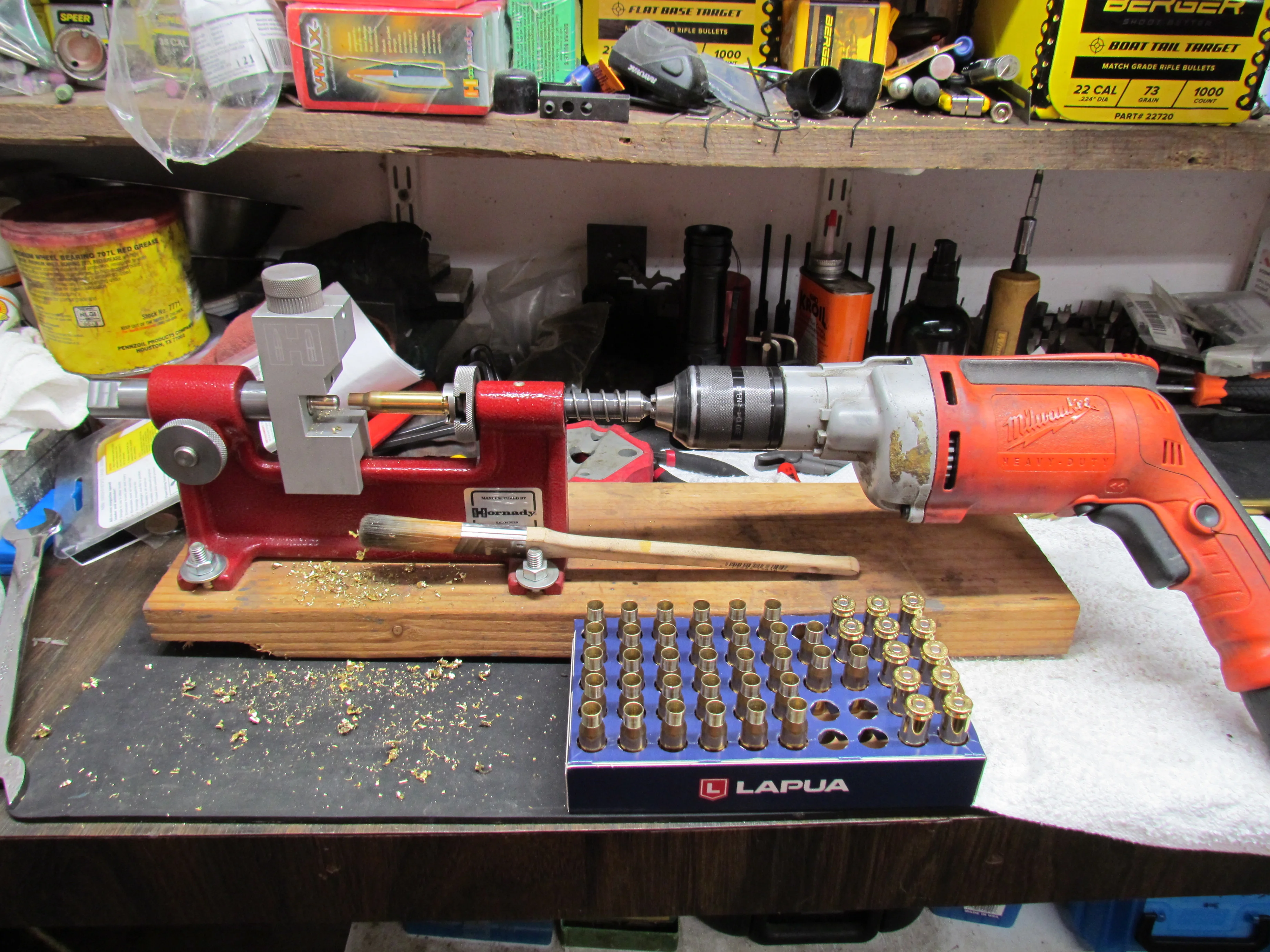

Doing some brass prep today myself. No tumbling being done until after 5 or 10 loadings. Brass .308 200 cases is Lapua that was neck turned for truing only then fire formed to the chamber. Today annealing, sizing neck and should bump to .001 and then trimming, setting neck tension with mandrel, primer pockets K&M uniformed. I do enjoy this stuff on a rainy day. When this is all set I will be loading 115gn Berger flat base target bullets over 46 gn of Varget set off with 205M primers. This is my sub 1/4 moa ammo. Has been running at 3025 fps out of a 26" X-Caliber SS 1-10 bull barrel. Whatta Hobby!
