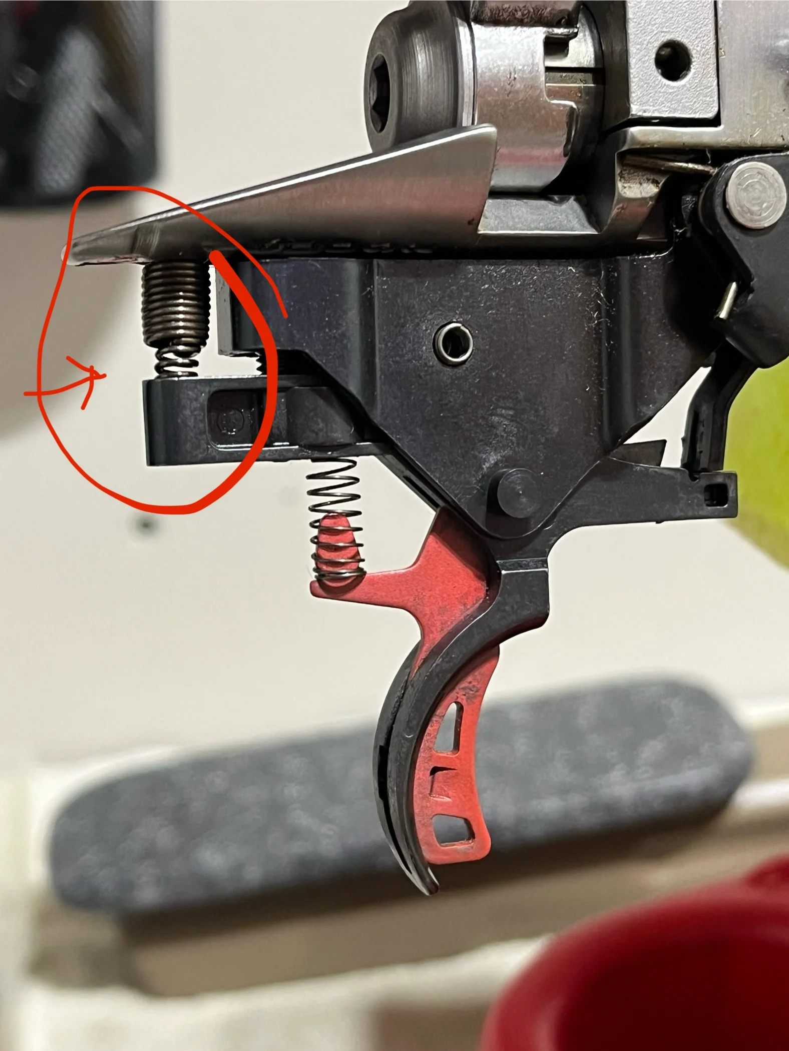

Have any of you ever worn out a sear? Like so much it pretty much loses adjustment capabilities? I just did.
So last fall I was in Wyoming shooting every prarie dog I could get in my scope. Gun is a savage dual port target action sporting a Criterion 6br barrel. Using stock target accutrigger. After about 200 or so rounds it all of a sudden started dropping the sear. I pulled it apart and added some pull weight to it till it would fire constantly, but the pull wt was now over 2 lbs! So I shot another 100 rounds or so with it the next day or so and then put it away.
When I got back home I swapped in a new target accutrigger assembly I had sitting here(the trigger assy sold by Gunshack). That made no change, which I expected. The lowest pull wt I could get was 1.5lbs but didn’t trust it. Then I swapped in a spare SAV1 trigger. Same result. I could easily set it to be safe but the pull wt was 1.5-2lbs. I did all this because Gunshack was sold out of their target sear. After that I put the gun away.
Fast forward to about 2 wks ago, Gunshack got the sear in stock so I ordered one. There was so much difference in the sear length that I had to back off the sav1 sear engagement about 2 turns! Reset it and Walla, right back to a tad less than a pound. Just where I like it.
I know the factory sear is filed to fit to get the light pull wt, so I expected a little difference. The target sears from Gunshack have not been filed so they will take a while to wear in.
I have shot a ton of rounds thru savage rifles and this is the first sear that I had to replace just cause it was worn out.
Here’s a pic of how far I had to adjust the rear spring just to get consistent safe firing with the bad sear! If I backed it off at all from this it would trip …lol crazy!
Wonder if that worn sear would turn a standard accutrigger into a 1lb trigger?…lol
