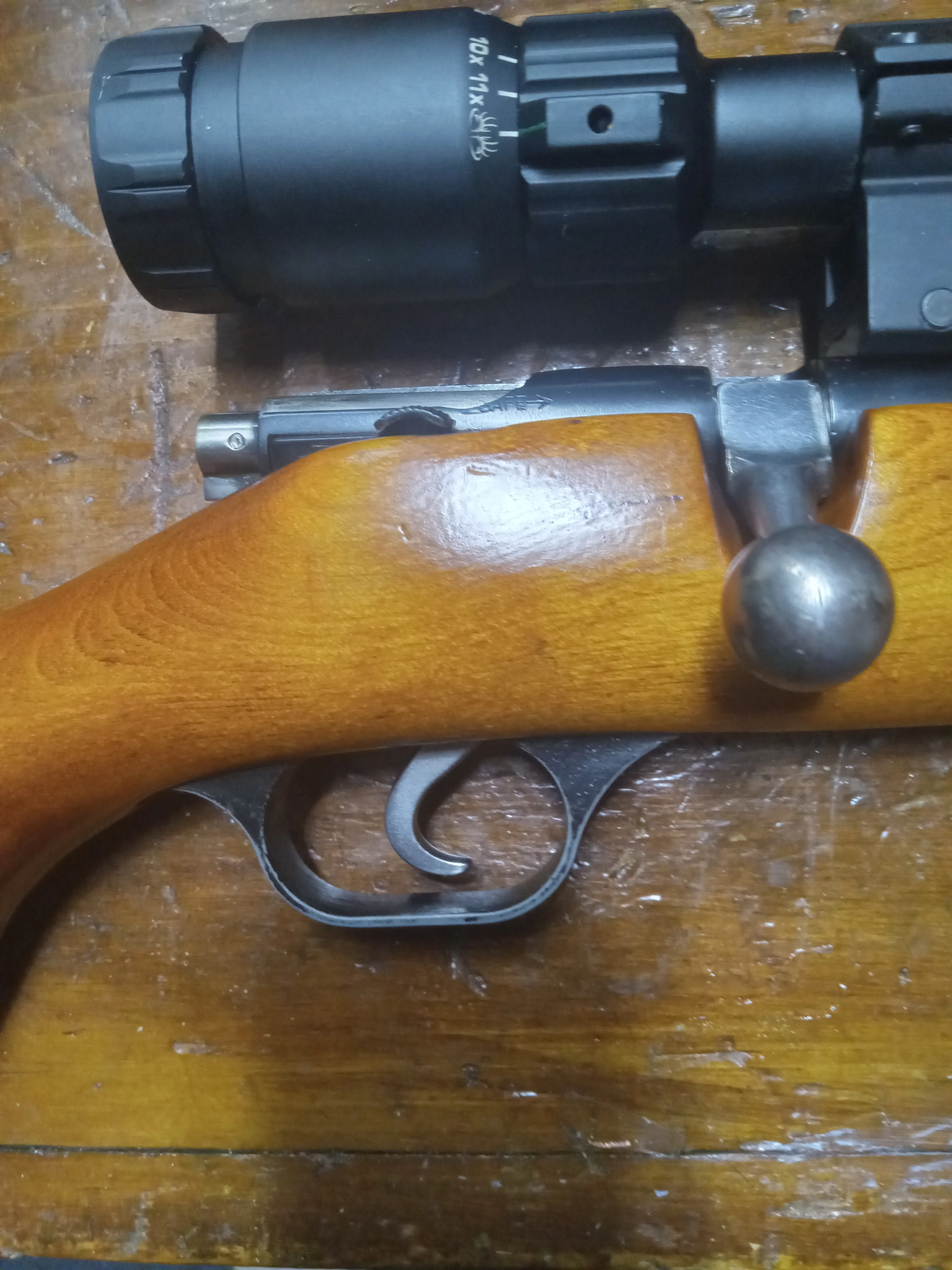

Steven 86C trigger shore replacement?
CoalCrackerAl
Jan 4, 2026
479
Coal TWP Pa.
Im looking for a trigger shoe. That does not have a really curved hook. I don't like the one that is on it.
Unfortunately, there are no aftermarket triggers for the 86. And the shape is far too extreme with limited room in the guard to allow a shoe over top. Your only recourse is to modify the existing trigger. It can be machine/ground some of the thickness and thin it out & reshape to less hook. Or, possibly heated & bent. Then also modified some for length. This is something I could easily do.
You can also find them modified from EBay. Can see with this one how much of the hook shape has been removed.
https://www.ebay.com/itm/267116328010
Still a good bit of hook, but much less than before modified.
