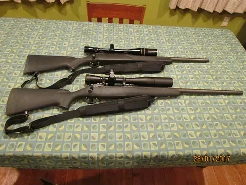

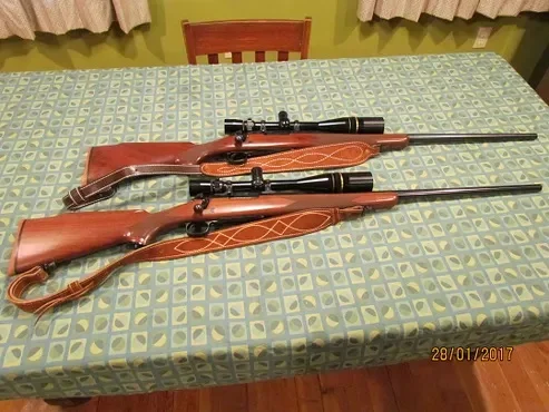

Both of these 110 FPs in lower photo are long action as purchased in the 90s. One is .308 and the other .223. They have gone through some extensive changes as the years go by since this photo was taken. Whatta Hobby!

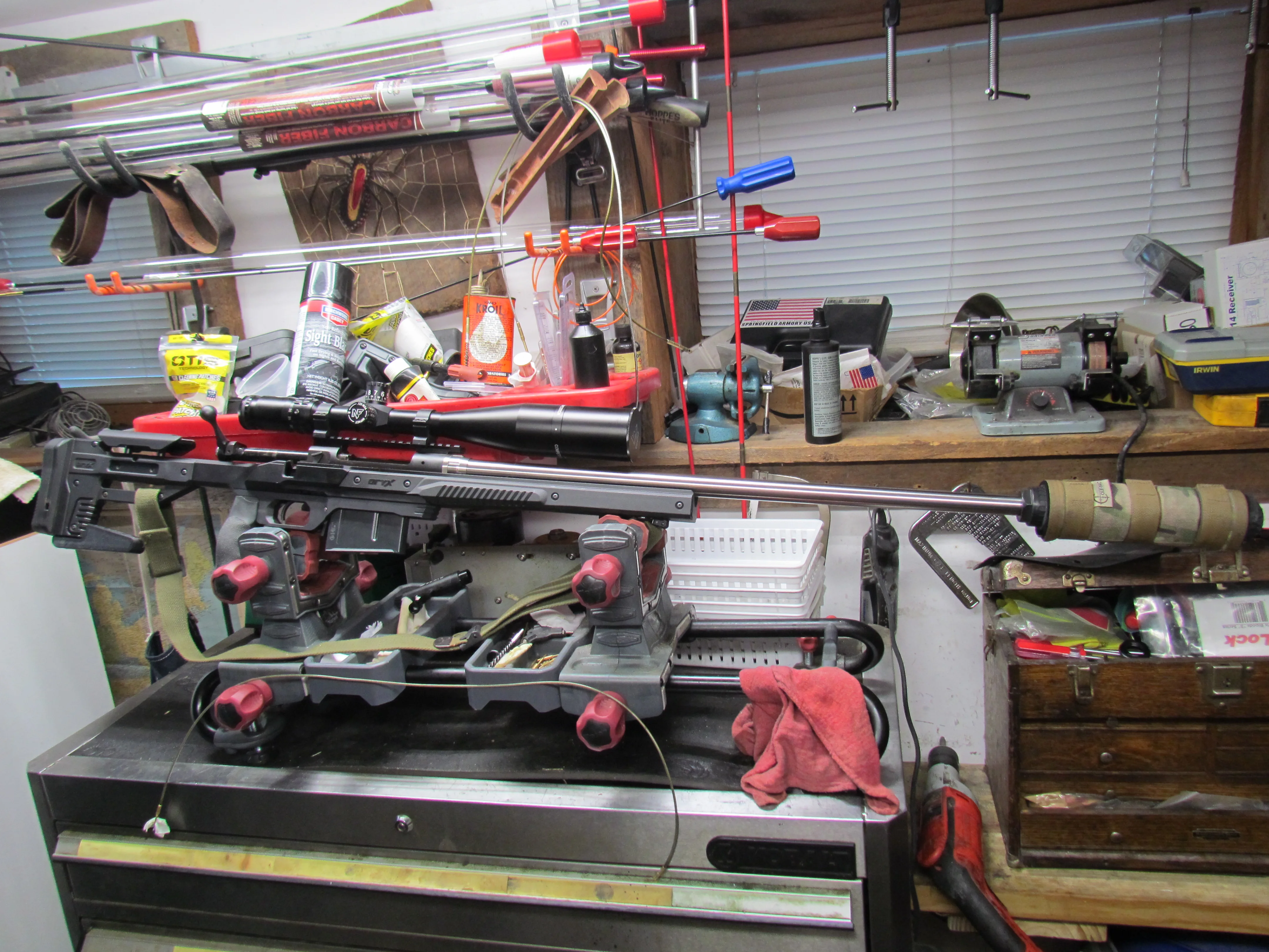

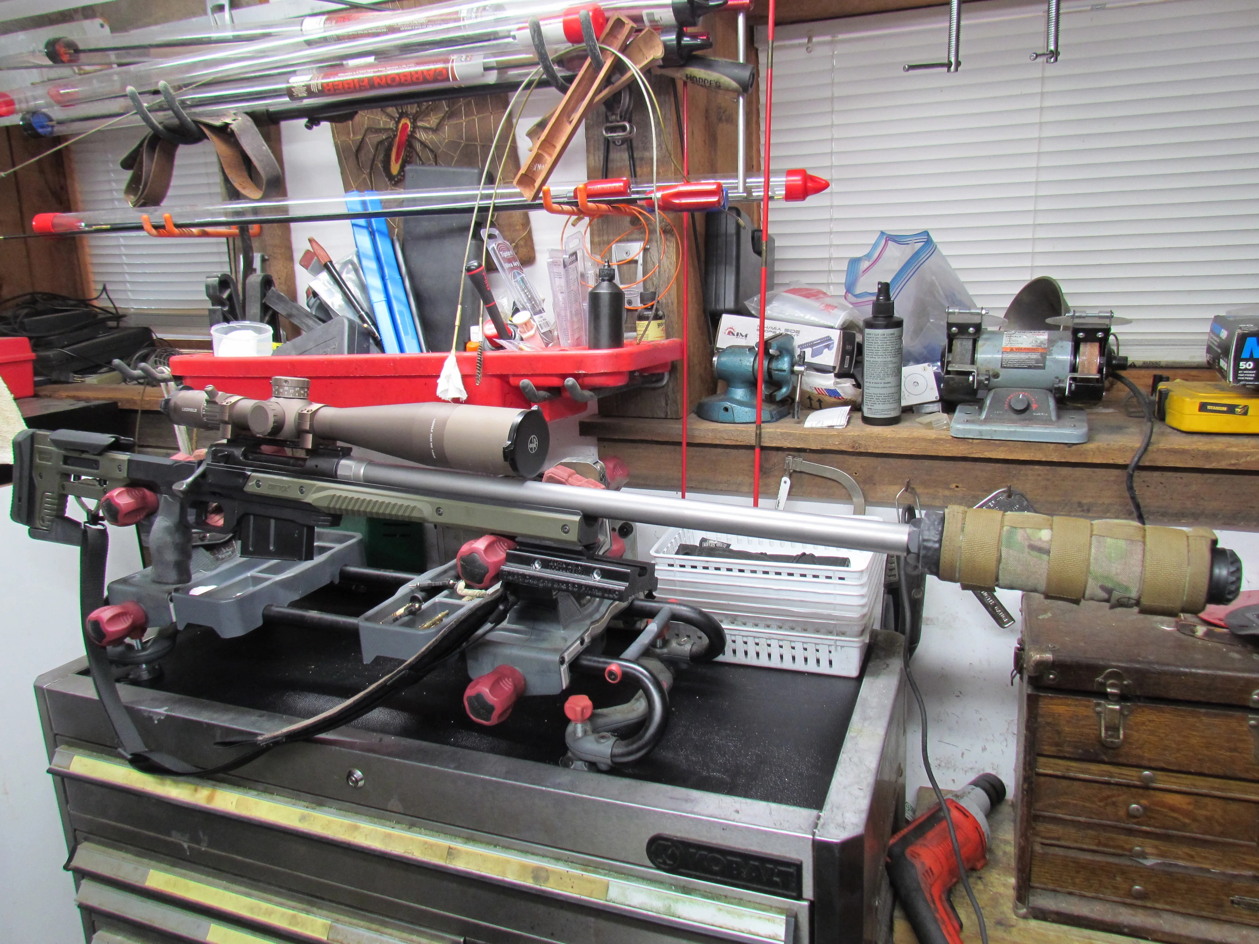

I have a 1985 vintage, left handed, J action model 110 which has different action screw spacing than the modern 110 action and the through-the-stock, side button magazine release. Fred at SharpShooter Supply accurized the action, installed his match trigger and put it in one of his bag rider stocks. He did not enjoy doing that one off stock for that gun.
It's the bottom gun in the photo below:

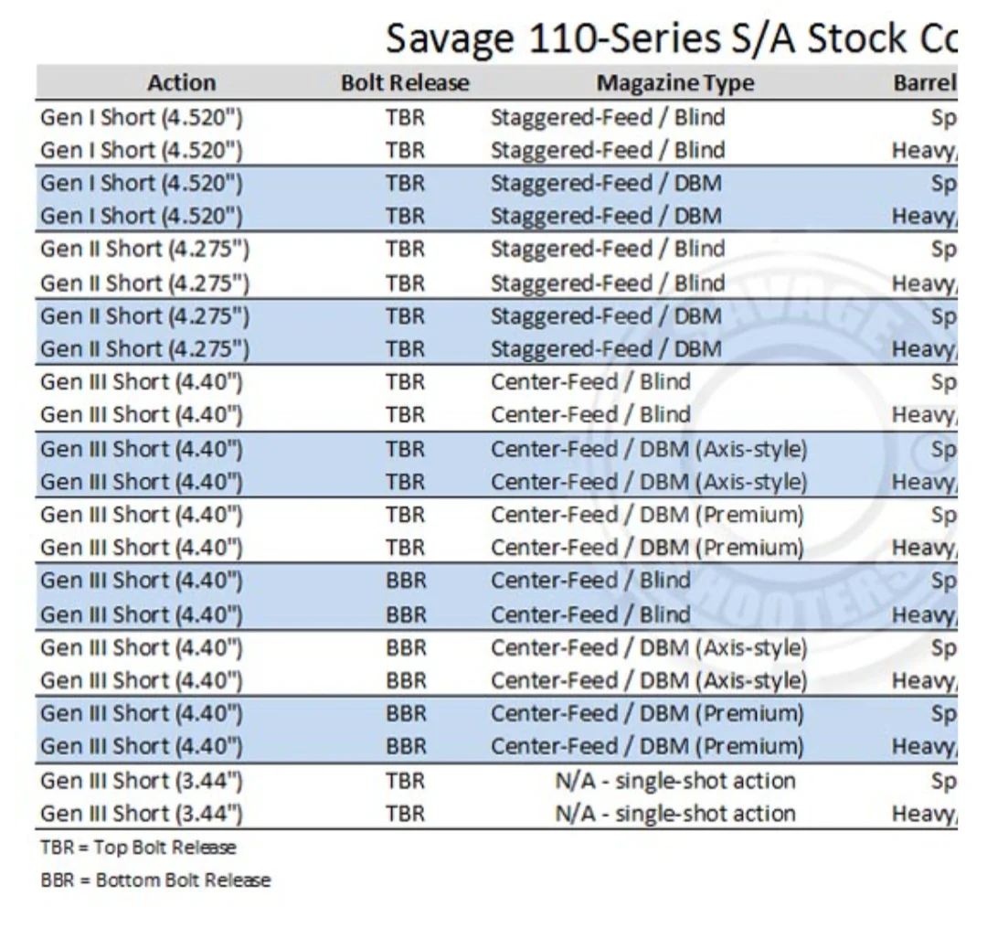

Shot action are 4.4 inches there were some old actions that were 4.27. The Savage Long actions are 5.062. All Target actions a short action most are 4.4 but there are some 3.4.
