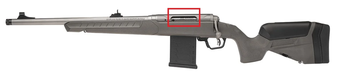

As a side note, since this is where the newer 110 is being discussed, what do people call this style of ejection port where there's still a lot of material left on the receiver versus some of the older models where that top third or so above the bolt body was shaved off?

I'd imagine that the receiver with more material is stiffer, and there are a few different 110s that are now being offered with that style, not just magnums.
I've also seen "shrouded" and "target" and various monikers used to reference the ejection ports, but I at least haven't found the decoder ring to know exactly what folks are talking about. 😅
I have always known it as the Target Port as that is how it is/was presented on the Model 12 Target and Precision actions. Later universally used on the Axis models.

On a Savage it’s called a Target Ejection Port. I have heard the style “Shrouded” for this. However, I’ve mostly known this style to be called a “Hooded” Action. In any case, it’s not all that important what you call it. Most people are familiar with the Model 12 Target Actions anyway. And yes, any hooded Action is going to be stiffer, more ridged than an Open style Action. They are not typically chosen for hunting rifles though, as getting rid of a stuck case can be more problematic.
