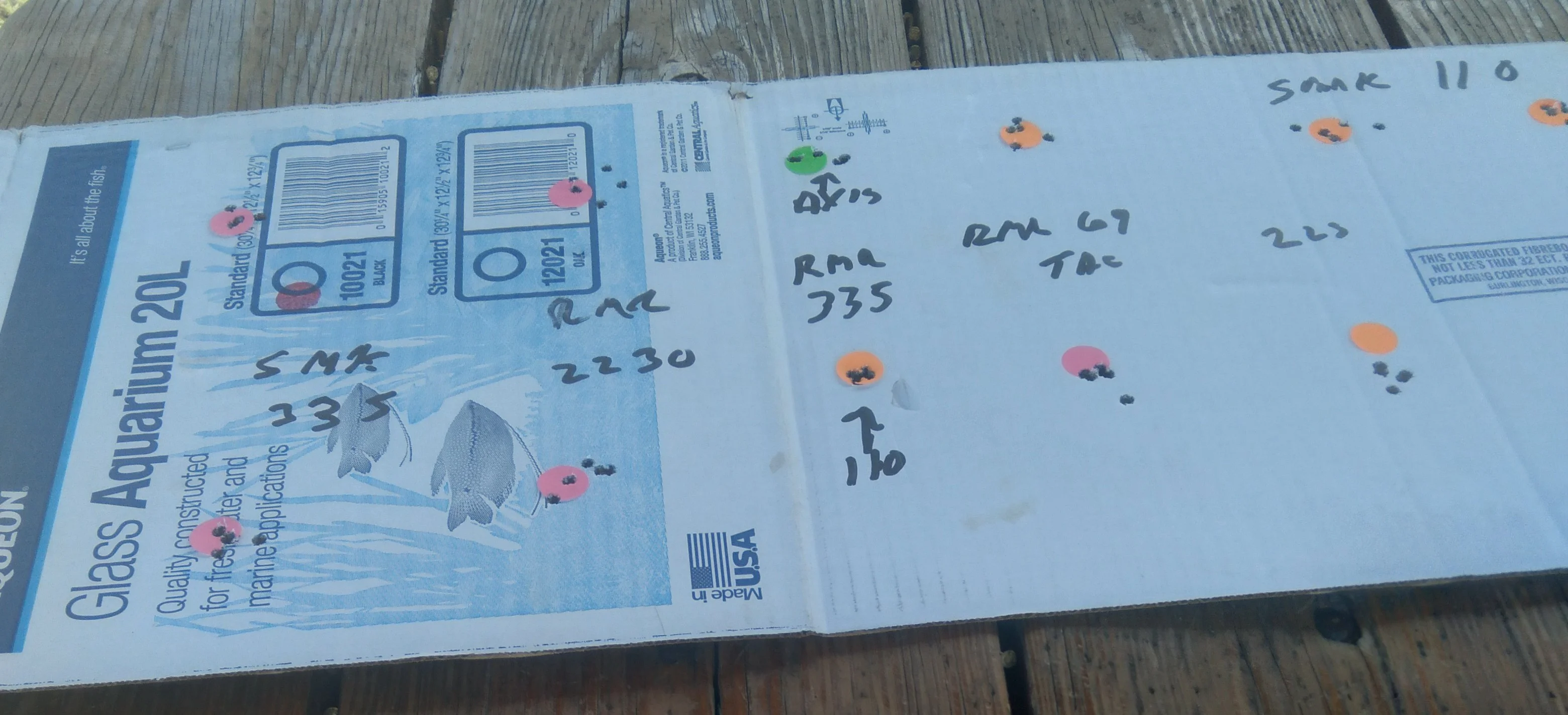

I'll give the Varget a try with SMK'S. I tested some other loads with them. And RMR won out.
Thats good to see the RMRs are doing well. I bought 1000 awhile back figured I'd use them in my 20" AR, but if they shoot that good I'l give them a try in my bolt
