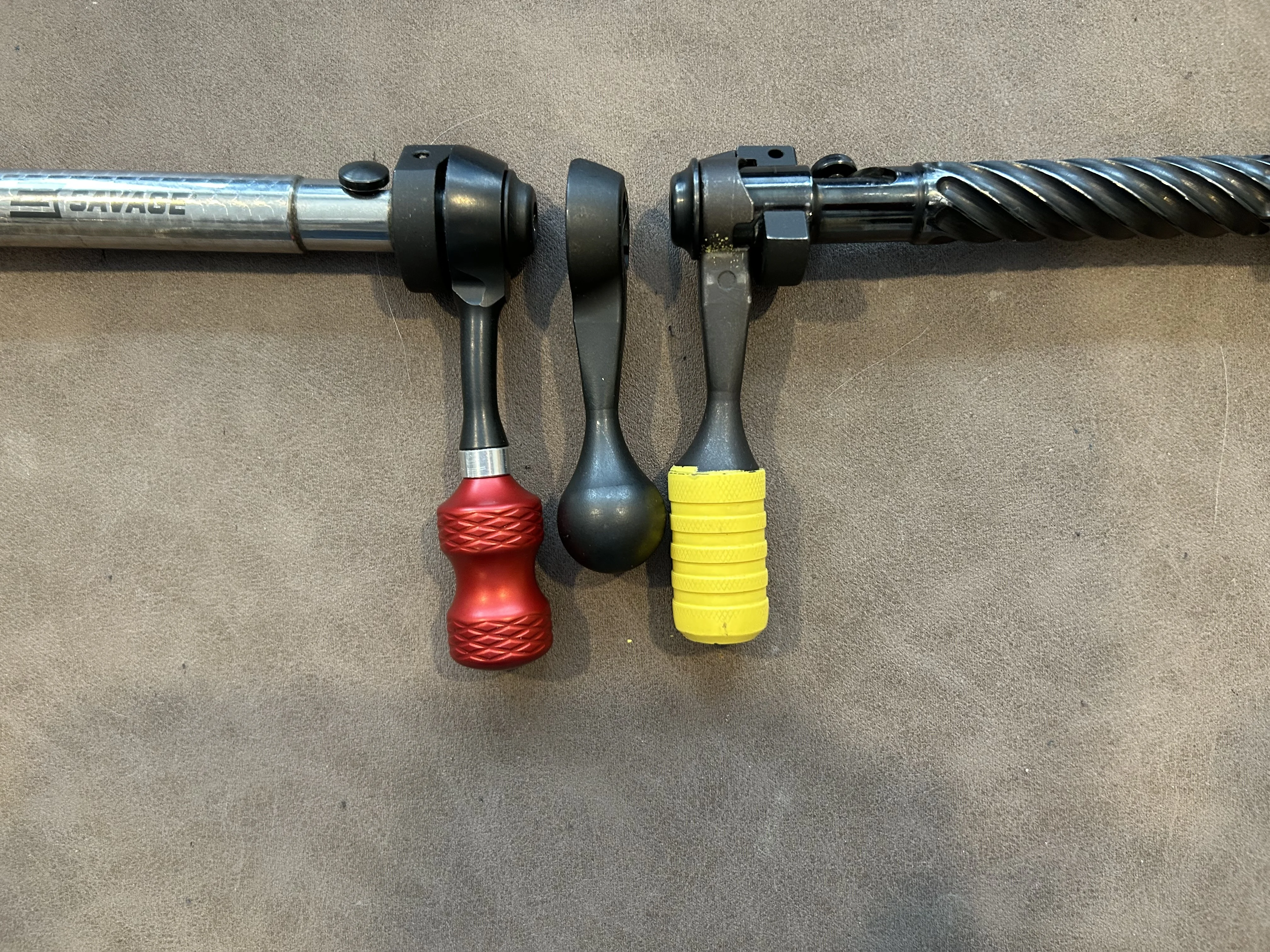

I would do the longer bolt handle and knob first. Then if you still don't like it do the kit. Personally, I did not care for the kit at all. You can tell by the photo below how an extended bolt handle is a good bit longer that the factory. The red bolt knob is a Big Bertha.
The factory is the middle one.
The red one looks to be almost 2 inches longer than factory which is a bit longer throw, wondering does it work well with a scope?perhaps could we see a picture of it in the open position and one with the closed position?I'm interested to see 👀 how much further it will protrude from the stock. Thanks 😊
