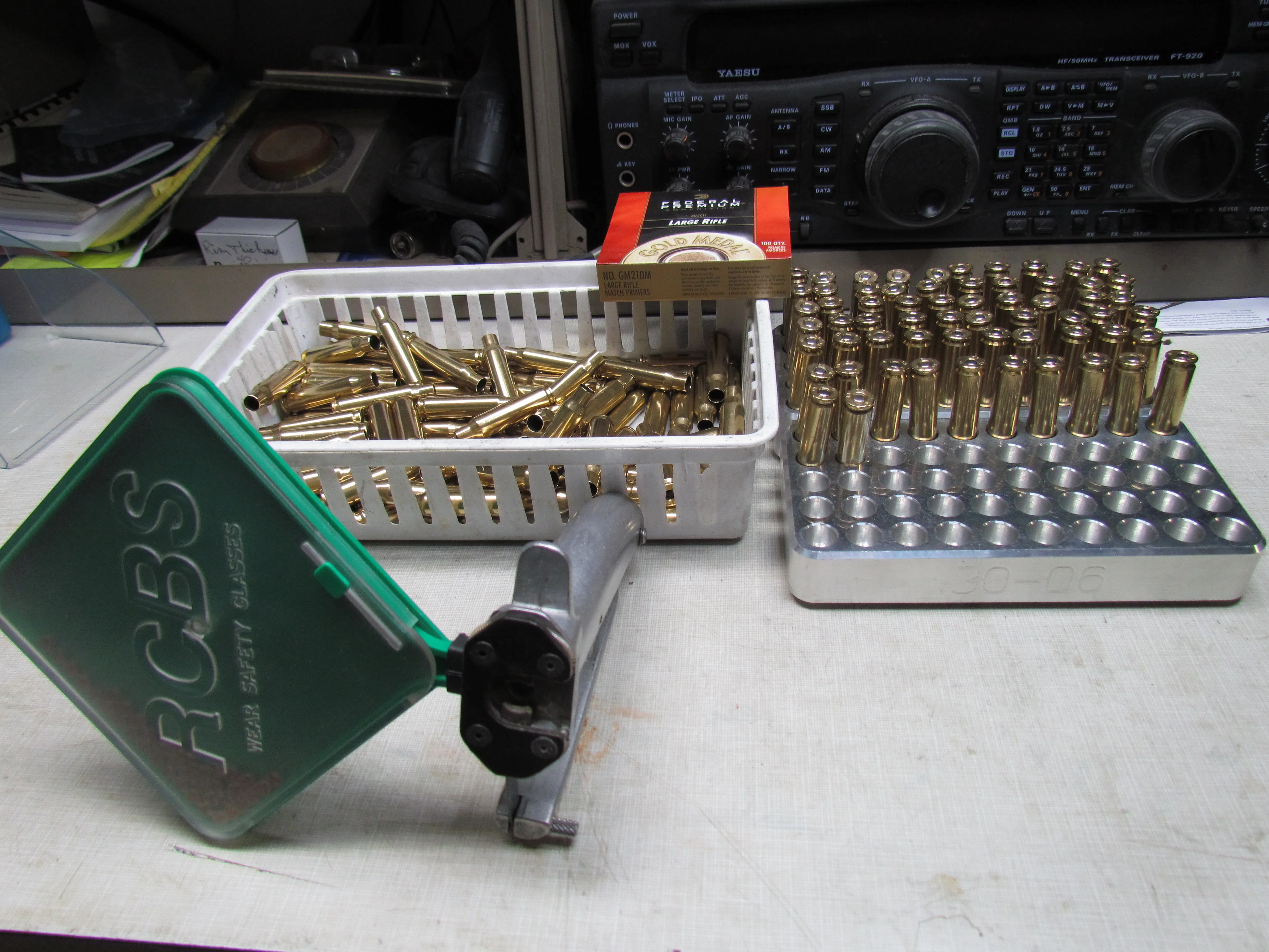

Working with 100 once fired Lapua and 50 Starline cases. Annealed, sized, set neck tension, trimmed and primed. Will be headed down to the bench after a short break to calibrate the RCBS Matchmaster and start loading 23 gn of Varget under 73 gn Bergers which have been HBN coated. Whatta Hobby!

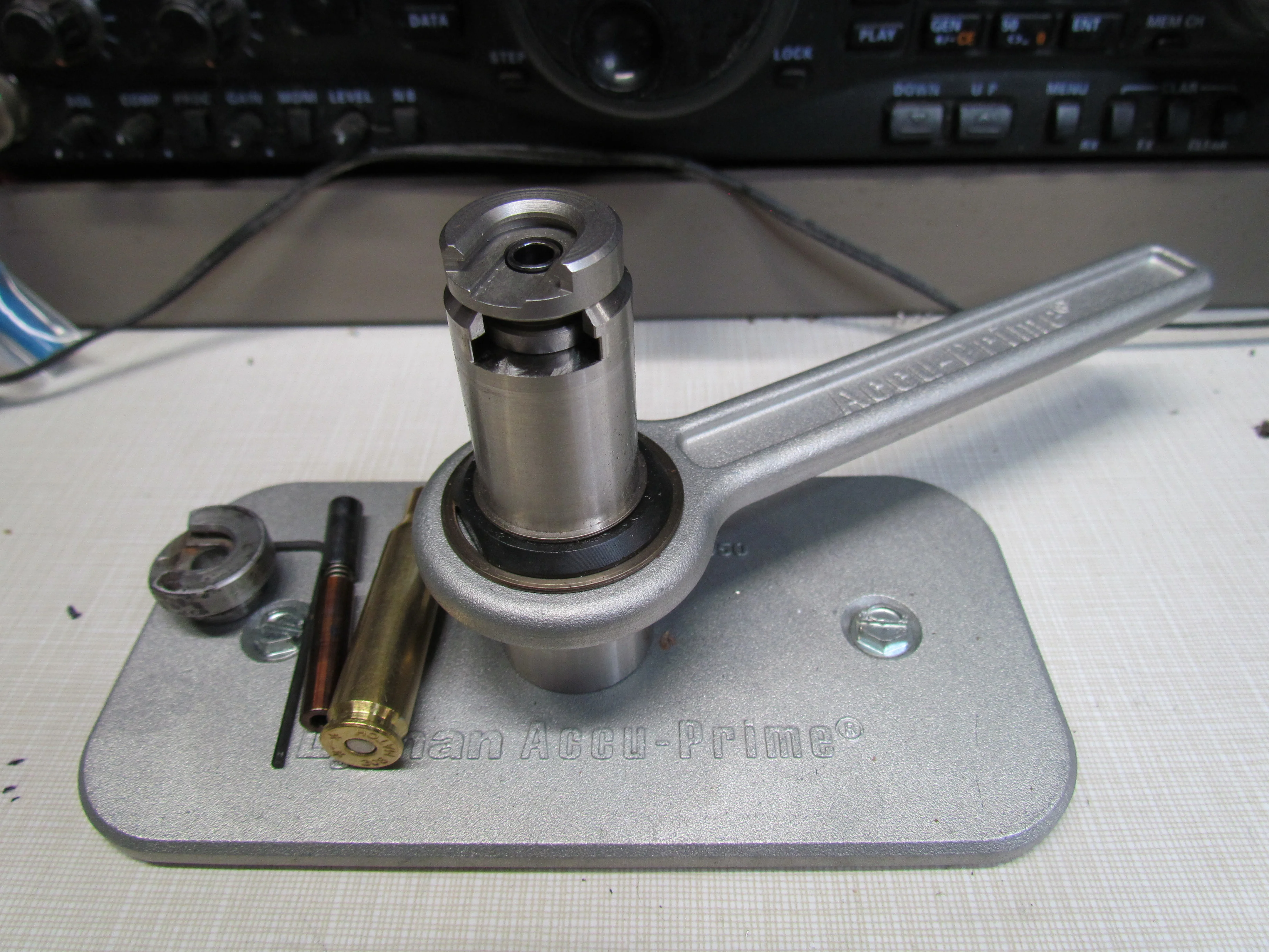

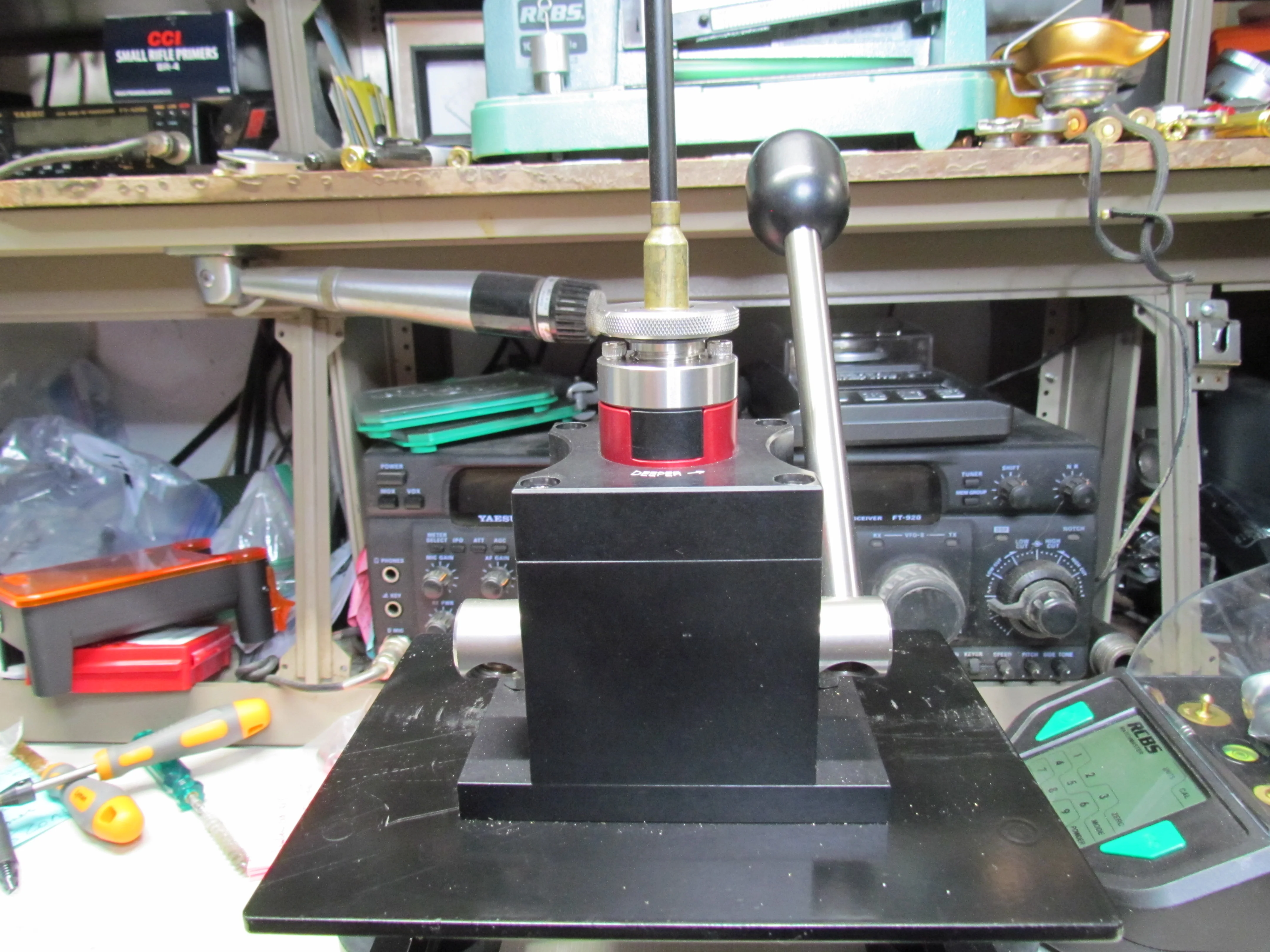

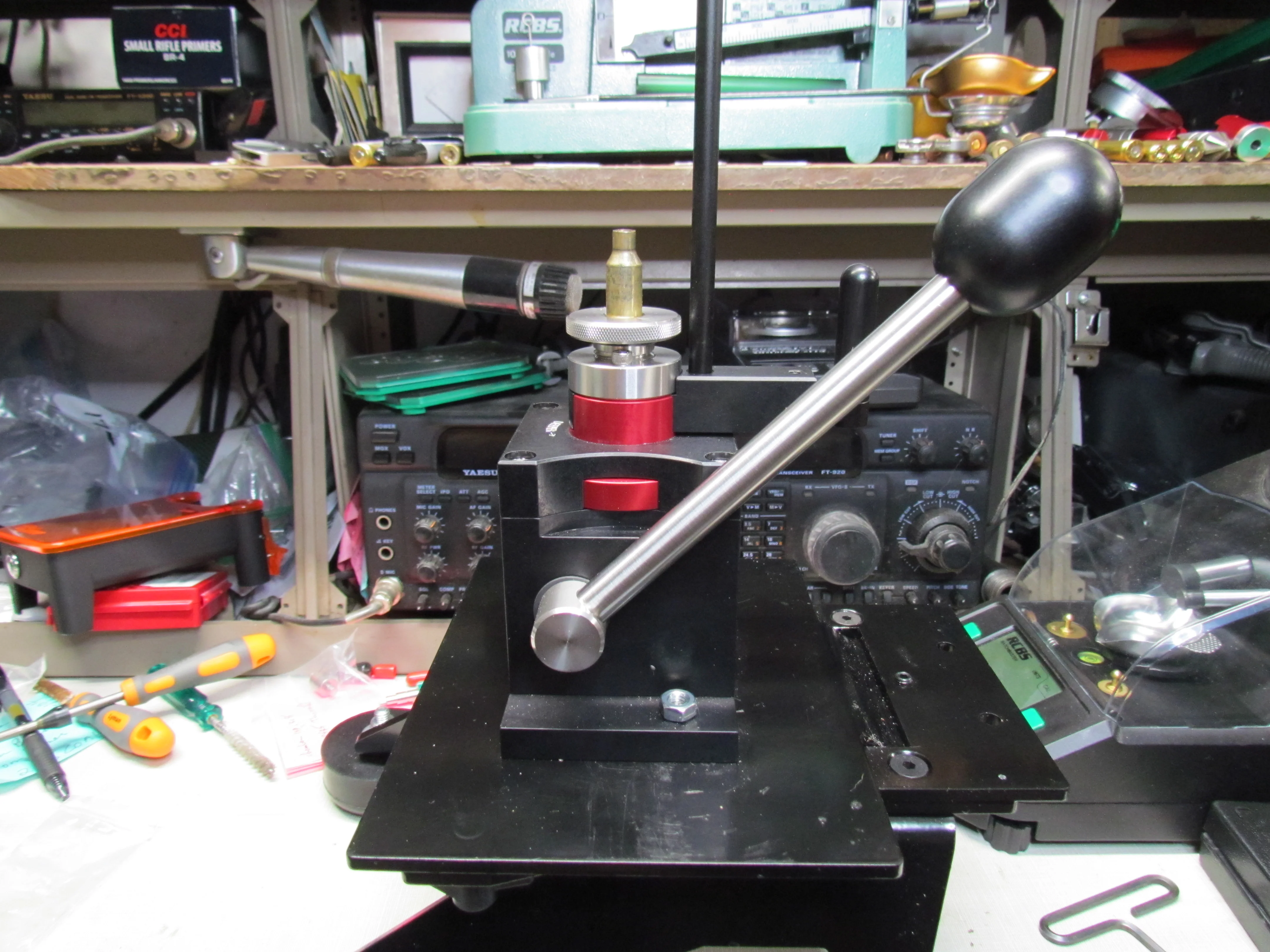

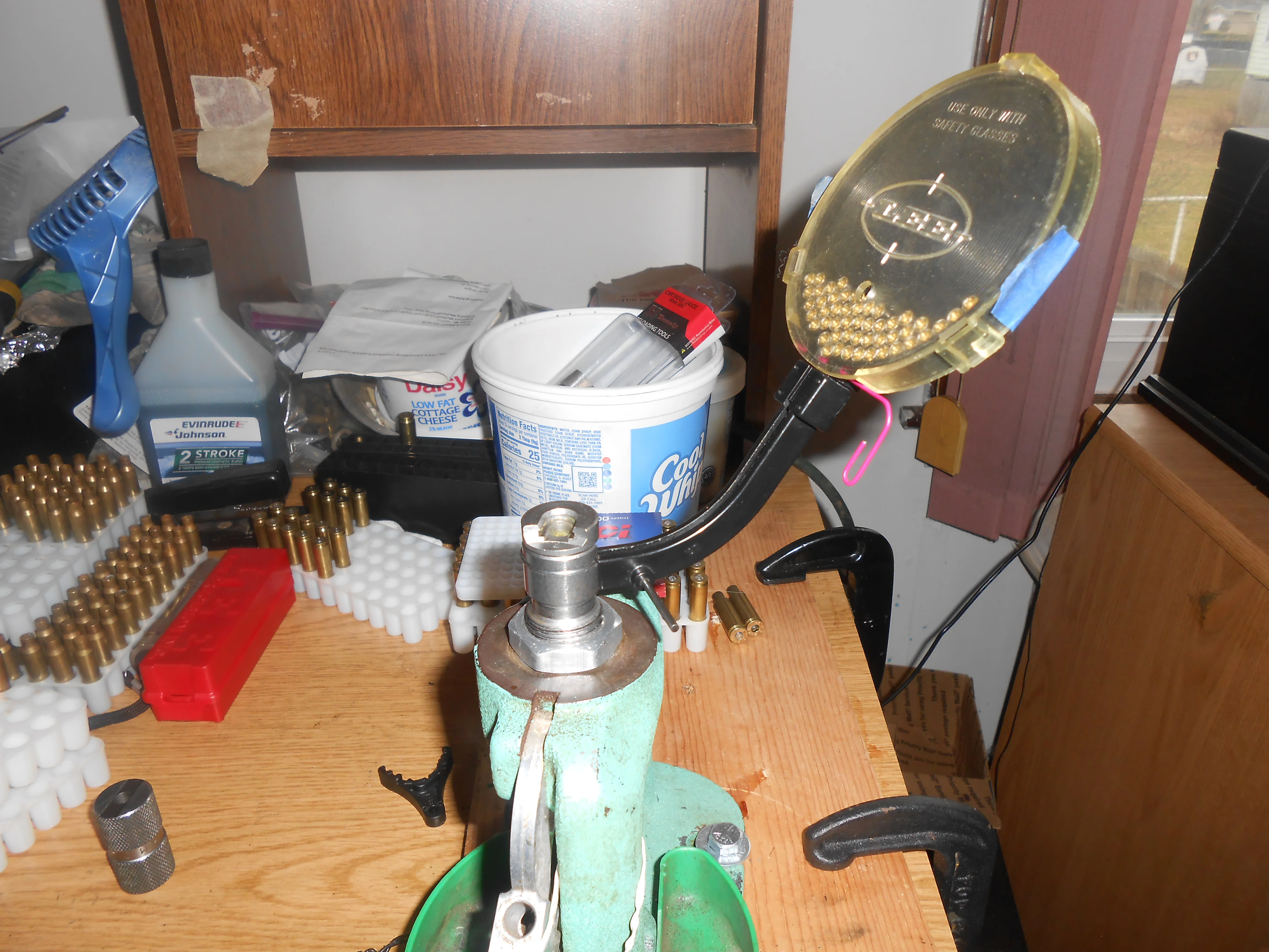

Haven't seen any primer pocket problems with either Lapua or Starline brass. I have plenty of batches that have gone past 15 loads with both. I use a Primal Rights tool with an extended handle for all my priming. Had the same problem with worn out wrists and elbows after priming 10K +cases annually. Now with the Primal Rights it's no problemo to just keep going. I use a vibrating tube loader for primers so it easy squeezy. Whatta Hobby!

View attachment 976View attachment 977
Well shucks! Using that BIONIC MACHINE, you could probably “seat” a primer in a solid piece of brass without feeling much resistance! Until the primer lit off I guess.😂 It’s like a Hand Primer on STEROIDS….. and CRACK!
Works great. With the micrometer depth set I can set it for the .004 crush I like and it's right on the money.

I don’t doubt it. It’s a fine looking machine.👍

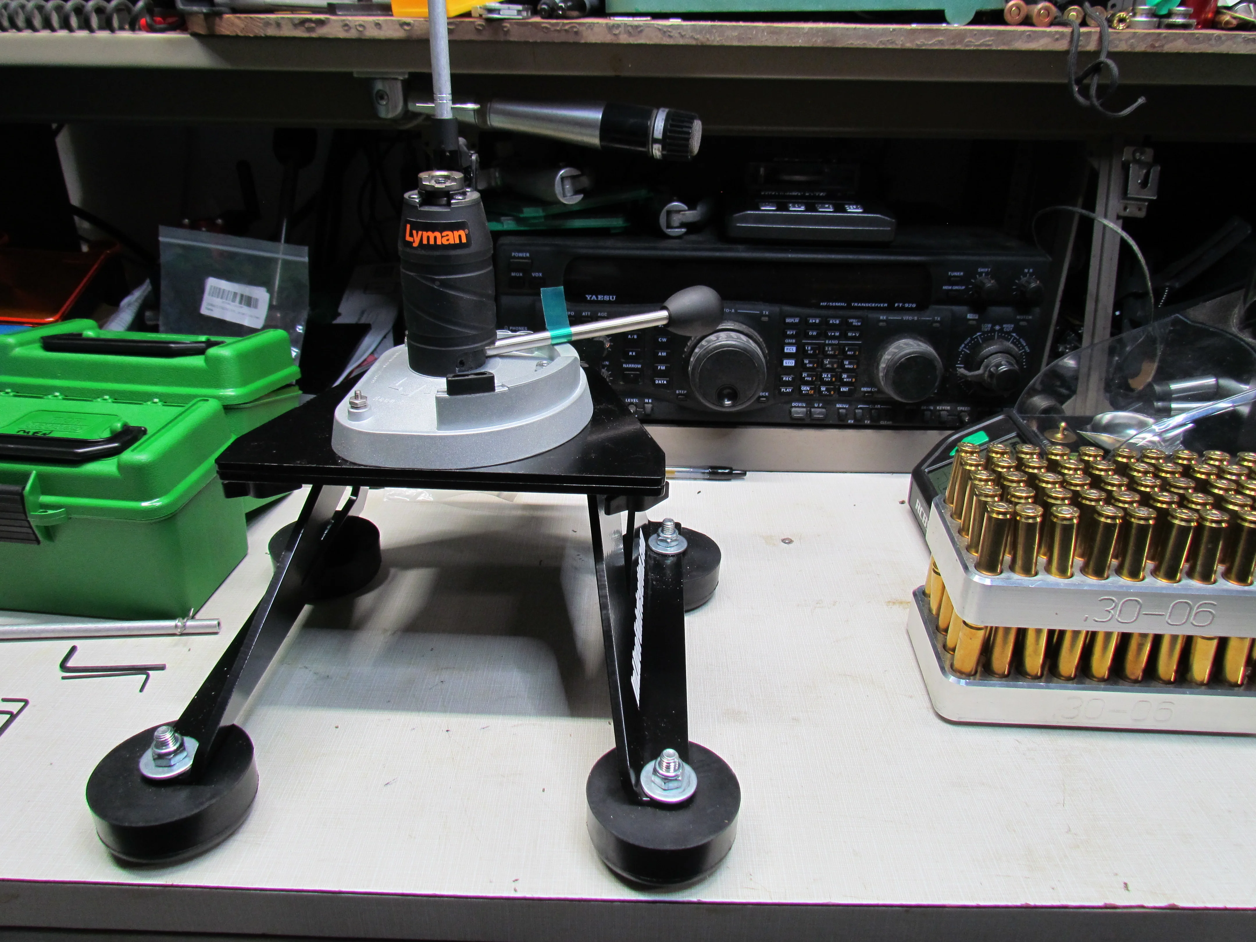

However, aside from cost, and WHO sells it, my Lyman E-ZEE Prime, hand primer works flawlessly. Albeit, it’s not quite as spiffy as that one.😉
Well, I used hand primers for 60 years and my hands are just worn out. We do what we can. I did experiment with a pile of other types of priming tools before settling on the Primal Rights. Whatta Hobby!
