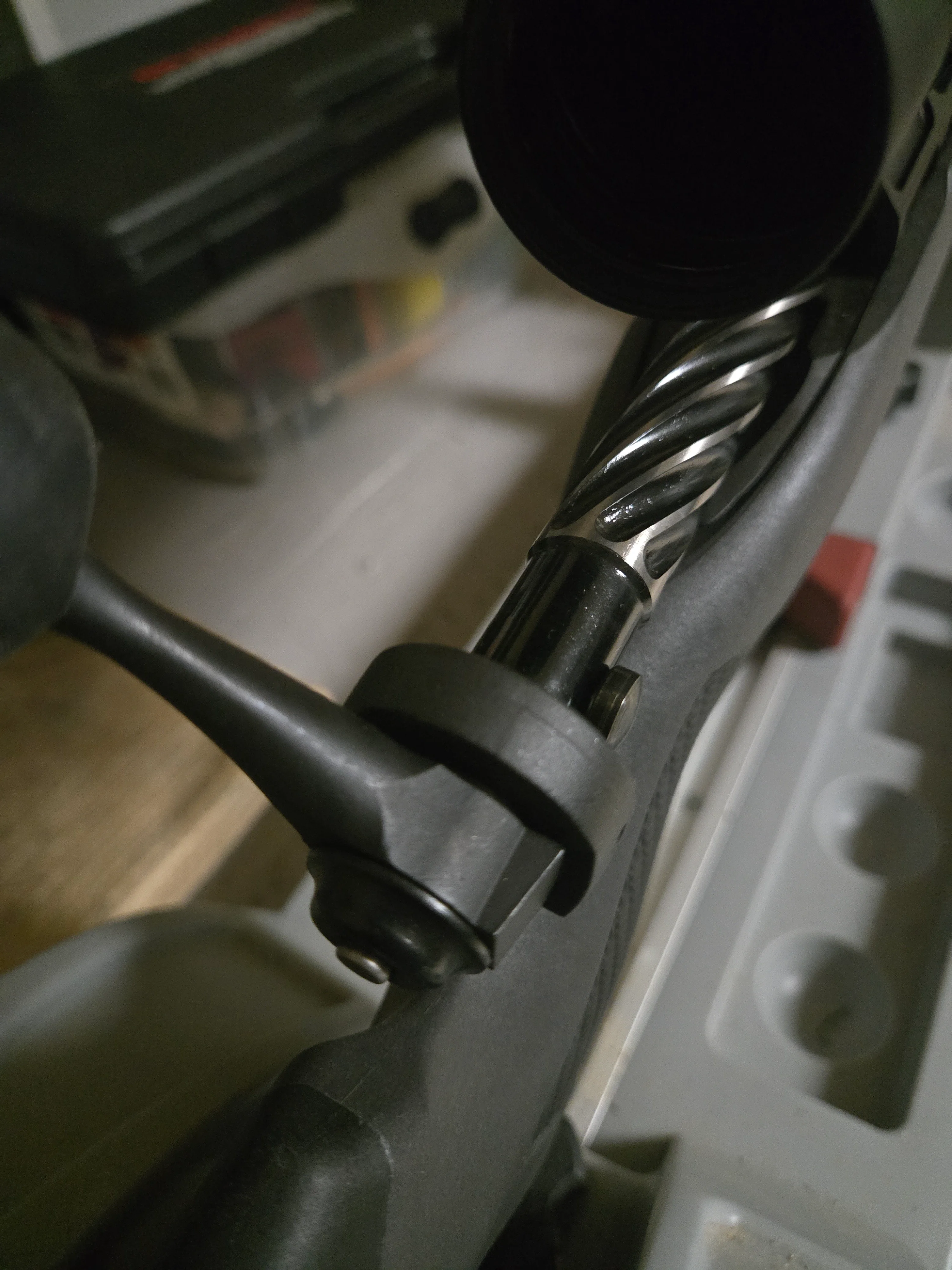

This is what they did..they took the bolt stop on it off..took it out today doing the same thing almost need a hammer to eject the casing..i put the bolt stop on it and it worked much better.still not great.

After firing i am able to pull the bolt up and it gets stuck trying to pull the bolt back to extract the casing..when i put the bolt stop it was easier to pull the bolt back to extract the case..
Not sure what you mean by bolt stop? But, have you only tried only the ONE kind of ammunition? I would try another brand. Federal, Nosler, Remington, Weatherby, Choice & Berger all make 7mmPRC.
It’s possible there’s a problem with the primary extraction. But that’s easy to check. Use a feeler gauge between the Rear of the Action & rear Bolt Baffle. Take note of what size feeler can fit between the two. If you watch the bolt action, you can see how the Ramp on the rear baffle acts against the ramp of the bolt handle. This is Primary Extraction.
Unfortunately, if the gap between these two is too great, the only way to fix is either shimming the rear Baffle, or removing material from the bolt sleeve. (I’ve done both.)
I, also, don't know what you mean by "put the bolt stop". The bolt stop has nothing to do with extraction, it simply prevents the bolt from coming out of the action when fully back.
Your comment the bolt gets stuck when trying to extract the case leads me to believe you're experiencing significant case expansion.
Try a different brand of ammo. Could be the Hornady brass is simply too soft, somewhat a known issue, and expanding too much.

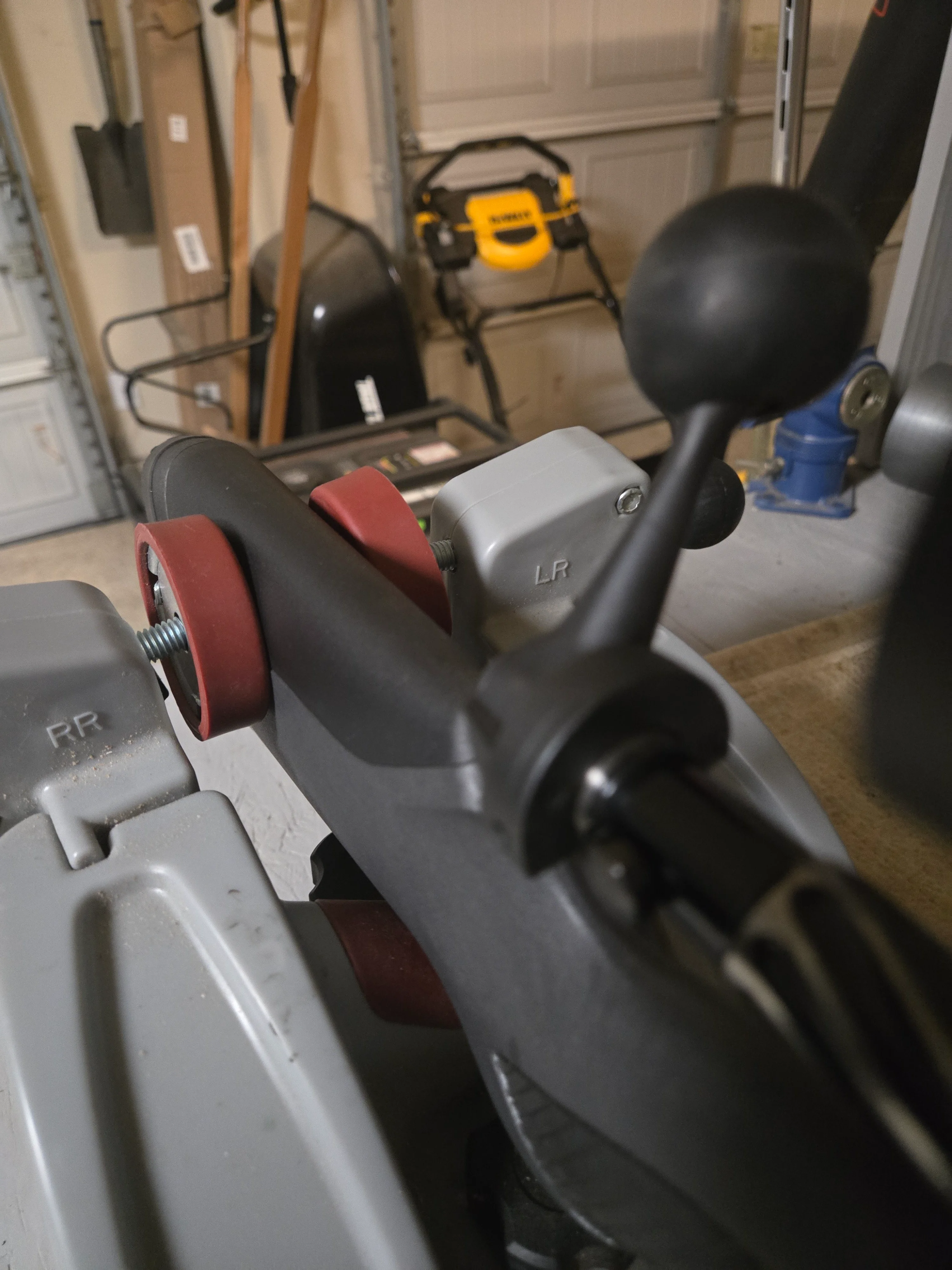

That is the bolt stop keeps the bolt from coming all the way up..so i have been told..i am no gunsmith so i do not know all the terminology..was going to take this gun elk hunting but not going too. I have no follow up shot..
Not sure what part you mean? If it’s this one below, that is the Rear Baffle.
Thats it rear baffle
Ok, yes, it absolutely NEEDS the Rear Baffle. That is what controls the Primary Extraction. So, without that, the case will ALWAYS be stuck!
I’m agreeing with Seven, that the pressure is expanding the case. Causing it to stick more than it should. Again why I recommended trying another few different kinds of ammo. (Post #7). However, there may be an issue with your Primary Extraction. Once again, as I mentioned in post #7, try inserting a feeler gauge between the Rear Baffle and the back of the Action. (Like the picture I posted.) Try that next time you go shooting. Shoot a round, then BEFORE you turn the bolt, insert the feeler gauge. Then turn the bolt to extract the case. Take note of how it feels.
