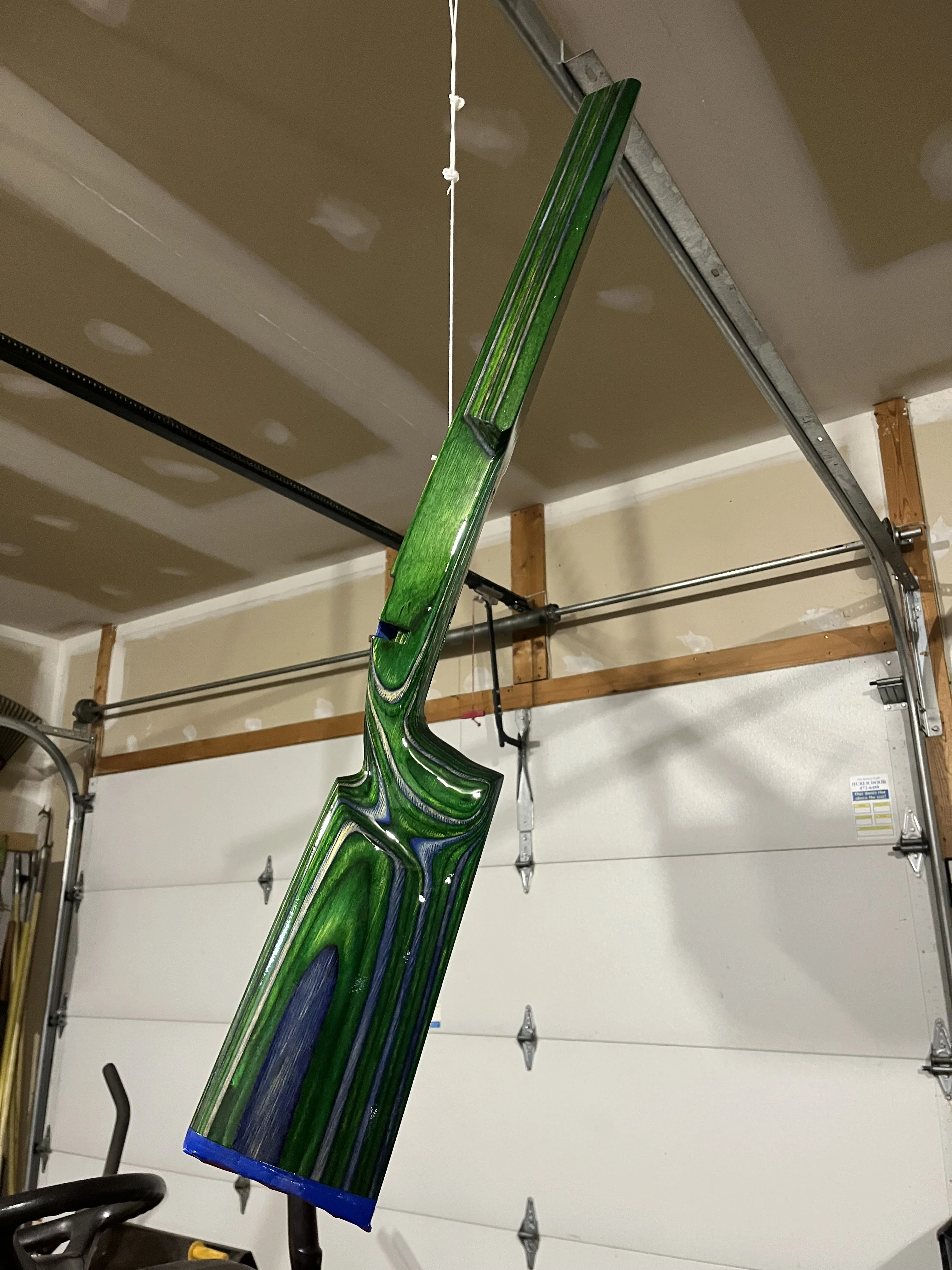

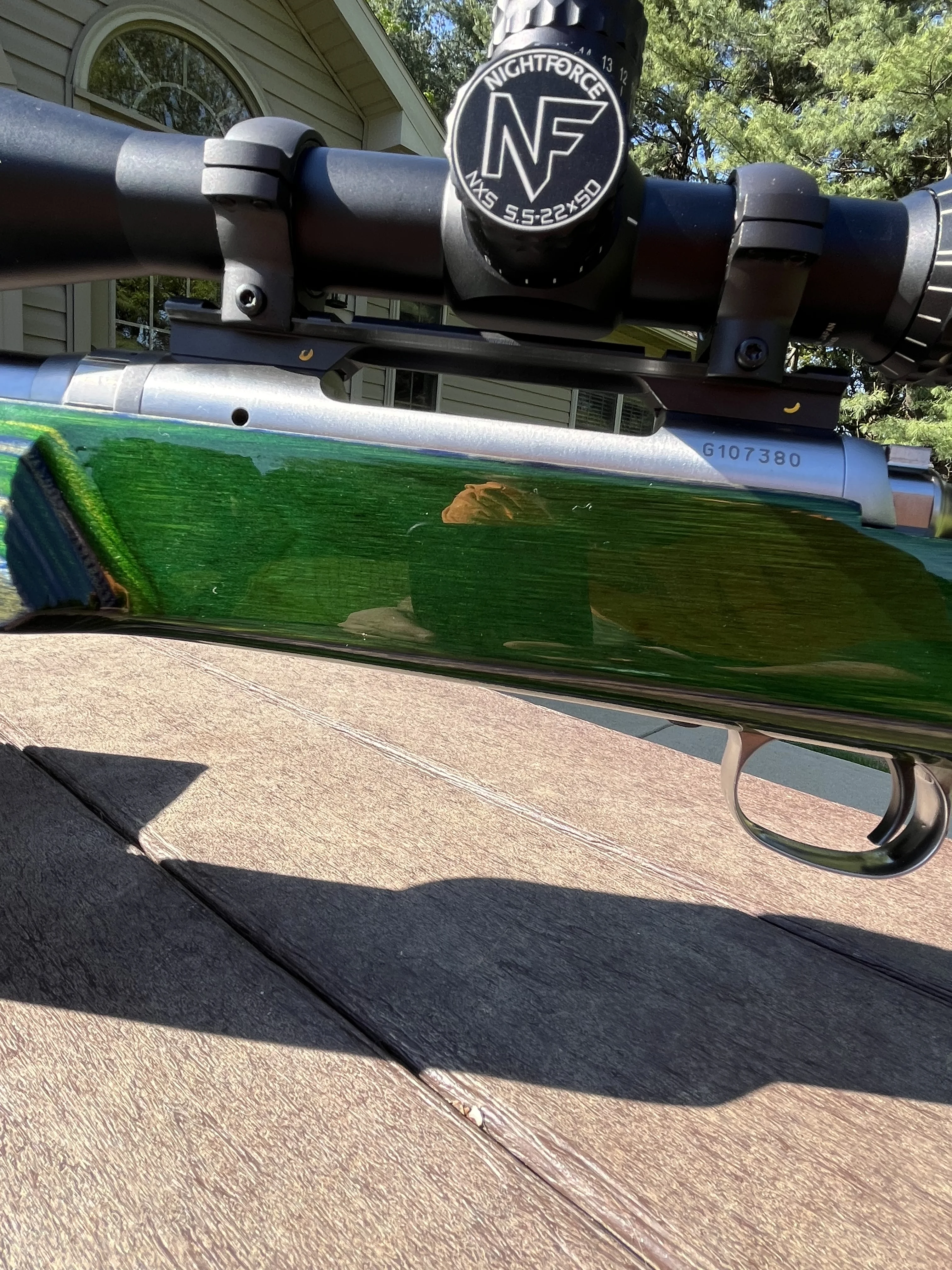

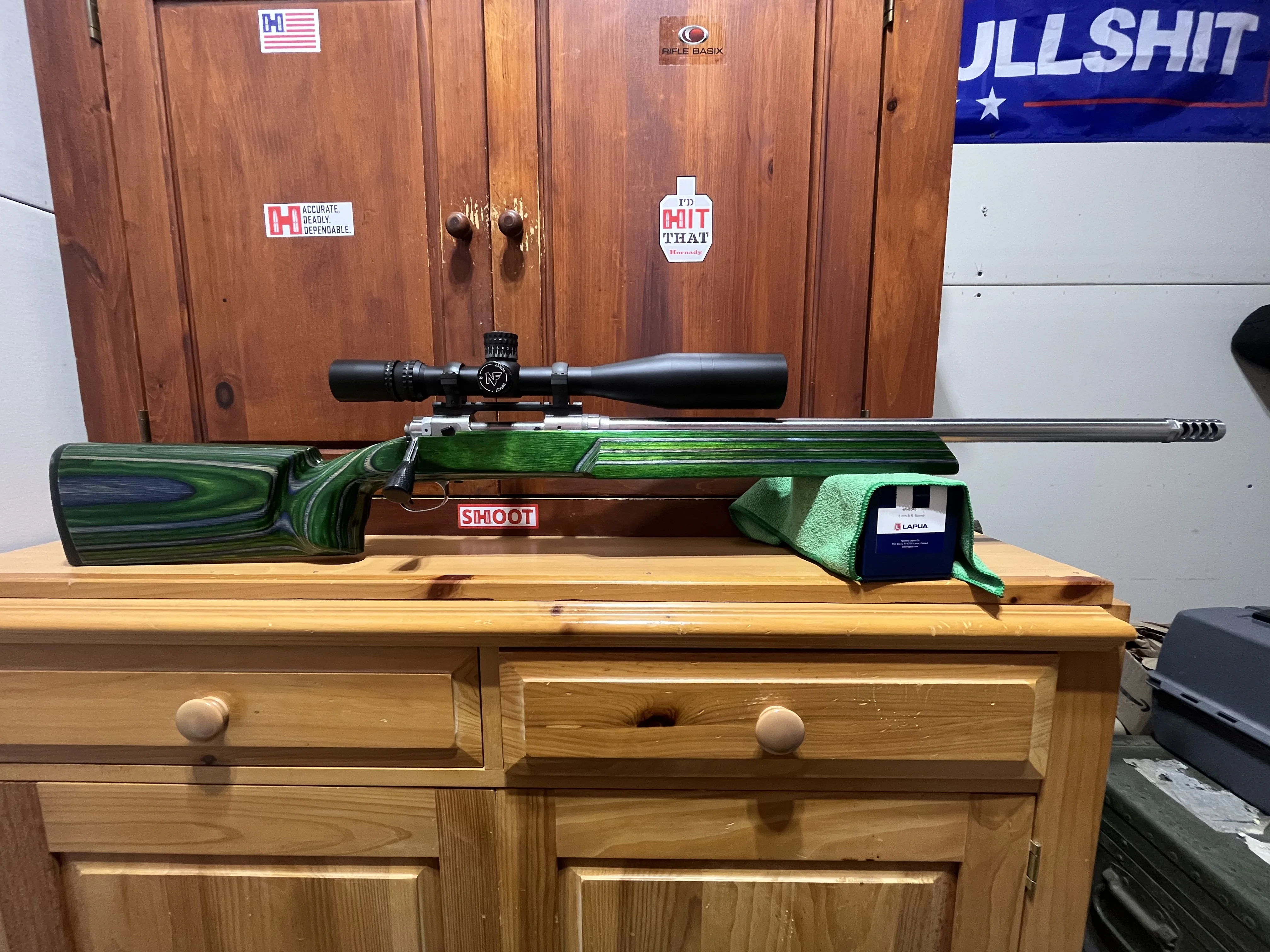

So I had a stock that just had the original dull finish on it, and I wanted to refinish it. Read over on Accurateshooter about using Spraymax 2K. This stuff is literally auto clear in a spray can! So I just had to try it out.
I wet sanded the stock and added 3 light coats of the Spraymax 2k to it and let it dry overnight. The next evening I wet sanded that with 2000grit sandpaper and then added a final coat of clear. I let that dry for a couple days, then wet sanded again using 2000 grit, then buffed and polished it.

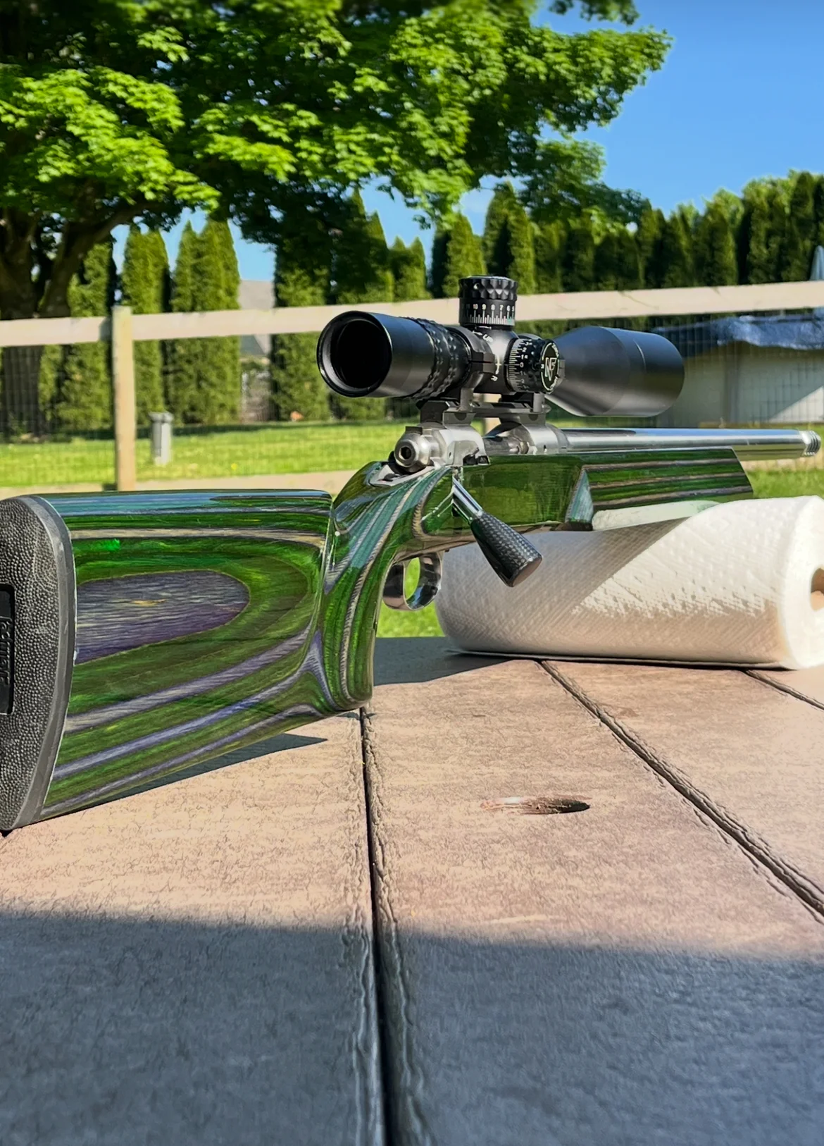

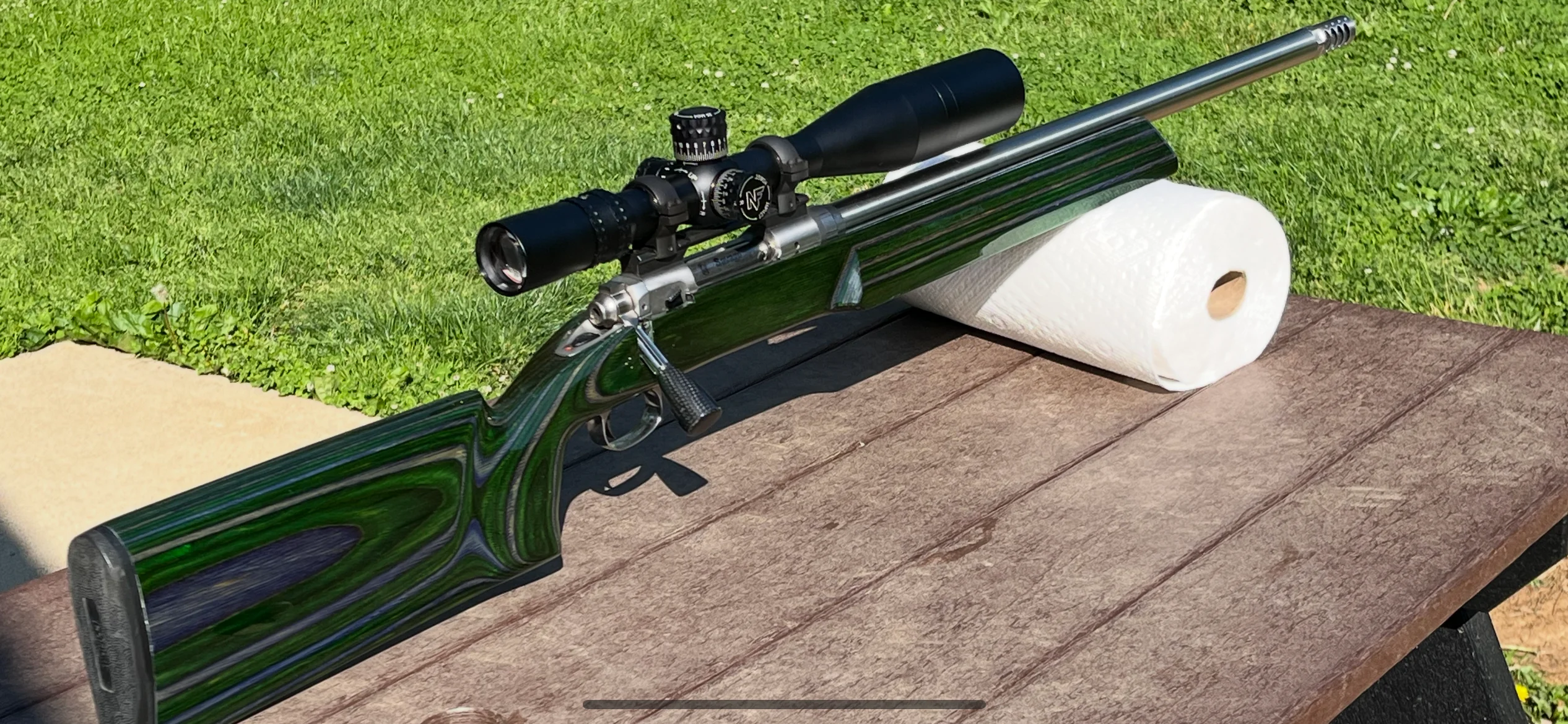

It is not perfect, but I have to say the pics do not do it justice. The green really pops in the sun.
So if you’re looking to do the same, the easiest place to buy the Spraymax 2k is on Amazon.
Gun is a staggerfeed single shot short action with a Lumley Titanium bolthandle and carbon knob, Sav2 trigger, Wilson/Urbanrifleman 6br barrel, and a NF NXS 5.5-22x56.
Here’s a couple pics. Once I get one in the sun I will add it as well.

It actually looks great! Would be awesome to see how it looks in the sun. Don't forget to post one.

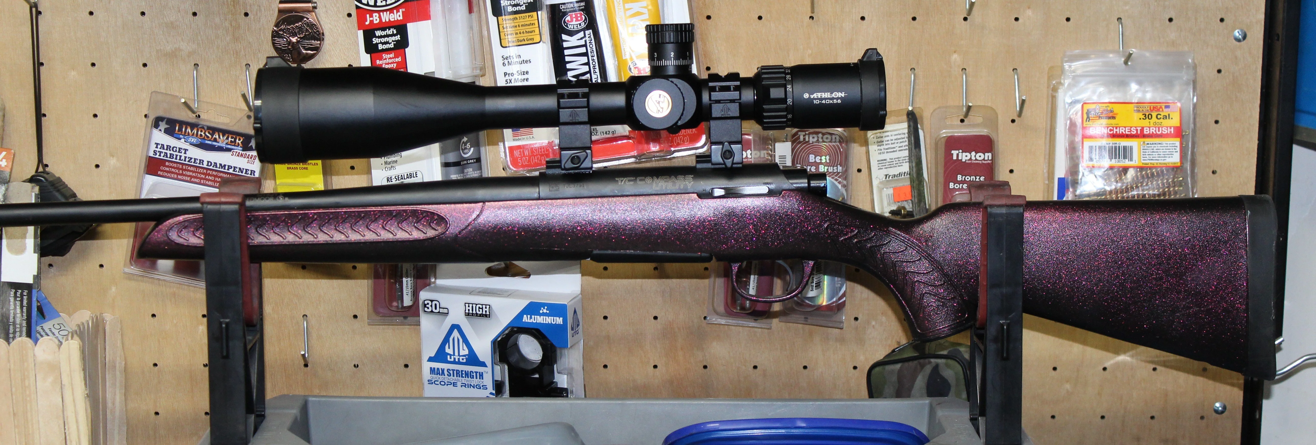

Nice, you got one for yourself.
Appreciate it. You know, it’s not nearly as expensive or difficult as I once thought it would be. I don’t wish to hijack pdog’s thread, however, if anyone is interested, please don’t hesitate to ask. I can instruct on exactly what is needed including cost & where to purchase everything. 😊👍
Or you can post a new thread about it. Might help someone. :)

It looks perfect! Great color & shine.
What company did the stock come from?
Thanks.
I bought the stock used but am pretty sure it is a Sharpshooter Supply stock.
It’s a benchrest stock, however I use it for long range varmints from my swivel shooting table. The flat bottom really helps stabilize the gun to allow me to see the impact.
