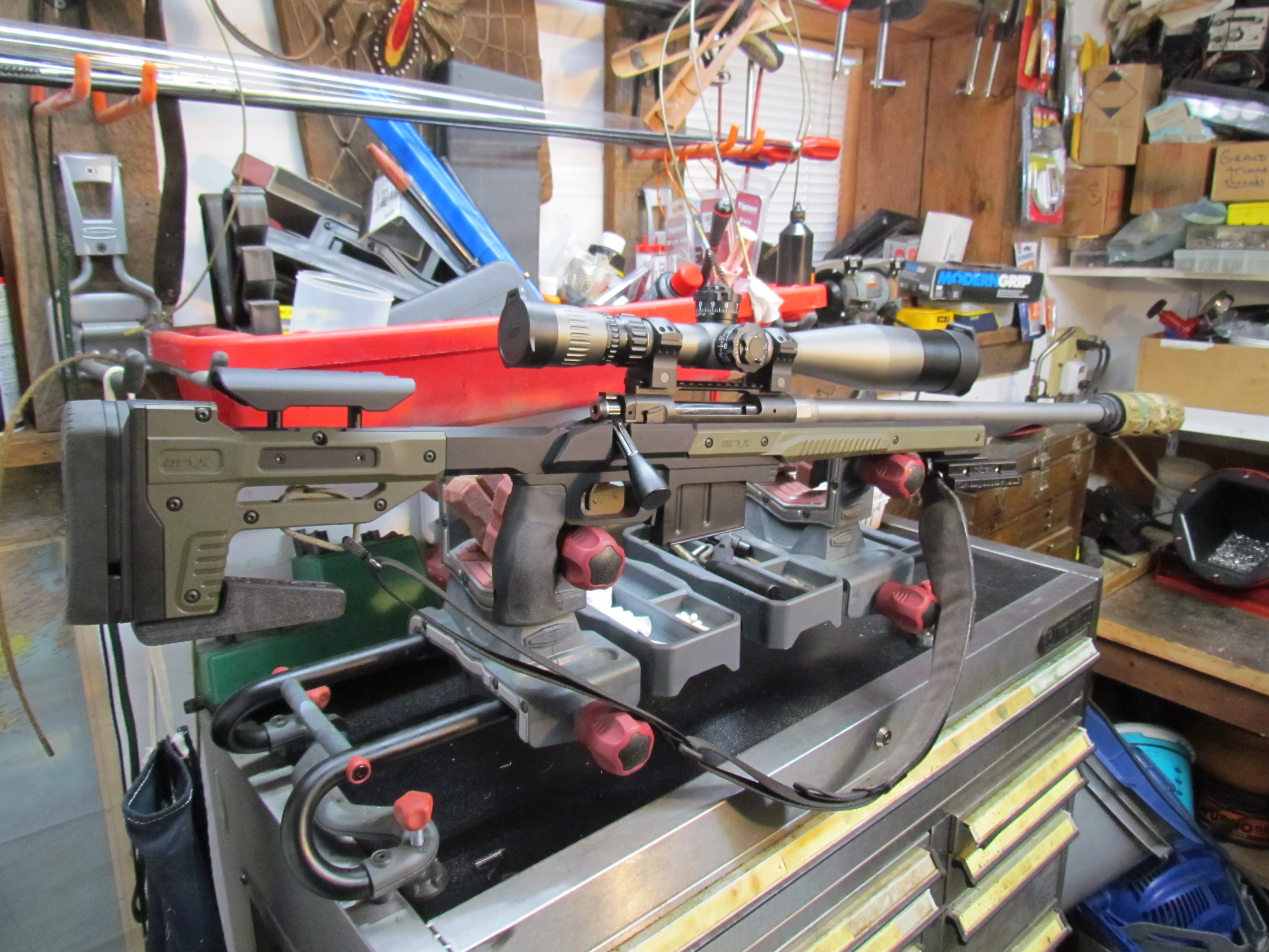

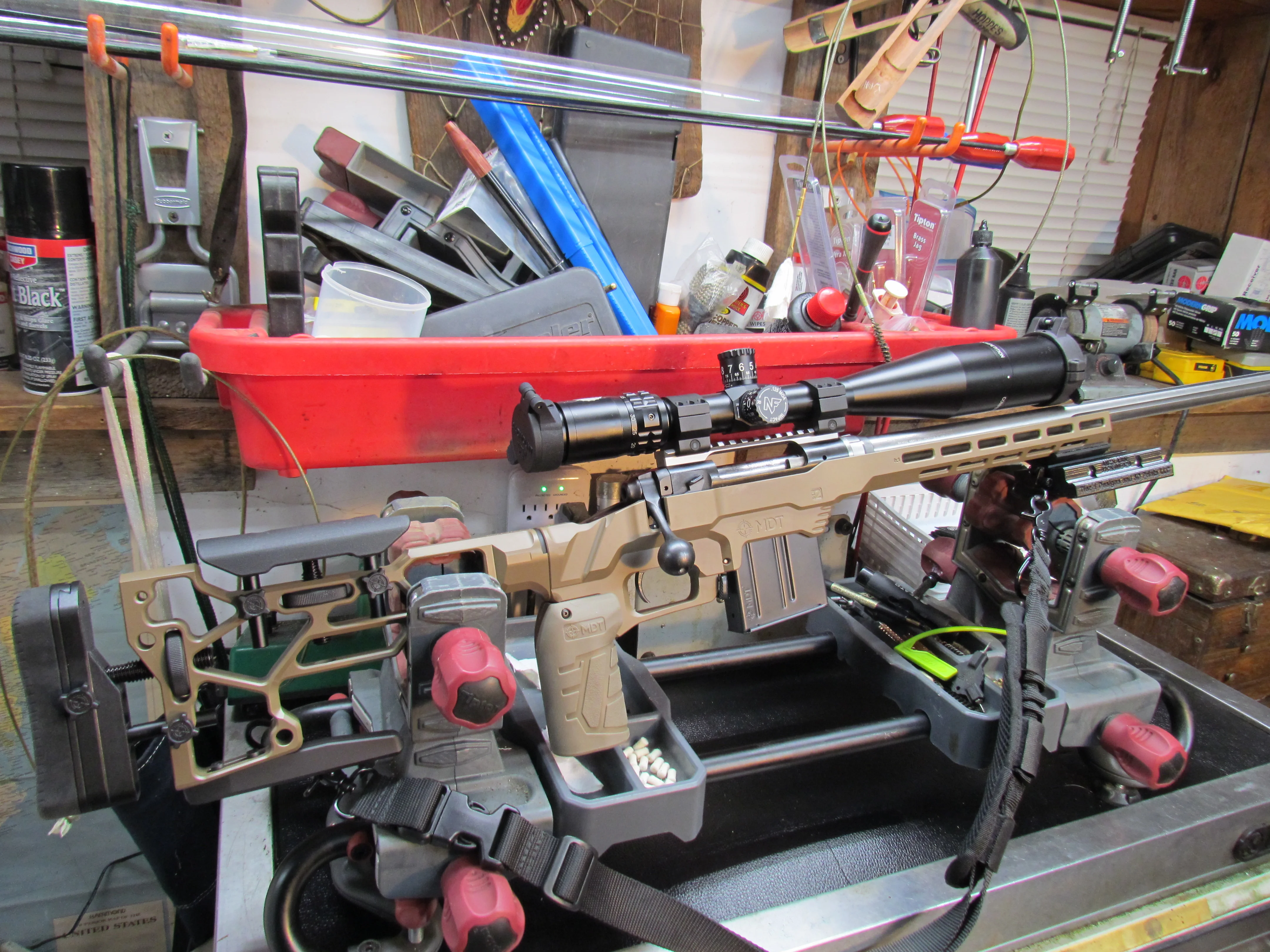

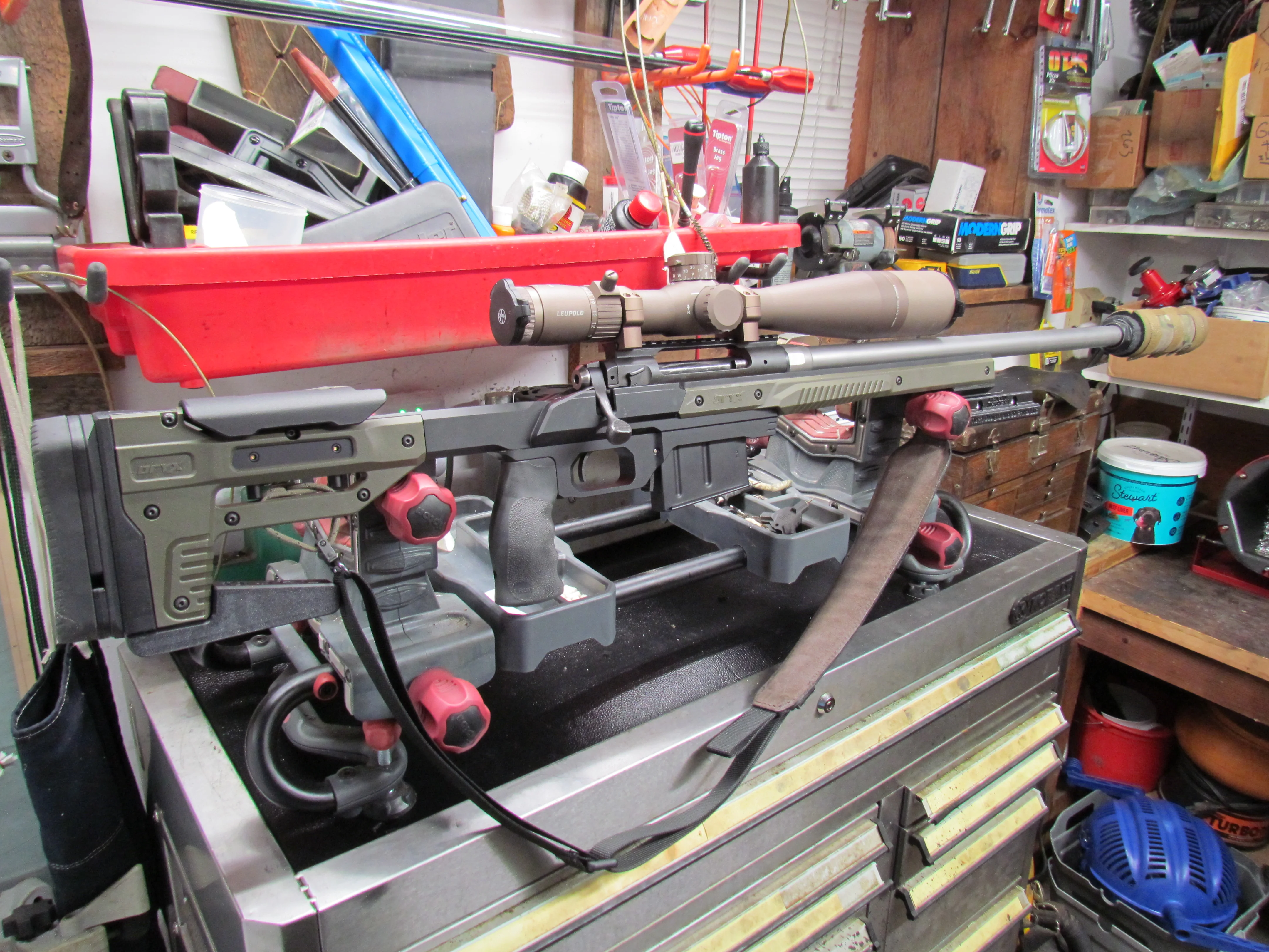

I just changed to AICS mags because my 6 MDT chassis use them. The 6.5mm CMs use metal AICS mags to get a slightly longer OAL capacity.
The .223, .308s and the .22-250 use plastic MDT AICS mags.
On the HS Precision stocks on my Savage bolt actions, I still use the Savage metal mags.
In my experience, both the Savage mags and the AICS mags work just fine.

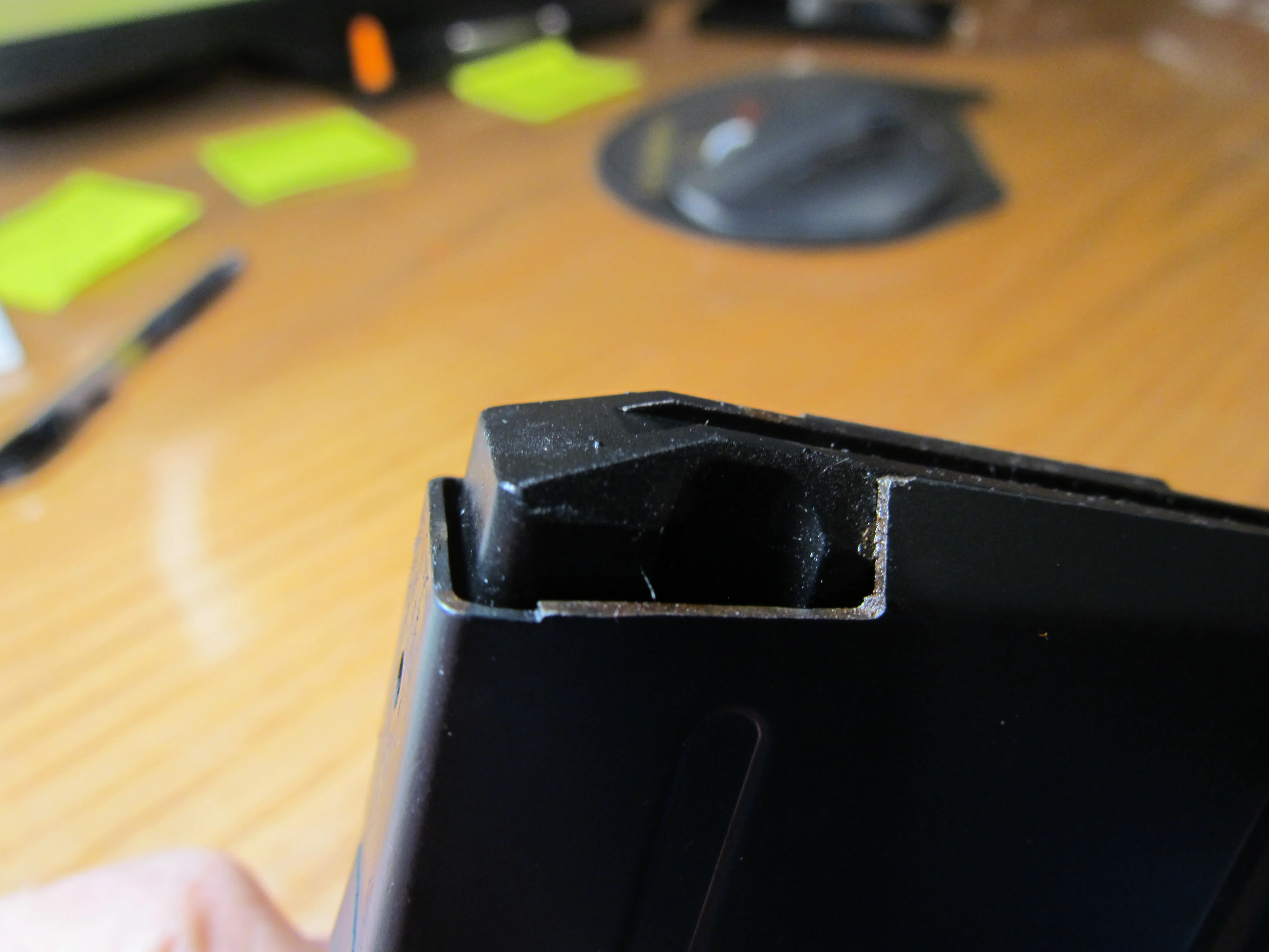

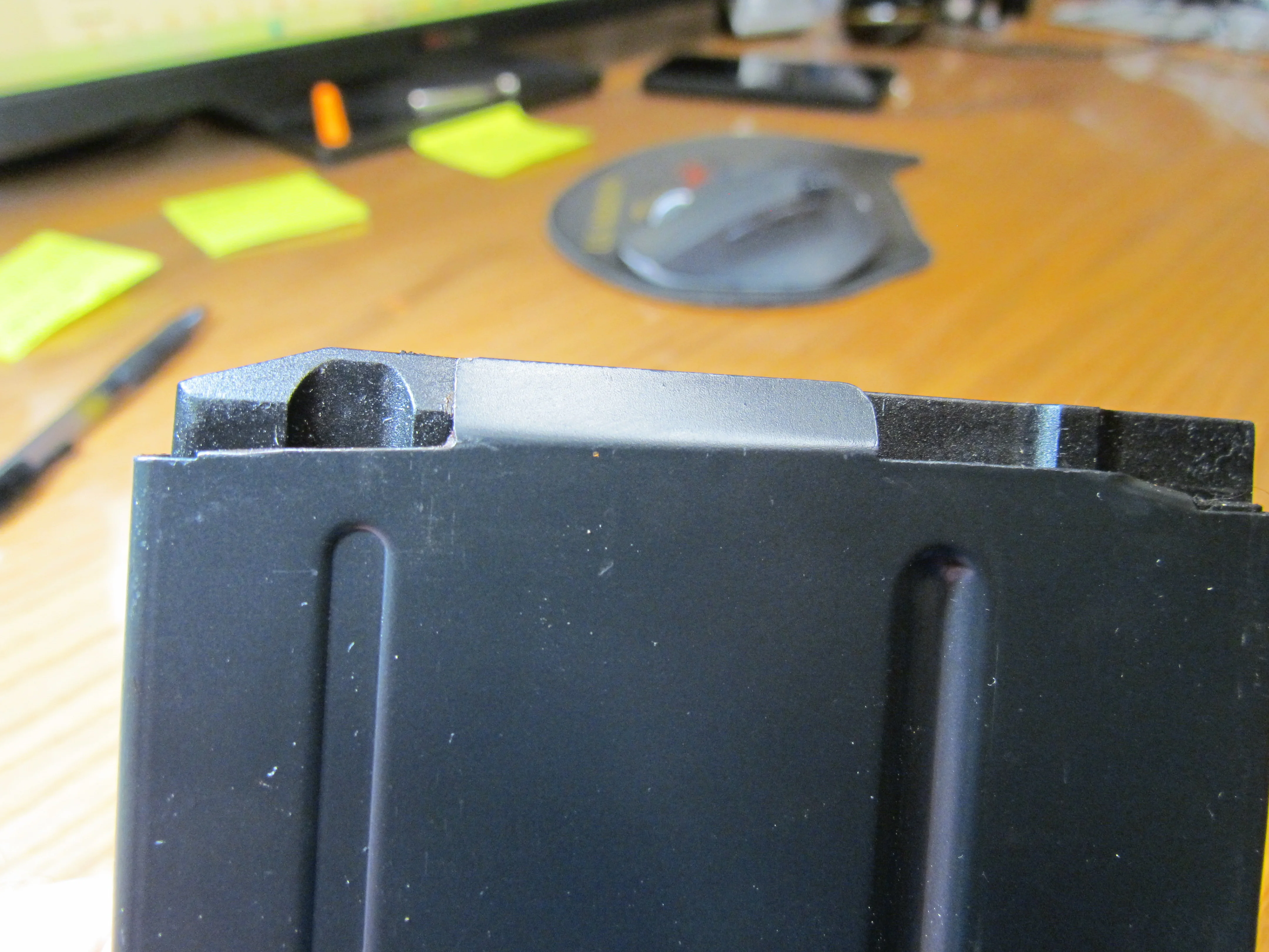

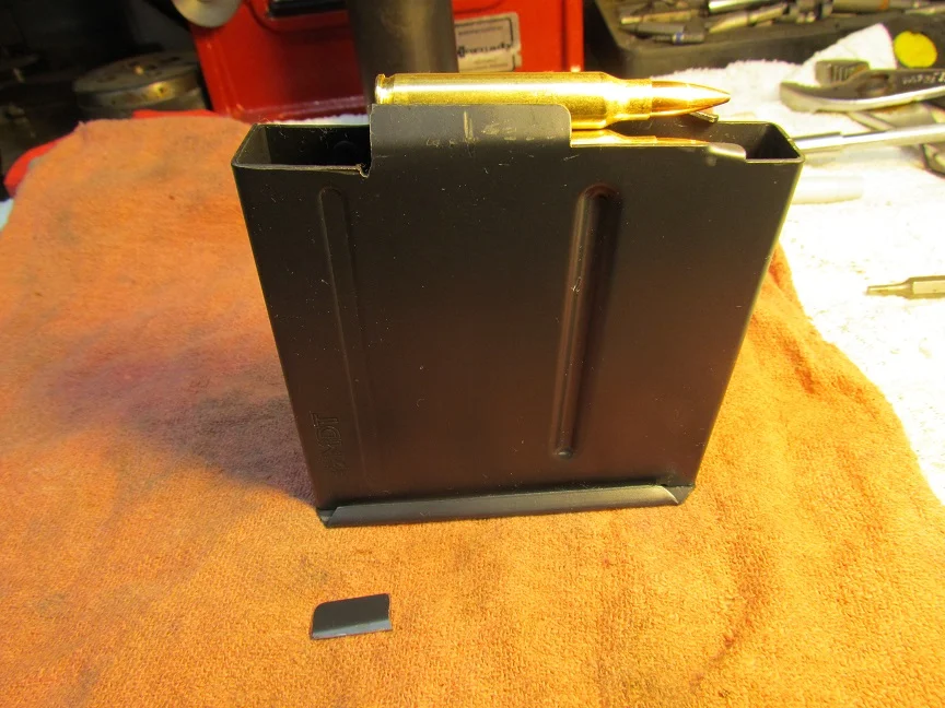

Rather than machine the receiver, on a couple of my stagger feeds in MDT chassis, I trimmed the aft of the mags to accommodate the receiver. Not for everyone, but it does the trick for this bubba. If I get ambitious one day, I will do it right. Until then I only single feed anyway and my solution got me into the new chassis in a hurry. Whatta Hobby!

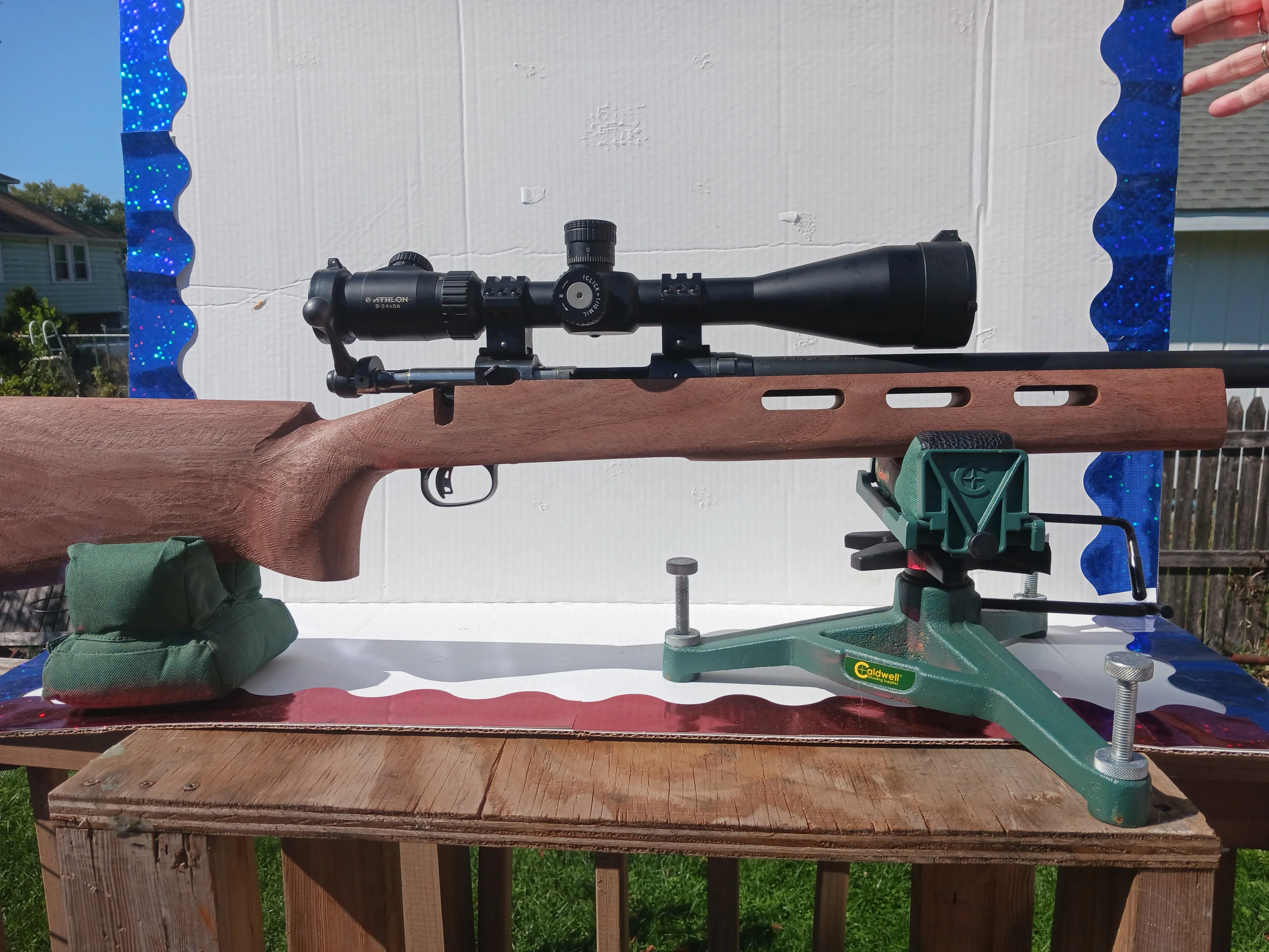

I have an old Model 10 Stager Feed, Blind magazine 223 and I absolutely love it. So much so I have a Richards Microfit Benchmark walnut stock I am building for it. Yes, it still has the 4 round box magazine attached to the receiver. Also, after checking, it will also perfectly feed 6ARC cartridges.

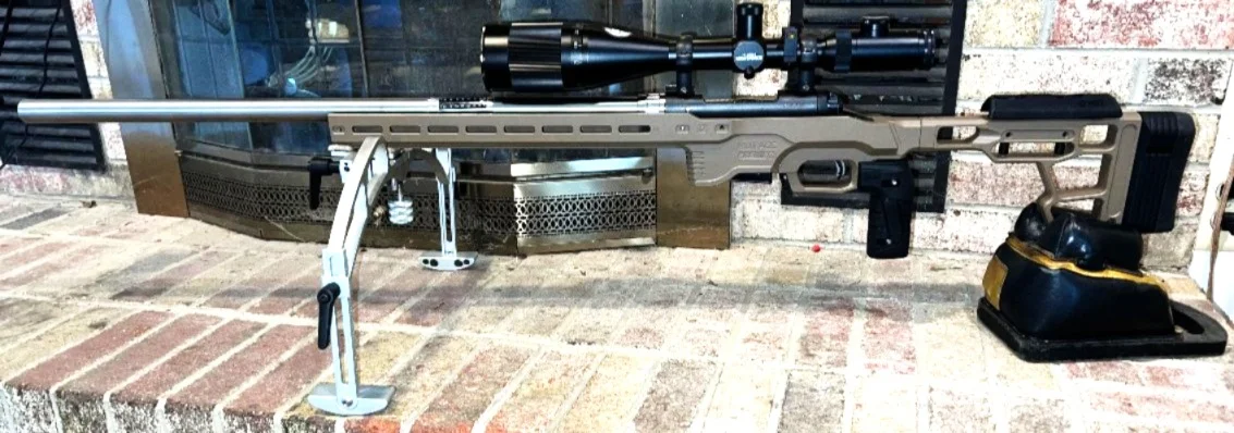

Personally, AICS style magazines don't bother me. I use them on all of my custom action rifles, and also use 10 round Dark Eagle magazines on my center feed Savage actions.

I see most Savage receivers as a base for a good shooter. Never considered Savages even close to a collectable, in my way of thinking, so hacking is acceptable. I didn't hack up my receivers to make them into single feed. I simply modified the mags to fit by nipping a little material off the aft section of the mag feed lips to pass by the receiver. Original rifle could be restored with very little effort and no damage to anything. Whatta Hobby!
