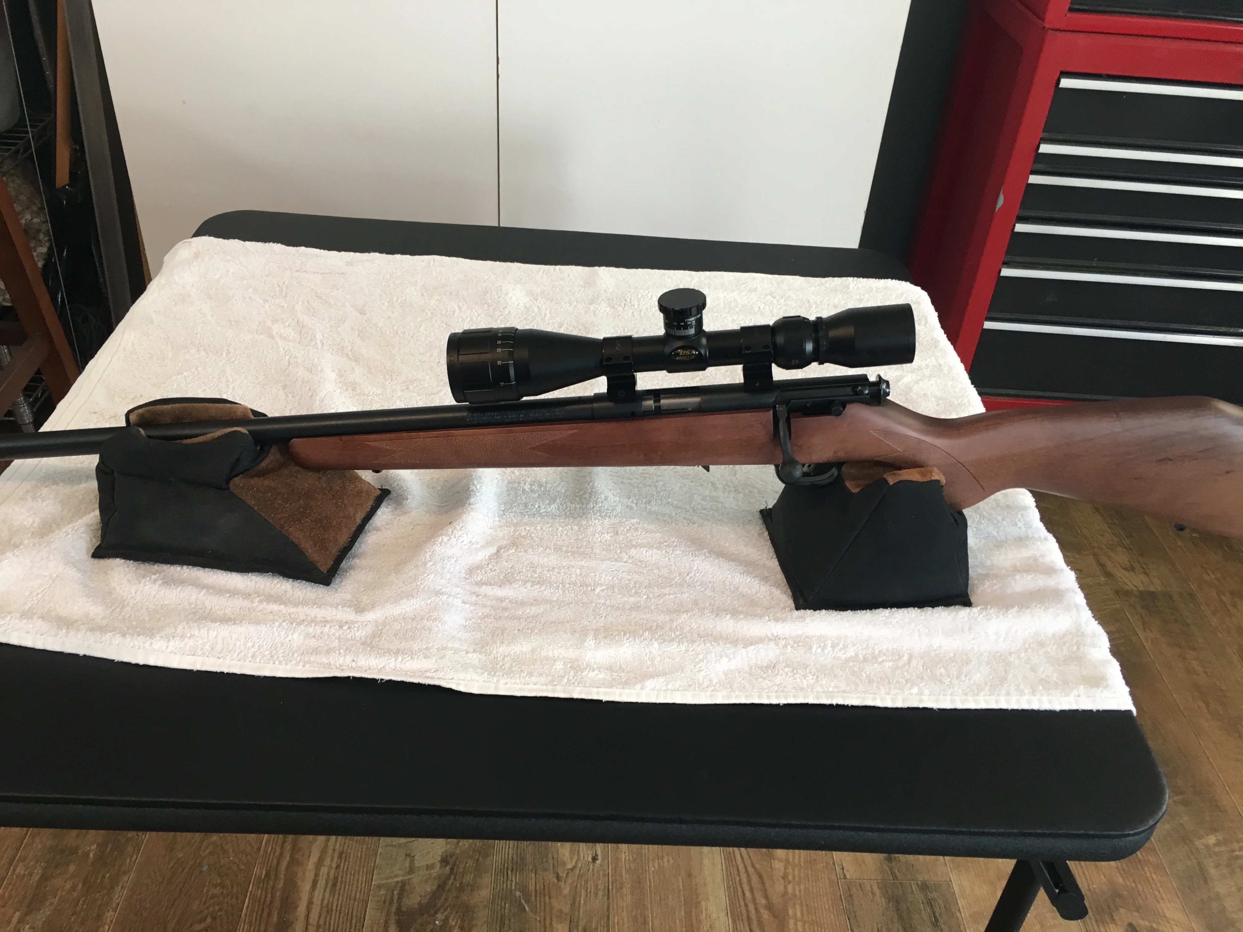

It would not be very easy to change the barrel on a Savage rimfire. No barrel nut and the barrel is pinned to the action. They generally shoot well, but usually need a bit of tinkering to smooth the action and feed from the mag. Mine is not quite as accurate as my 10/22 with a Kidd barrel.

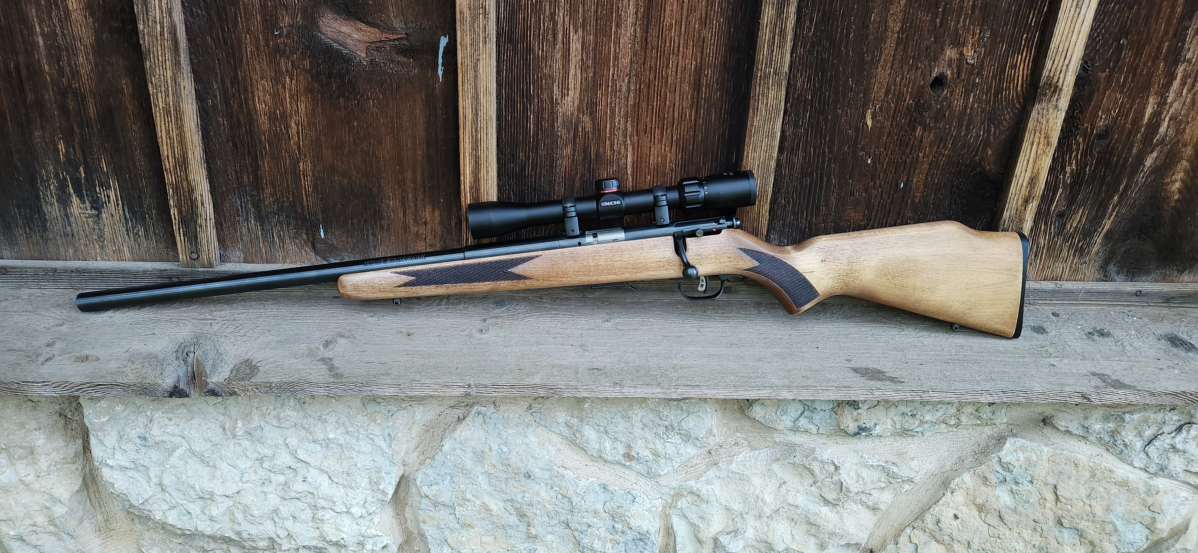

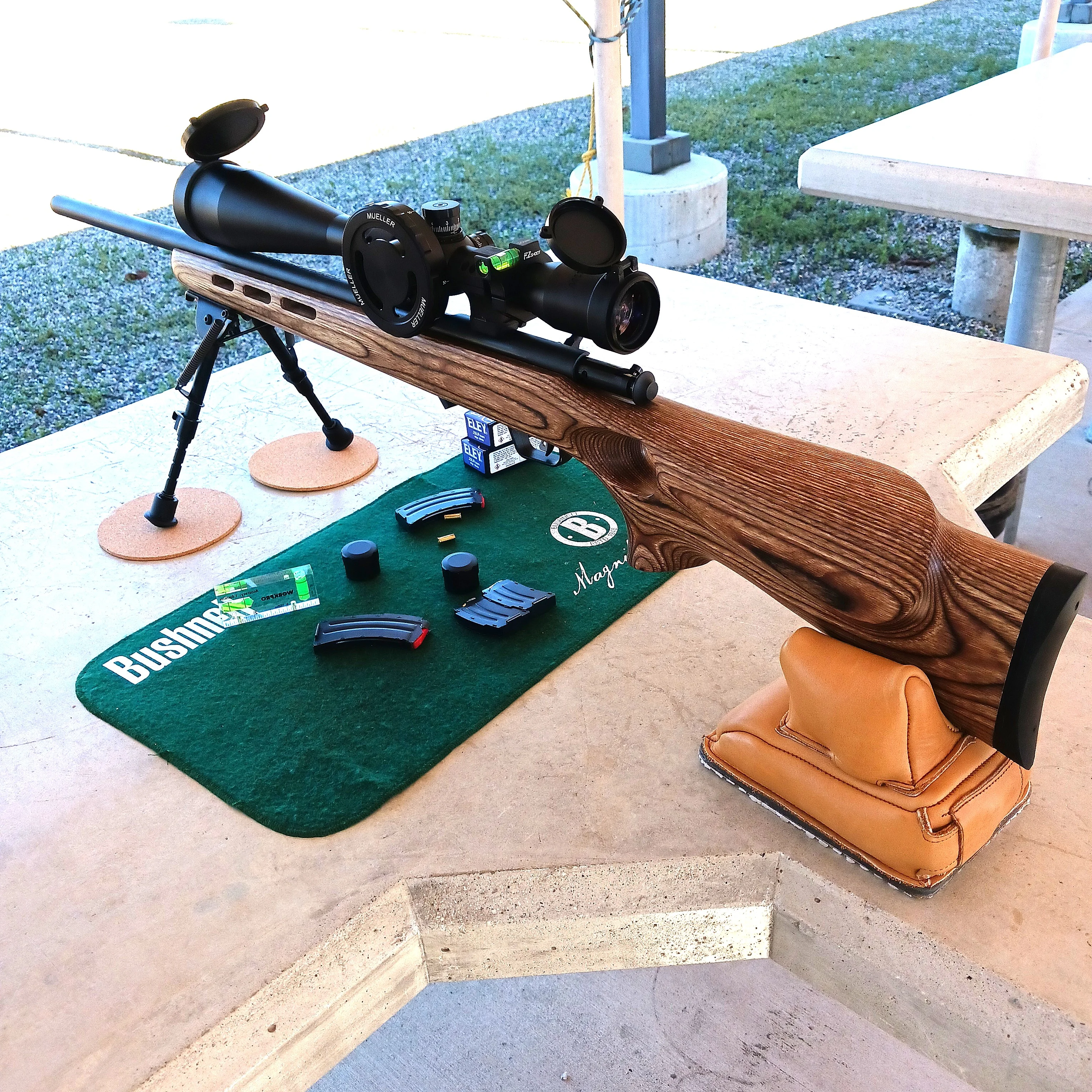

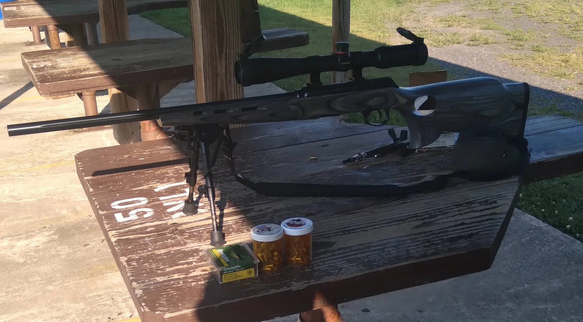

Savage barrels aren't threaded, they are pressed into the receiver, and pinned. I changed the barrel out on my Savage 93 GL 22 Magnum because I wanted a heavy barrel, and Savage doesn't offer it in LH. I bought a Green Mountain barrel for a Ruger 77/22 Magnum, and machined the tenon to the correct length and diameter, and installed it into the Savage action.
And it shoots Winchester 30gr ammo pretty dang good!

That's the best shooting 22 mag I've ever seen target pics of. I've owned half a dozen mags and none shoot under one MOA at 100 yards. 50 yards was where I could get under an inch group but barely. I gave up and went to the 17HMR. Never shot a CZ rimfire or realized they offered a 22 mag.
