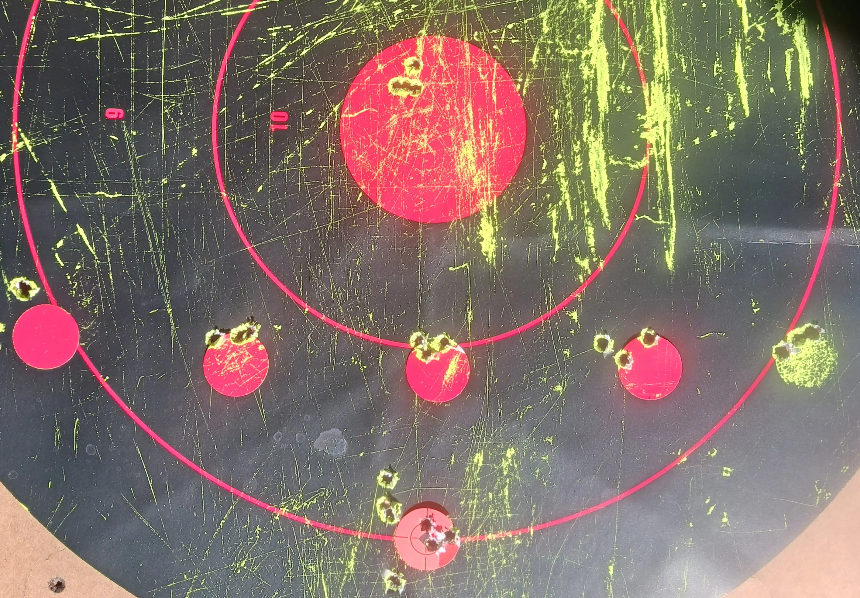

I have been competing with a 110 Action that was a 6ARC Switchback that has been rebarreled with a Shilen 28" Match Select 4 Groove barrel. With this I have been firing Berger 105gr Hybrid over LVR powder ignited by Remington primers. This configuration has been shooting excellent.
I have had a box of Berger 95gr VLD Target sitting on the bench for over a year. I finally decided to give them a serious try and not just a cursory try to see if they shoot.
Loaded up 10 and started with the same charge as I have been and then with 3 rounds .3gr lower and .3gr higher charge and also loaded to the recommended length Berger lists. Shot these at 100 yds just for effect. Results were slightly below what I was getting with the 105s. Figured, OK they will shoot well with a little work.
Then recently I was gifted about 7.5lbs of H335. Loved to receive it.
Back to the Berger load data I go. Hound the 95gr VLD listed along with data for the H335 powder. Time to get serious.
Start load was listed at 25.1gr with a max of 27.6gr. I started at 26.1gr and worked up to max in .3gr increments. This concluded with 5 loads. Also did a seating test to find length to lands. Which was so long there was very little bullet left in the case so I pushed it back .025".
Shots from L-R 26.1, 26.4, 26.7, 27.0, 27.3.. Each is 3 shots at 100yds, round robin. The center is 5 shots with the 105 Hybrid I have been shooting; bottom is the 105s, leftover bulled bullets
Lookin’ good👍 Nice shooting.🙂 Looks like though 95’s will hang pretty good against the 105’s.
Also seems to like this H335 powder. I have never used it before. Now to try it again to see if it can repeat.
Works good in several applications. Have good results with it in my 7BR shooting cast. Only thing I don't like is the very fine grain, despite my best efforts it seems to wind up in places I don't want it to.
Let me tell ya firsthand, A2460 is even a finer grain. It will actually bind up my trickler.
