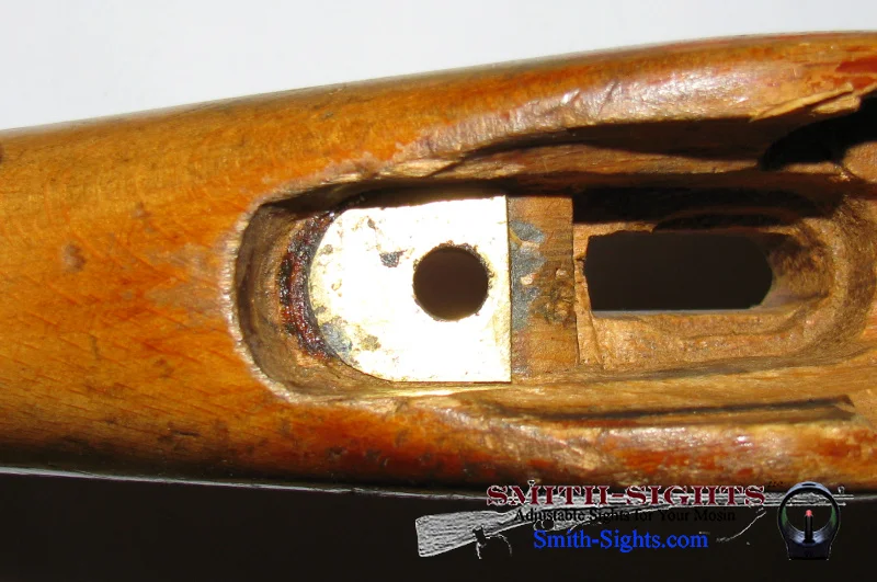

The first point of contact on the Mosin is the tang. Shim it. (Note: This stock has pillar bedding installed, but the shims are used with the pillar bedding and the principle remains the same without pillars in place.)

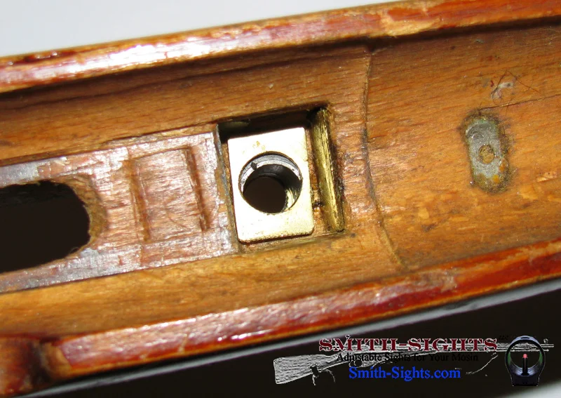

The second point of receiver contact on the Mosin is where the front screw goes through the recoil lug. Shim it.

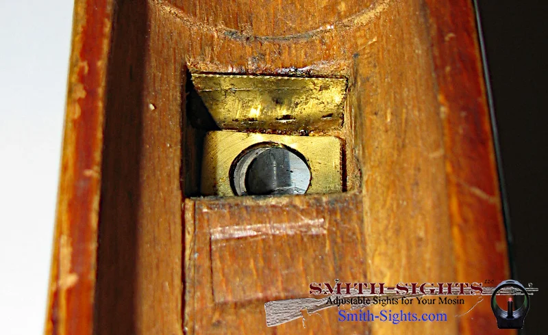

The third point of contact is the recoil lug cross bolt. You should position a vertical shim on the front face of the recoil lug recess to ensure tight contact between the recoil lug and recoil lug cross bolt.

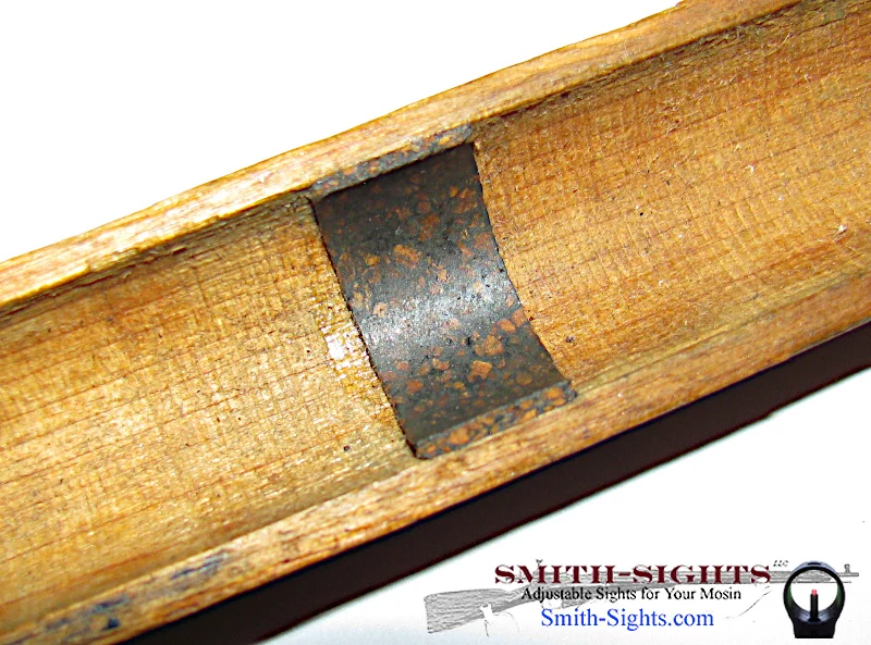

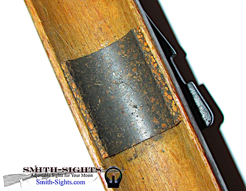

The third point of contact on a Mosin is at the front barrel band. The bottom pressure pad, located at the front barrel band, ensures a single point of barrel contact. Random pressure points along the barrel shift the point-of-impact as the barrel heats, and it's critical we control this.

The top pressure pad sets directly above the bottom pressure pad and further centers the barrel, preventing the random pressure points and helping to balance the pressure applied by the bottom pad.
