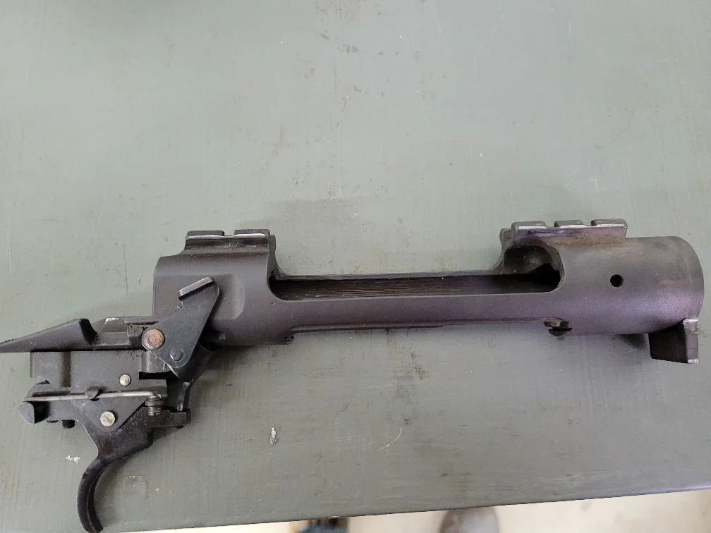

Not often seen, many Savage fans never haven even heard of these. But Savage did try their hand in Casting some 110 Actions, in the ‘88-‘89 years, coming out of their bankruptcy. They first tried casting them with Integral scope bases & recoil lug, but after problems, the receivers were cast without the scope bases, Savage choosing to braze them on after casting. Some of you out there may have one of these. All Cast Actions received an “F”-marked serial number.
The Actions experienced significant warping problems, and I doubt anyone would feel to safe running any high pressure or Magnum cartridge through them. However, they are an interesting piece of Savage Arms’ history.

Most of those actions don't even make good hunting rifles. The actions would twist during heat treating, and the scope bases would make it almost impossible to zero a scope with a 1" tube. You would run out of adjustment.
Everyone that I've ever seen were setting in a used gun rack at a store. If you put a straight edge on the scope bases, the scope bases wouldn't come close to lining up with the barrel.
Yeah, I’ve seen nothing but bad with them. Another harebrained Savage idea!😂 At least they were short lived. Still, I wouldn’t mind having one just as a wall hanger. I’m no collector, but I love my Savage 110s!
Interesting information. It's weird that there's a caution about using high pressure loads with the cast action, Ruger has been investment casting actions for decades without pressure issues.

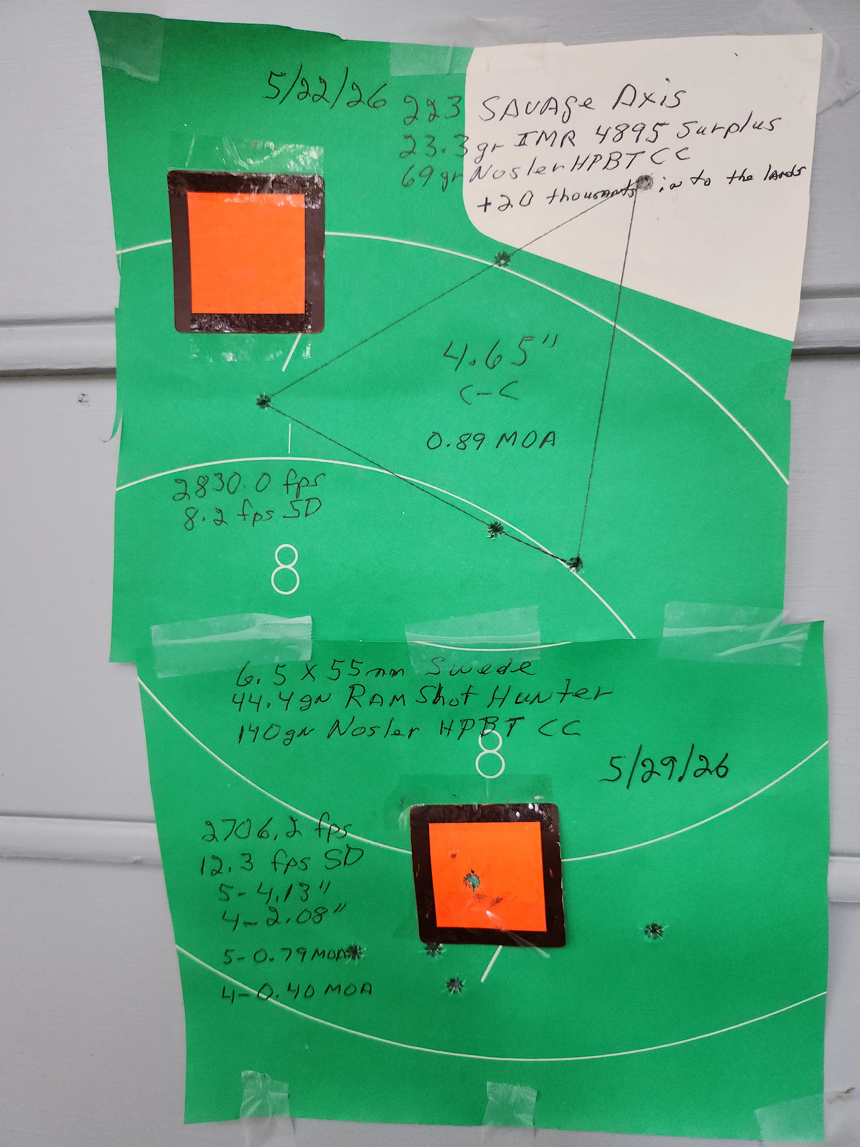

Maybe I have been lucky, but this is my investment cast action at 500 yards. See bottom group. Shooting a McGowan barrel.
Yes, yours seems to be a diamond in the rough! Hey, even a broken clock is right TWICE a day! 😊
So yeah… there are sure to be some decent shooters with the Cast Receivers. And yours is proof!👍
