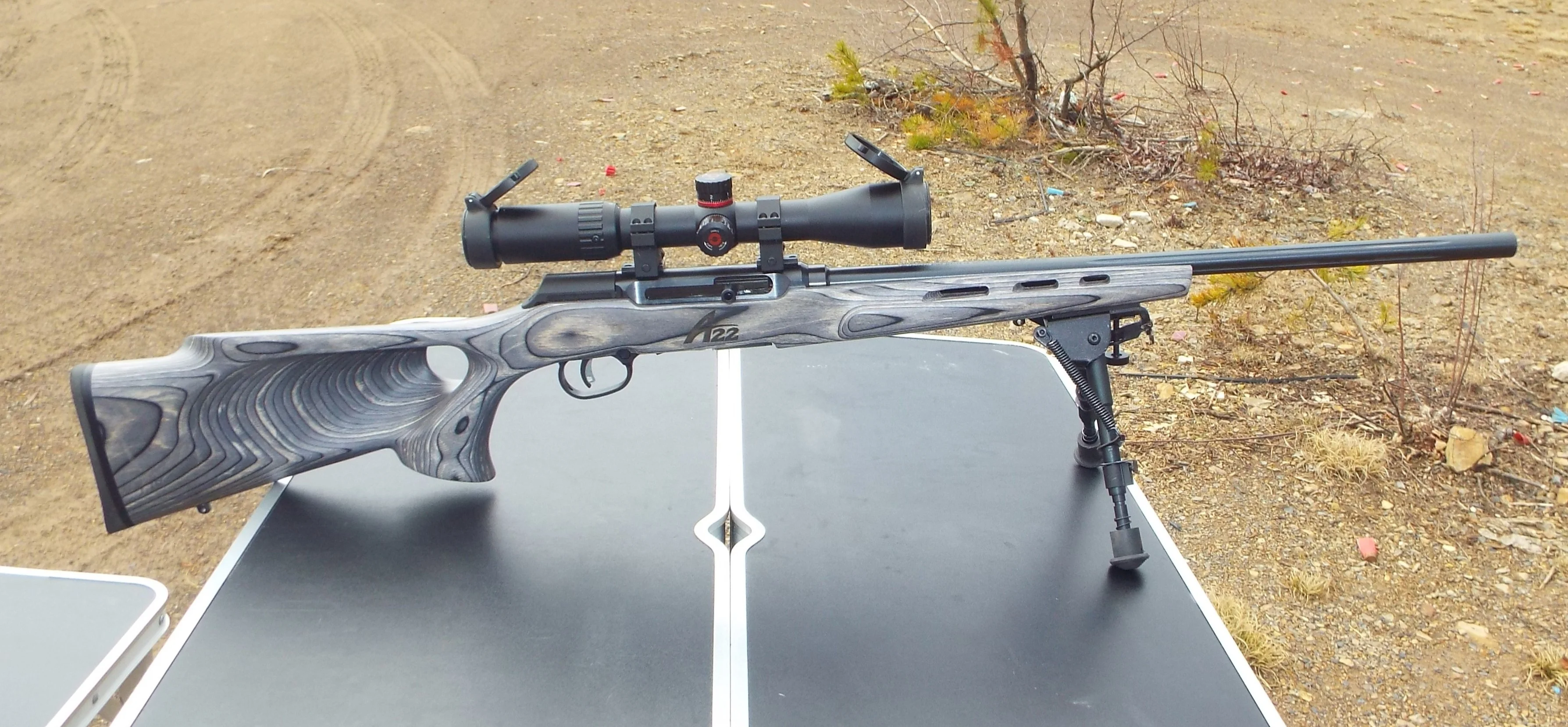

Here is my Savage 22lr target rifle. It's an A22 target.
