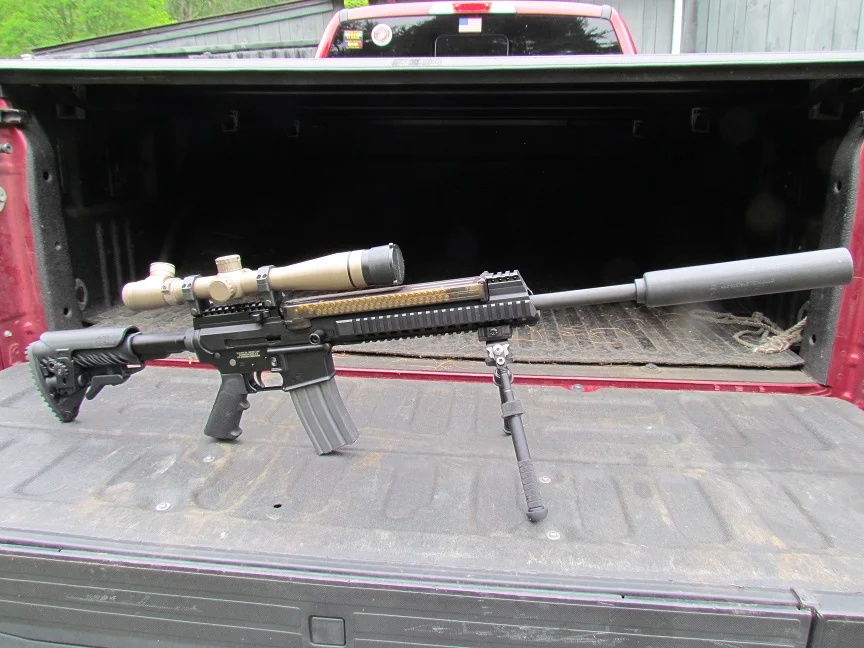

For an AR, I would pick the Wylde every day of the week, especially if I was going to focus on bullets that normally fit in the AR Mag length. I just don't like trying to cram a long bullet back into the brass just to fit into an AR Mag.
I have shot 80 gr bullets in my AR, but had to single feed them to keep from trying to fit within a mag limit of 2.273 inches OAL.

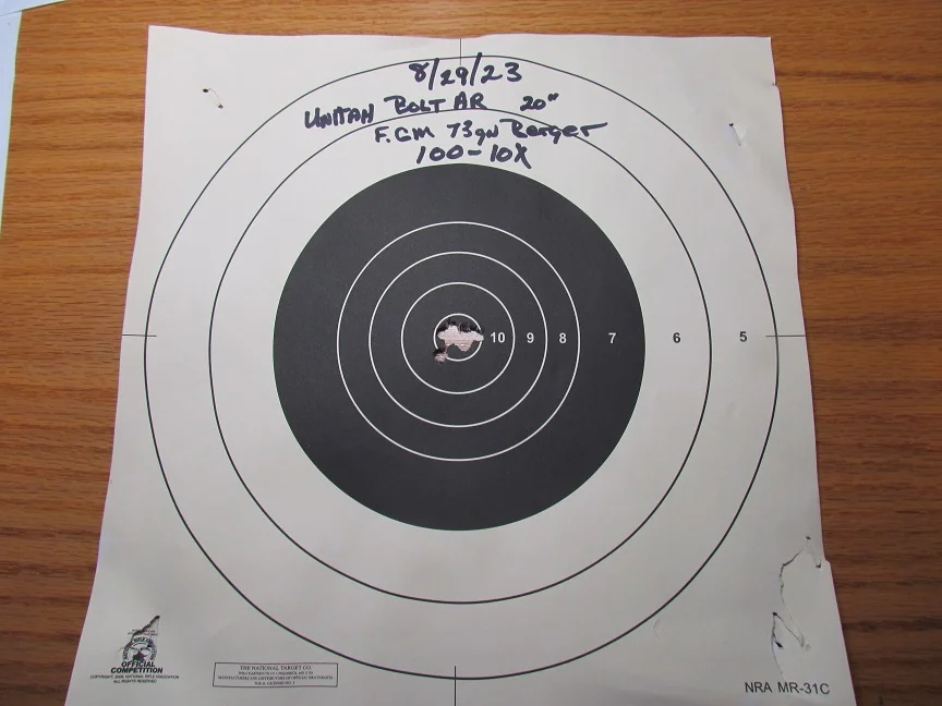

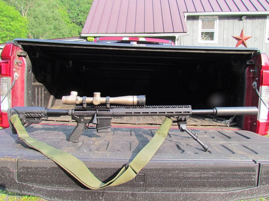

My latest .223 target rifle, at 1:7 twist, has a .223 Remington with a VLD chamber (with 0.090 free bore) that is made for really long bullets in the 80 to 90 gr range.
I tend to load my 90s out past 2.620 so I have to single feed them.
The VLD chamber barrel shoots pretty much everything great, but for lighter bullets in the 69 gr to 75 gr range, I monitor bullet base in neck and do not try to focus on minimizing jump.
With that much free bore, the light bullets easily get too little bullet shank in the neck when you try to minimize jump to the lands.
With bullets less than 80 grs, I try to keep bullet shank in neck at 1/2 caliber (0.112) and never let it get shorter than 0.070) because the accuracy drops off, especially when the brass has more than 10 reloads.

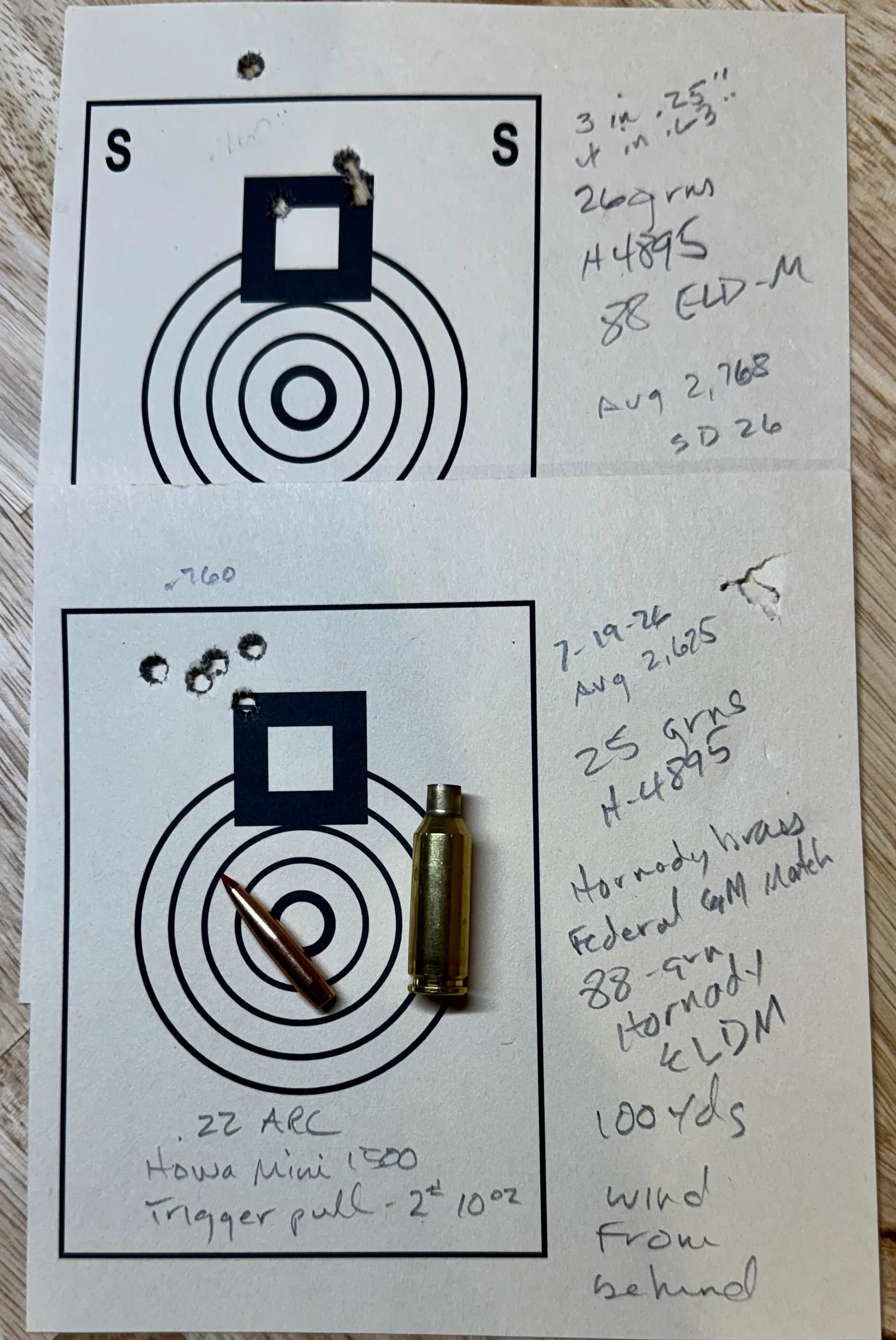

CF: I should probably work with this little Howa .22 ARC with 88-grain Hornadys. It has a 1:7 barrel, but of course it is factory.
I suggest you measure the chamber, but you should be able to hunt the lands with all bullets heavier than 80 grs with a factory chamber. A 1:7 twist should be able to perform well with up to 90 gr bullets, but you might have to seat some of them back a bit to deal with a factory chamber.
I've had the best results with the Berger 85.5 gr LRHTs and Berger 80 gr VLDs.
The 90 Berger VLDs and 90 SMKs aren't far behind them.

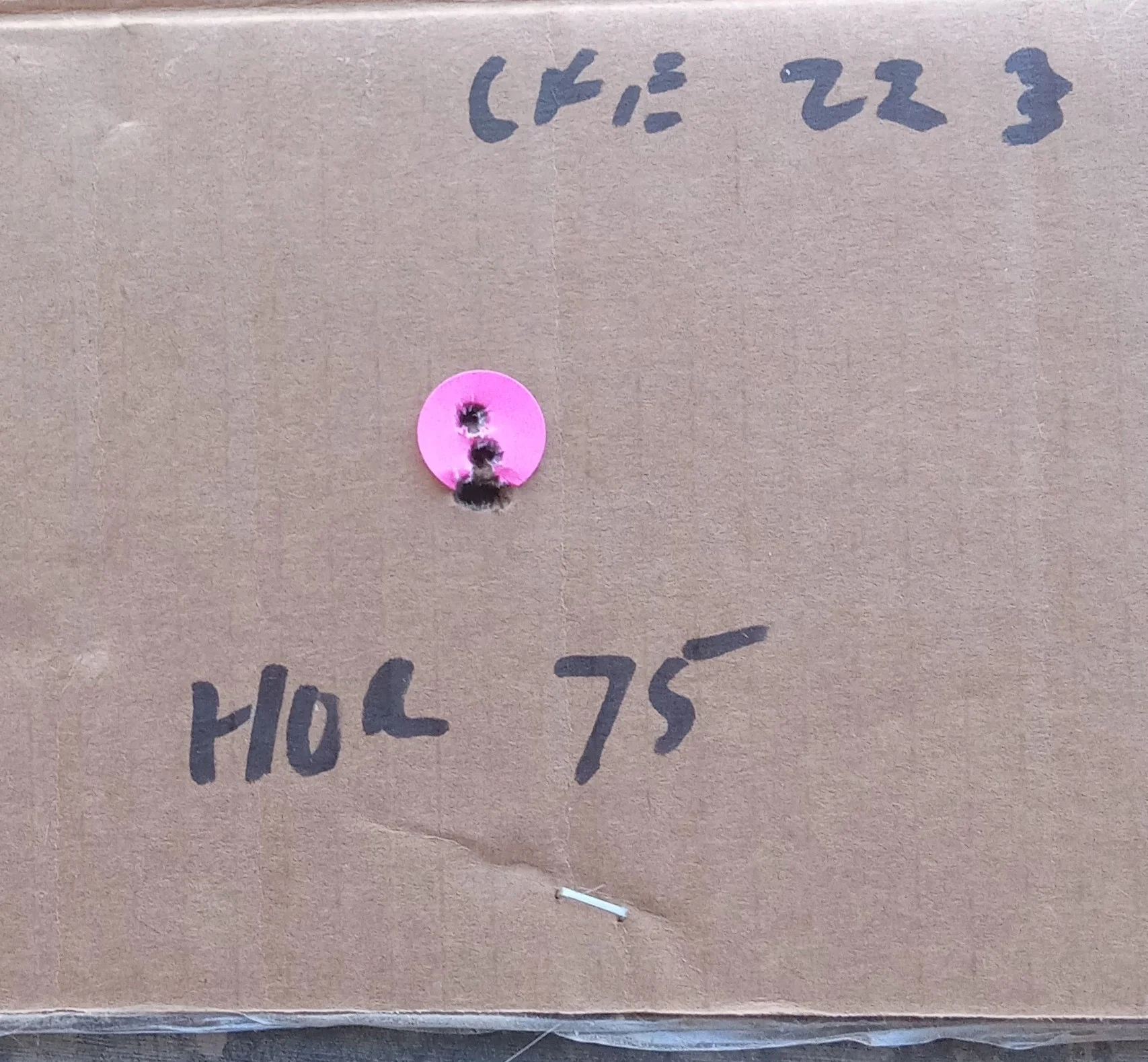

CoalCracker,
To me, it looks familiarly like one or two got away.
My rifles that had stocks too short for me, used to do that. The first two or three kept together and then the last two moved high and higher.
Turns out that I discovered that the short stocks allowed me to move forward closer to the eyepiece with each recoil, even with a light recoiling .223, so for the later shots in the group, the bullets move up because my aim point was not where I thought it was.
Adjustable stocks that fit me better and removed the sneaking up on recoil solved that problem.
I still have issues with shooter induced variations when I lose concentration, but at least I don't sneak up on the eyepiece because of recoil.

CF, I tried H4895 under some Hornady 88-grain ELD-Ms on Sunday in the .22 ARC and got very promising results -- but I am also trying to relearn how to shoot from a bench the way I was taught years ago by an Army marksman. You fellas here chasing perfection and measuring groups with a micrometer will laugh at my groups, but for me they represent progress. This is a Howa Mini 1500, plastic stock, 2-pound 10-ounce trigger and 22-inch sporter barrel. I called the high shot in the upper target. The first rifle I shot on Sunday was a Savage 110 Trailblazer in .450 Bushmaster, and my load was 11 grains of unique under a powder coated Accurate 45-490K weighing 296 grains and loafing along at 1,215. The Savage factory trigger is fully a pound lighter than the Howa and I really noticed the difference.
I am about out of H 4895 and will go to Varget next, although I have LeveRevolution and CFE 223 on hand. Like Unique, Varget is a powder I have come to trust for many years.

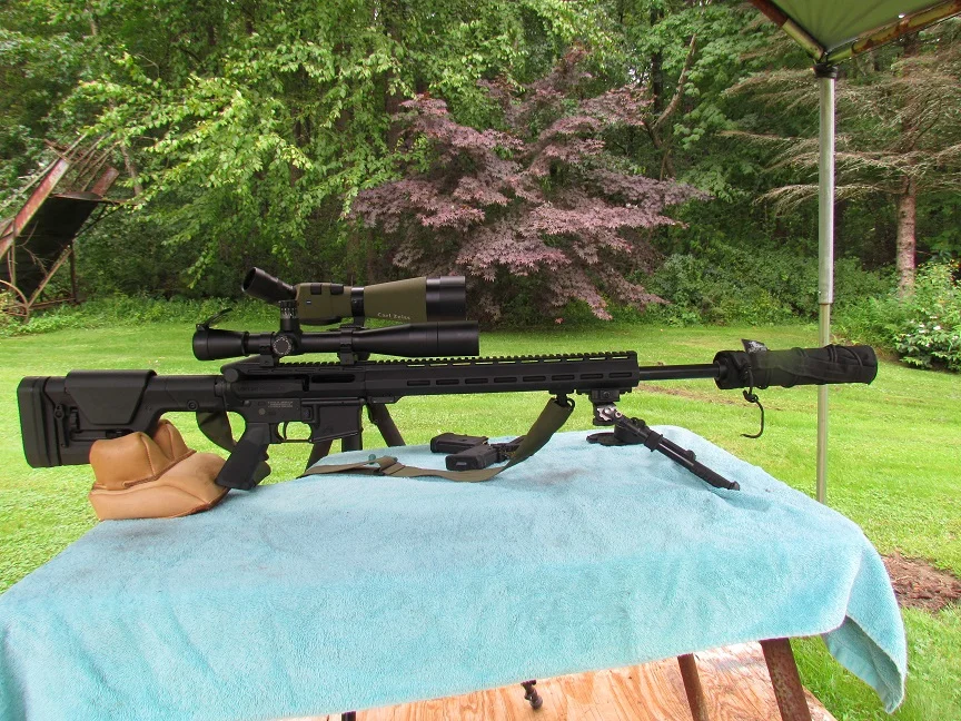

I will work on applying your welcome advice, CF. I admit to struggling a bit with the scope on this a rifle -- an SWFA 12X42. Might need new glasses, too.
Driving the rifle is fully 50% if not more where groups are concerned. You should concentrate on keeping the front and rear rests in the same place along the stock as well as how tightly to the shoulder along with how tightly you grip it. Set it up on a table and dry fire a few hundred times taking note as to whether anything moved during the process. I have found that even with all that, alo g with after carefully load work up, just getting tired after 15 or 20 shots people tend to get sloppy on the fundamentals. That includes myself. Ive learned to take my time at the bench. Now after 10 rounds, I'll sit back and scroll through my phone for a few minutes letting the barrel cool a bit and my muscles to relax. It has made a difference.
Also, if using a bipod,
load the legs with a bit of pressure by leaning into the stock.
