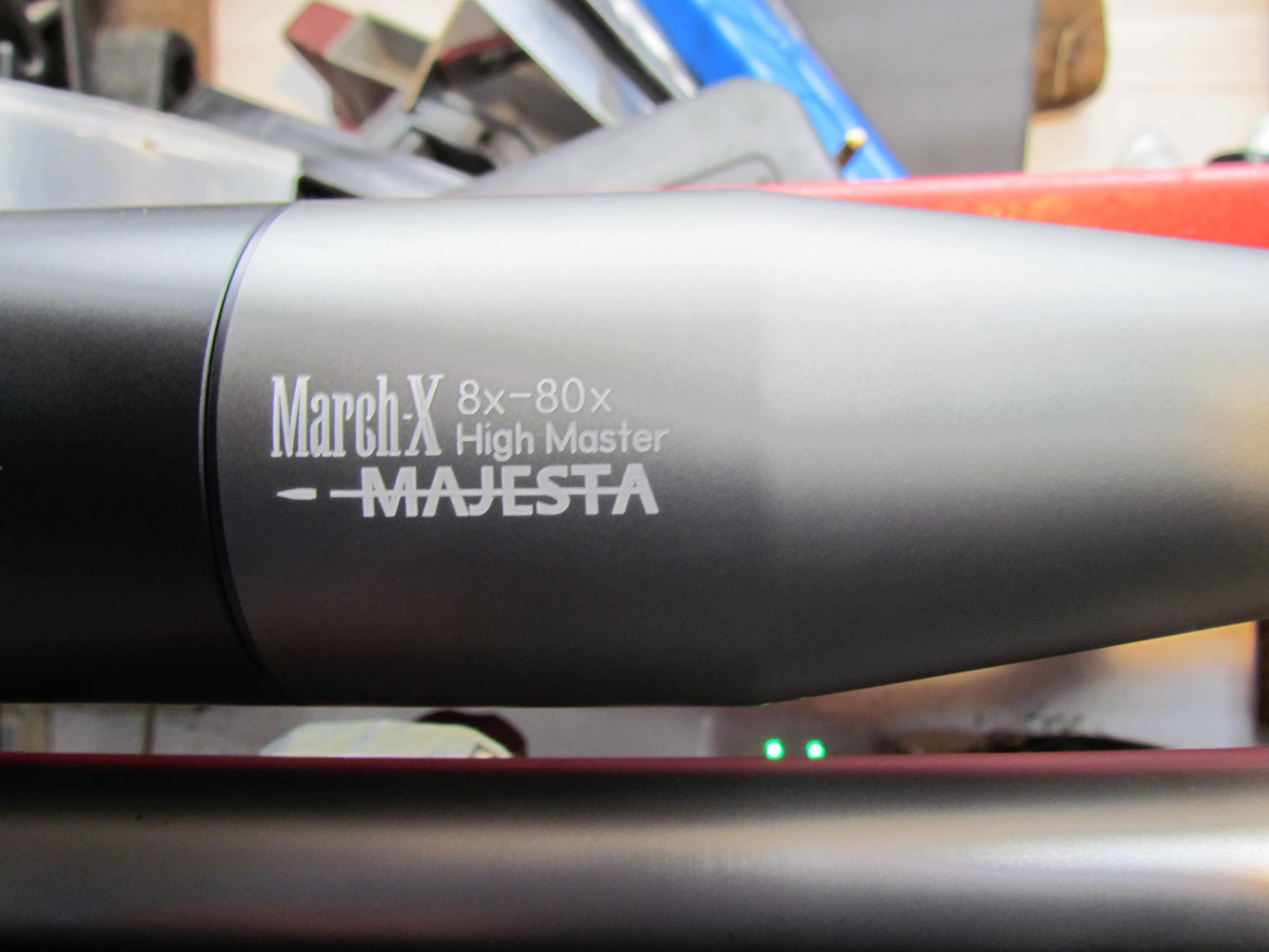

Very nice. Can't have too much power on optics. I use 50 and 80 power scopes from 50 yds on out. Most of my shooting is between 50 and 150. Whatta Hobby!
50x & 80X magnification at just 50yds?? What’s the field of view? About 2”?? 😂
How is that not just a blurry mess? I’ve never heard of that… EVER!
Learn something new every day and you might have knowledge by the time you croak. Many good quality benchrest scopes can focus down to 25 yds. When you are trying to see a 1/16 moa nor smaller aimpoint it is pretty important. Whatta Hobby!
I've always used high magnification scopes that are 36 power at 50 yards, even with rimfires.
NF1E is right, that is one of the reasons to use high-quality scopes, some of which can focus closer than 25 yards.
