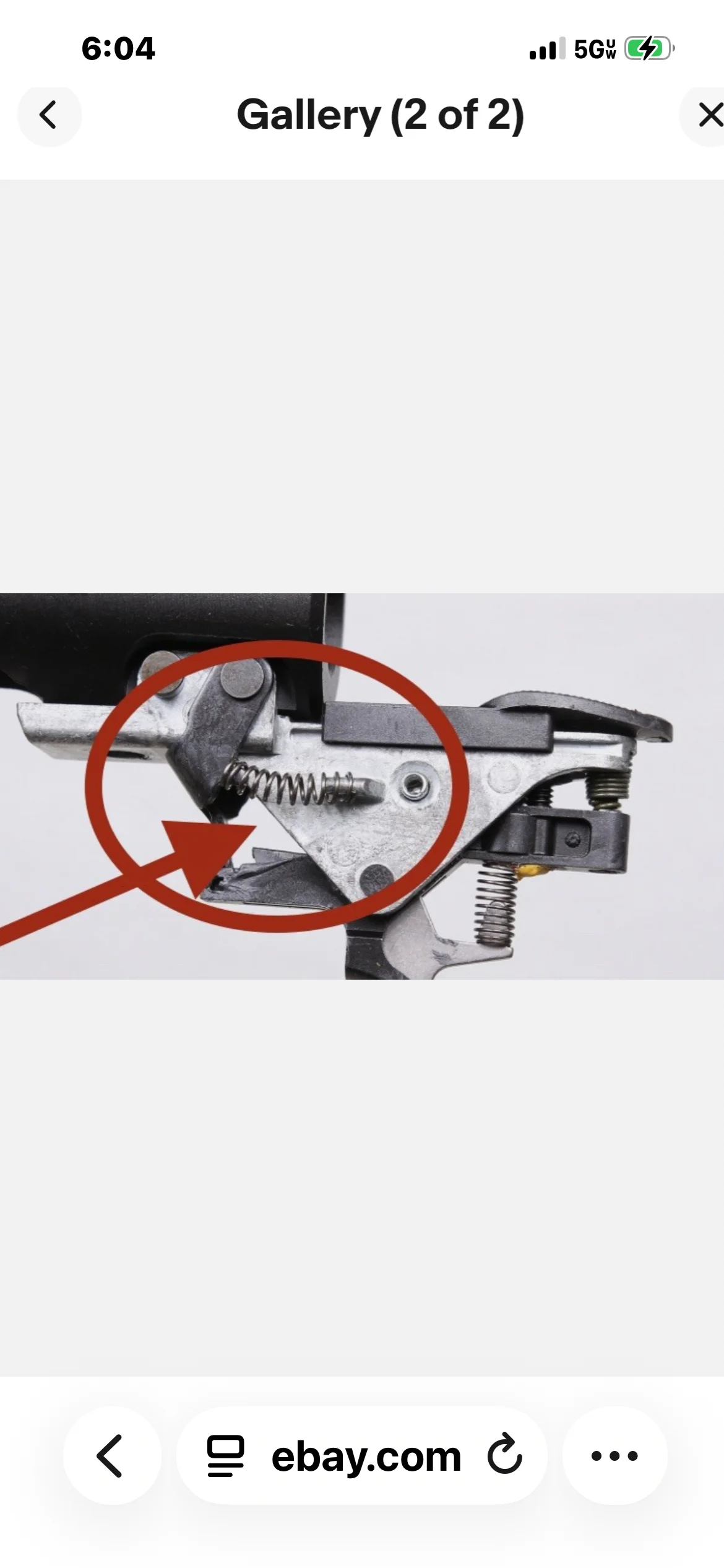

This one. It is gone
Ahhh, gotchya. I apologize. I wasn’t thinking “Axis”. But yeah, that spring gone, it makes sense. Don’t know why Savage in all their wisdom, designed it that way. Instead of how the 110 Bolt Release/Sear Spring is. But yeah, like CoalCracker is pointing out, that’s an easy spring to duplicate.
